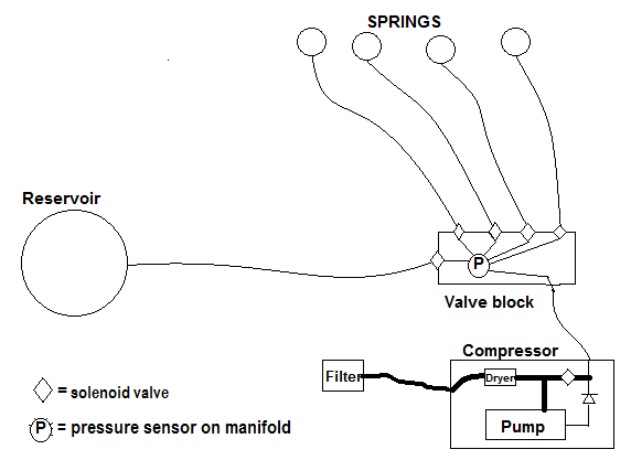

I would guess you either have a failed valve on the valve block or the control module has been compromised. Although if the latter, it more likely would not work at all.

yeah, you can’t raise the vehicle over 30 so that is normal. But if the right rear isn’t coming off when it does race under 30 if then you may have a failed level sensor there, or a clogged orifice in the valve body to that wheel.
it isn’t the compressor that raises the vehicle. That is done by stored air pressure in the central Reservoir, which is being redirected by the valve block to each individual wheel that needs it. All the compressor does is replenish the central, Reservoir through a connection in the valve block when commanded to do so.
Eric now is the time for your awesome diagram.

(bows humbly)
The valves on the valve block are electrically activated. If you raise three corners but not the fourth, in all likelihood either that valve, or the control module, has failed.
If you have a bidirectional scan tool, such as Autel MP808 or MB STAR you issue a command to read the individual component pressures; the system does this by actuating one of the valves, which you hear as a click.

point of order, the line from the filter to the compressor is more of a gentle arc, following the curvature of the wheel well.
Hahaha that's what I love about doing things in Paint. The crudity invokes a sort of Art Brut paradoxical elegance.
