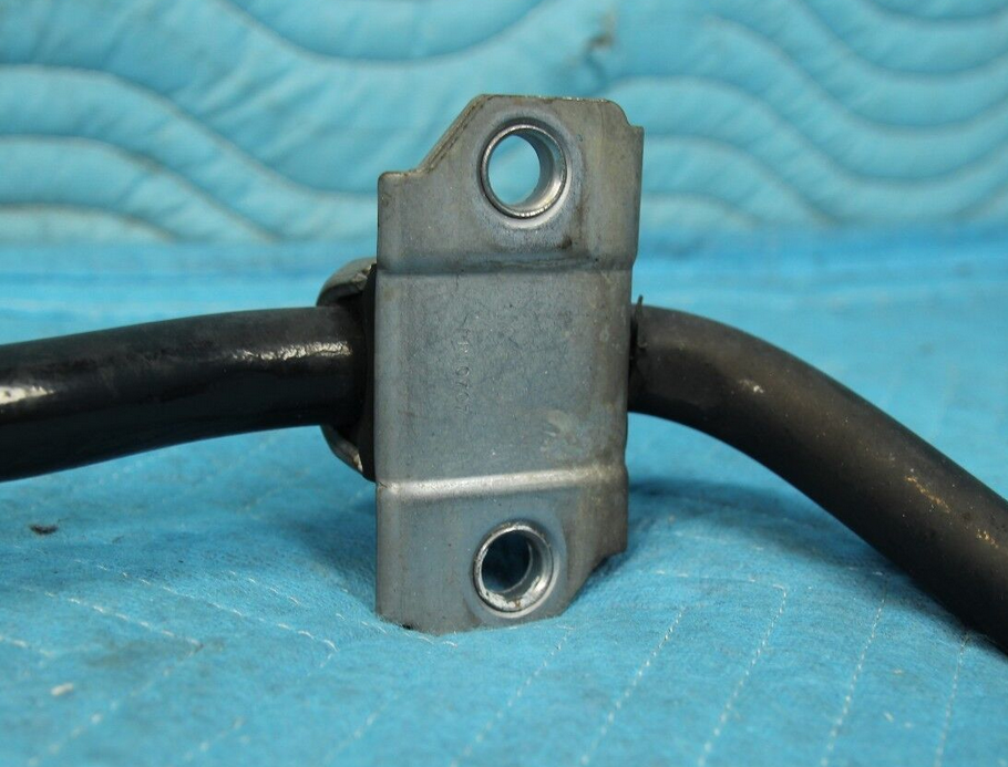

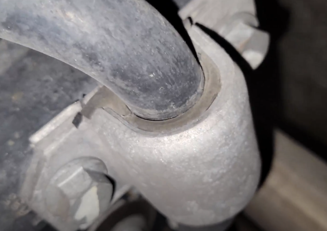

I am getting a clunk/squeek from the driver rear and during my investigation, I believe it's coming from the rear sway bar bushing. The driver side one looks more brittle and has more gaps than the passenger side one.
I can't seem to find a replacement for the bushing itself. Is it not possible to replace it...does the entire sway bar need replaced?
Where can I find the bushing if it can be replaced?
Attached is an example of what I'm referring to. The darker photo is my actual bushing.

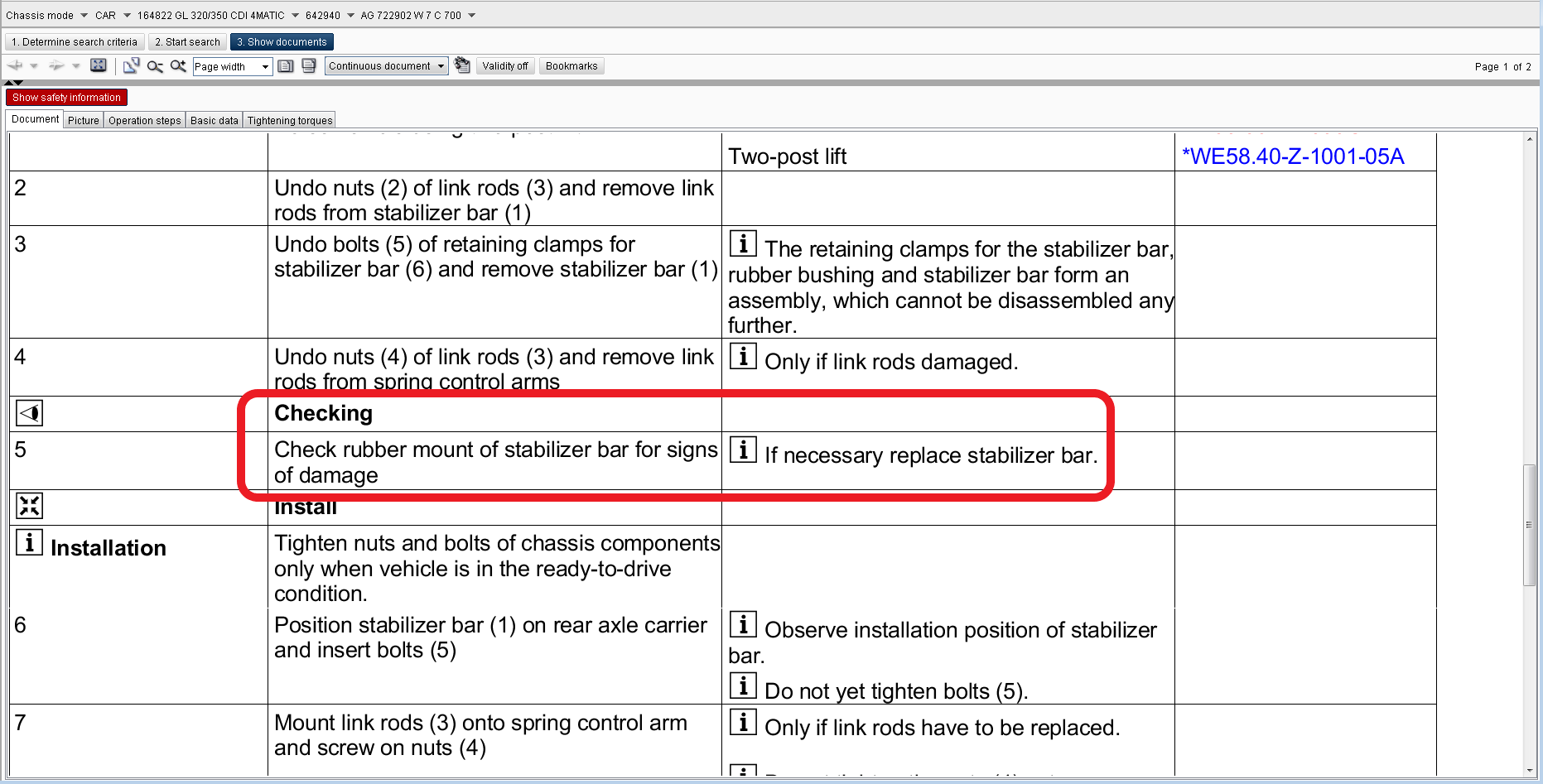

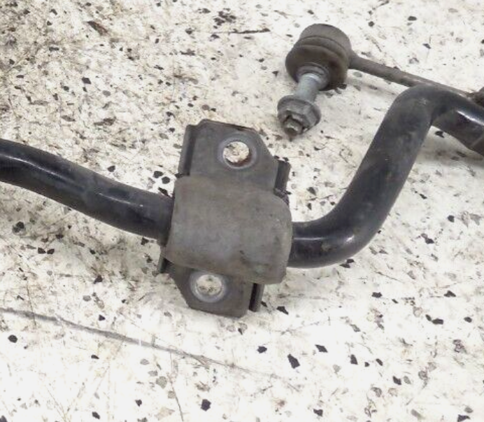

It doesn't look like they are meant to be replaceable, so probably not available.
Attached are for my 08 gl320.
Yea, currently looking to replace the bar if the recommendation for spraying them doesn't help above. When I was doing my test last night, it just seemed like you could see the bar move inside the bushing a bit.

Attached are 3 photos. 2 are of the passenger rear bushings (outer view, inner view) which their condition looks good. The other is the driver rear (similar to the original photo in my post) but shows a more worn down condition.
Driver Rear Bushing
Passenger Rear Bushing
Passenger Rear bushing

Funny, they want to charge you $400 when what you need to replace is a fifty cent piece of rubber.
I seriously doubt you would notice any handling difference if you replaced those with new. Even if the one is good and shredded.
If you want to test how worn they are, put a pry bar between the bar and the rear sub-frame, between the two bushings. See how easily the bushing compresses, and whether it compresses more on one side versus the other when the same force is applied.
You might also look into whether anyone makes performance oriented rear bushings. The vehicle would oversteer a little more, but if you aren't racing you probably would not notice the difference.
It is curious that the bar gripped the rubber hard enough to tear it. Now, if they had been assembled with silicone grease in the first place, this never would have happened.

2008 gl320
It looks to me like the two pieces are swaged together. So they'll need to be drilled or ground out to separate.

Get under there with a stethoscope. The clunk could be the swaybar shifting within the rotted bushing and impacting the bracket. This should only happen when the vehicle is rocking, such as when your helper pushes on the roof rails.
In my opinion you are devoting too much energy to diagnosis when the part is just $35 and can be replaced without a huge amount of labor.
What's all that orange goo dripping down the shock?
Most people just install Bilstein shocks. Are those Arnott shocks made by Bilstein?
