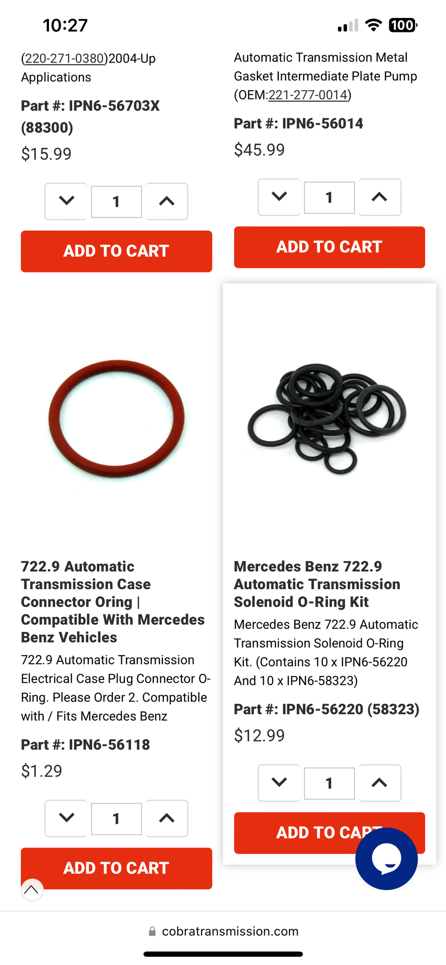

Hey Max,
I found this after I bought O-rings somewhere else, but Cobra Transmission sells them in packages - check this out:
https://cobratransmission.com/722.9-Solenoid-Oring-Kit
https://cobratransmission.com/722.9-...onnector-Oring

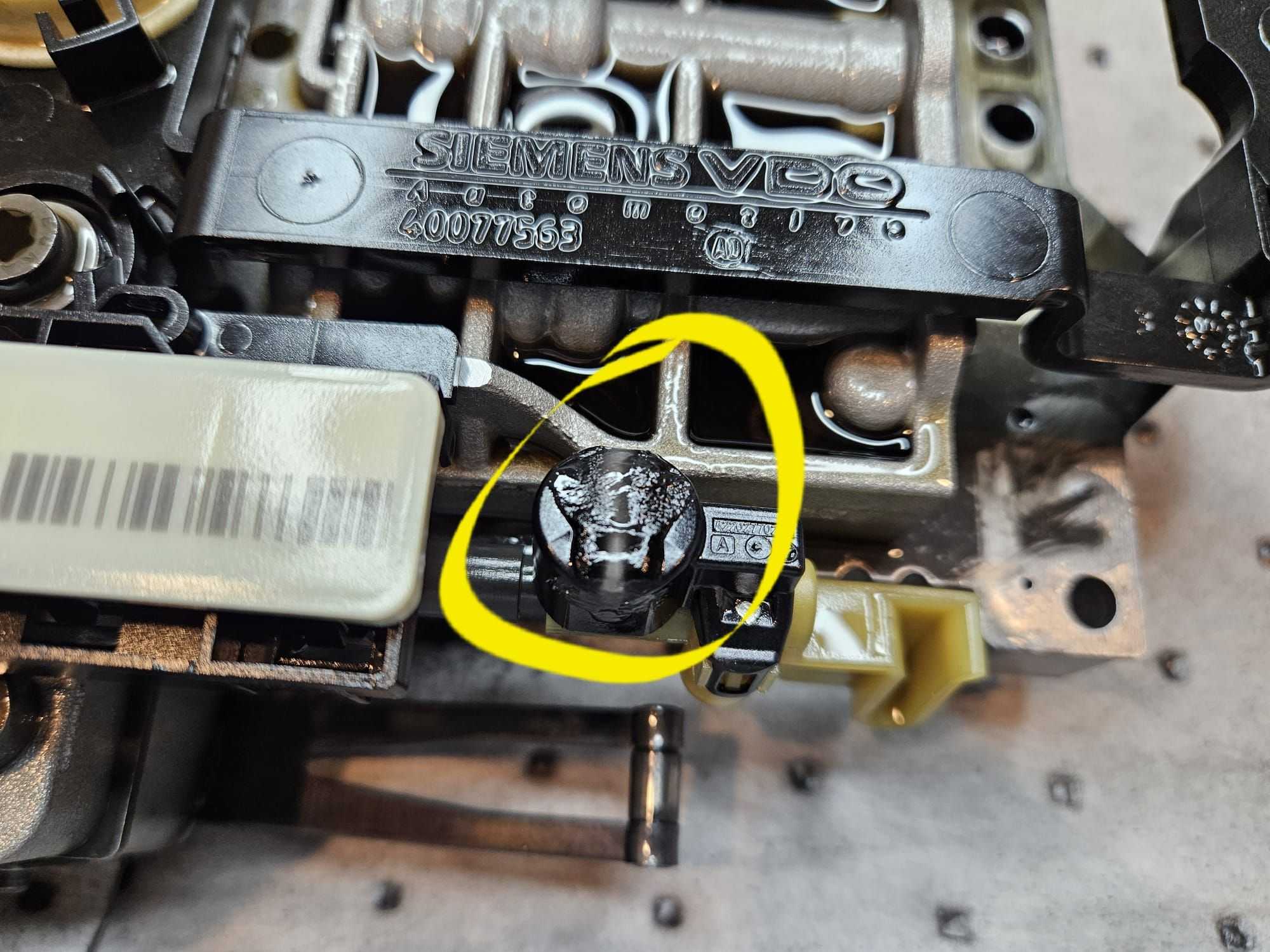

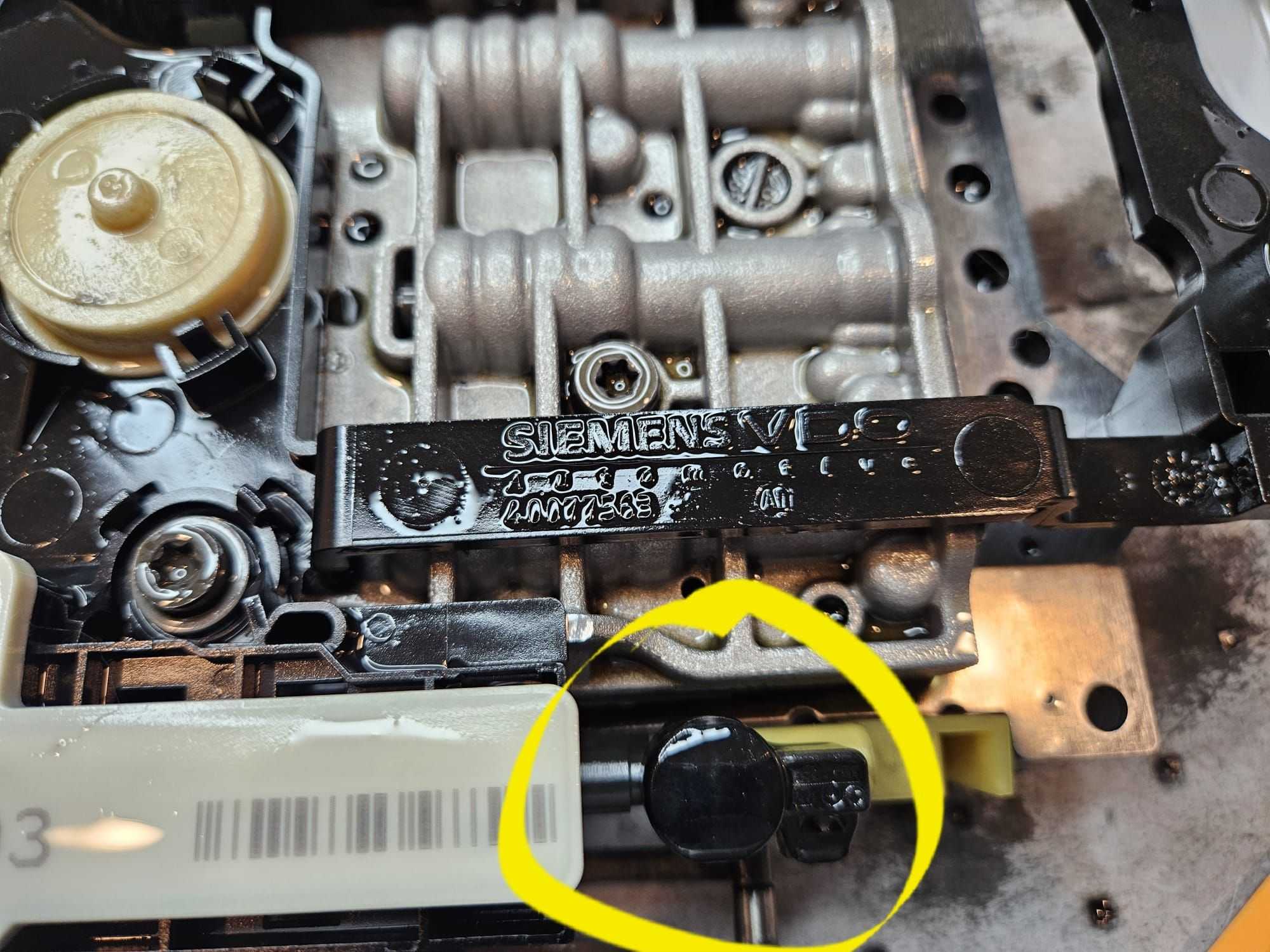

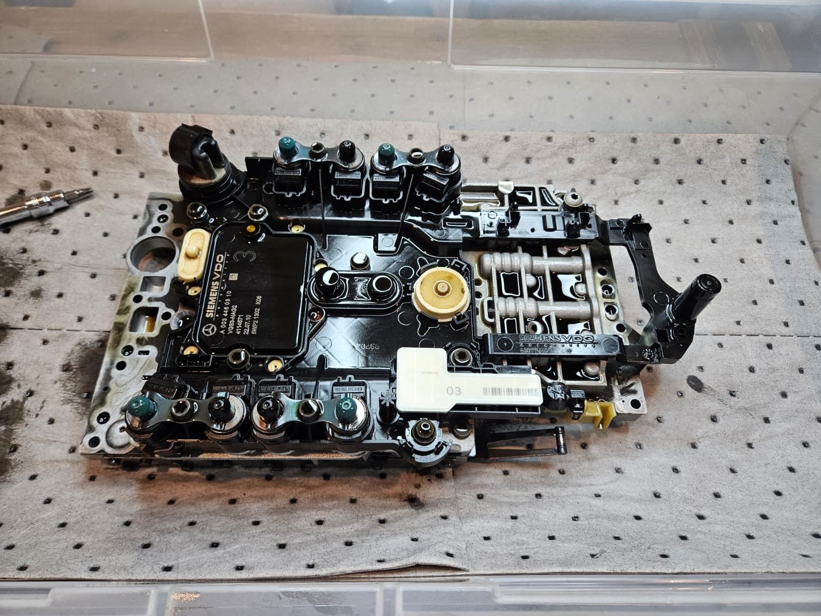

Update: finally got to do it, pulled the conductor plate, nothing unusual. O-rings on solenoids were in great shape, but replaced them. I found a lot of gunk built up on the gear selector rod - so cleaned it up. I also removed the conductor plate from the valve body and cleaned up sensor from under, but nothing unusual to report there.
Put it back together but had the same code coming up few days after, actually twice so far.
I'm going to try the TCM reset, and maybe shifting reprogramming. Unfortunately for my DAS I put myself in a bad spot. Not knowing how this works, I started the programming of new conductor plate. Meaning, I saved my data to the software, but now when I connect to my car it is asking me to continue with the replacement procedure. So I'm a bit stuck what to do there (don't want to damage my conductor plate just yet).

Your Fault Code is about a "Defective" selector range. There is no sense in "programming" or "resetting" anything when you have a defective part.
You can change the sensor with another one from another TCU or you better change the TCU as now after playing "outside" in the open air with a very old plate, the oxidation will be aggressive.
