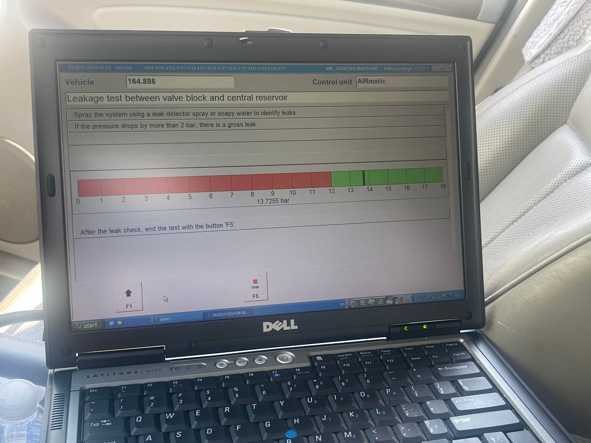

Recently installed a new compressor and ran the complete Star system pressure testing. The compressor kicks on driving much more than any of my other 3 air suspension systems did.
Today hooked up the Star system again … looking at the “Leakage test between valve block and central reservoir… At 20 minutes I dropped from 14.0 bar to 13.725…approx 3psi??? At 60 minutes staying at 17.725..Does anyone remember if there system was perfect and did not drop 0 ? Going to leave it hooked up for an hour or so…
Max I know you did an extensive writeup on the air suspension… Do you remember dropping anything ?
When I replaced the compressor a few weeks ago the air inlet hose was broken off at the compressor so I am thinking some dirt might have gotten into the valve block.. hate to replace with it passing all the test BUT it definitely is running too much ..

The value is more than perfect!
But this test is only about the leak between Valve Block to Central reservoir, just one from many pressure circuits from Airmatic, as is already stated on your picture the leak between Valve Block till any struts need to be checked with soapy water, also there is another hose from Compressor to Valve Block.
Anyway, the Central Reservoir is quit big so maybe in a few days will be balanced.

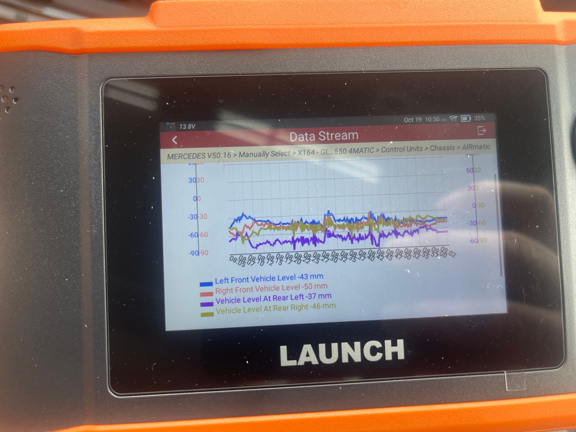

Latest updates
I was not happy with FCP sending out an AMK by Arnott compressor… send it back and now have a Bilstein AMK compressor (new relay) also installed a used airtronic computer board (under driver seat) all same results. Next on the list will be all 4 corners leveling sensors. New german made valve body also.
The GL everytime starting ..as soon as the car hits 25mph (40kmh) the compressor runs for approx 10 seconds (even though before I leave the driveway the pressure is up and all 4 corners are good in heights )
The compressor will turn back on with in a few miles (for 10 seconds) and after that just a few burst 2-3 seconds (pretty normal) . If I shut the car off after the first or second 10 second run of the compressor… turn the car back on .. the cycle starts again ..25 mph and compressor runs for at least 10 seconds.
Following the flow chart both rear and front SAM are involved in the air matic system . CAN B&C bus signals.
Never a dash board error and both Sam’s have zero error and pass Xentry test .
This is definitely one of the hardest and longest troubleshooting spells I have been into with these 164 chassis. While doing lots of reading the 25 mph is the road wake-up for the system… The new Launcher handheld tester shows a lot of movements above 20mm which can bring on the compressor .
One local shop that spent some time on the phone with me said the SAMS should throw an error if they are involved??? Since the 4 levelers are showing a lot of movement … they are next on the list…
I am all ears for anyone having anything remotely the same.
NO LEAKS… PASSES ALL TEST via Launch or star.
No errors anywhere on the system… both under the seat of drivers and back hatch with rear sam are completely clean and water free. I have not looked at the front sam yet.
Both computer boards (original and used) act exactly the same. As soon as I shut the car off and start again same cycle of compressor…. I have even got out and measured the corners quickly and they are perfect height?????? The picture is the graph of level sensor movement .. once the hit 20mm in movement the system will ask the compressor to come on for adjustment … Not sure if the system is smart enough to know there is already a lot of pressure in the struts and bags…

Whats the sensor saying that "tells" the system to lower when you get up to highway speeds? If its an actual sensor that it reads, maybe it is giving false data to the air system and its cycling the compressor at incorrect times. BUT if that system just uses data from the ECU, maybe look at that live data channel (whatever channel tells the Airmatic system the speed of the vehicle) and see what its saying at different speeds?

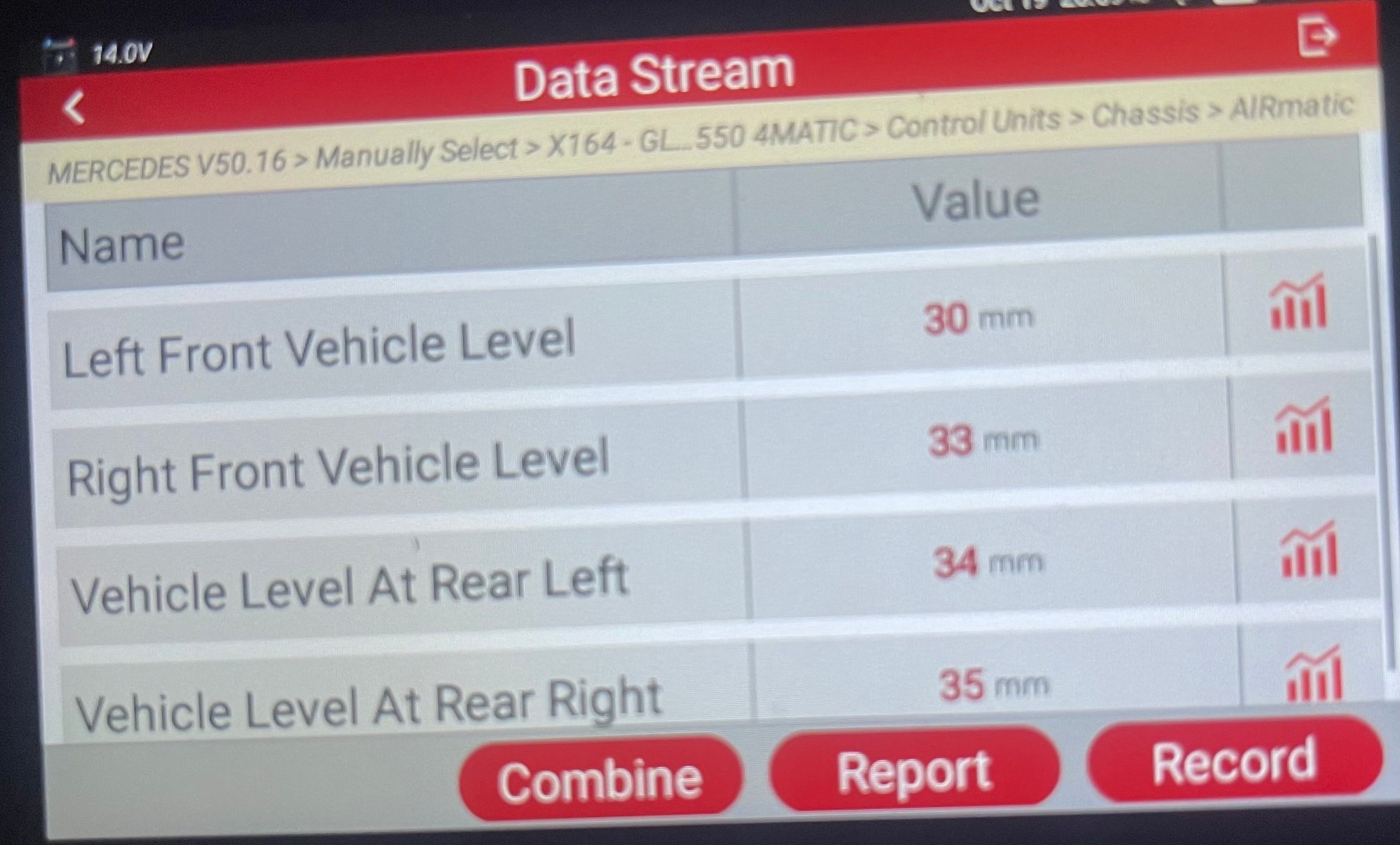

Tonight I tried another approach… I never use the raise and lower buttons. I hit the raise button and ended up with this ….
That is a good bit higher than I drive around 19.5” from center axle to bottom of fender well. The compressor ran for quite a bit but the very interesting part is once on the road and hit 25mph the compressor did not come on? It leads me back to believe that possibly the level sensors could be worn in the constant -25 to -35mm area? ( kinda of guessing at this point)
Will be interesting in the morning when I drive it to see once I hit 55mph if it lowers itself and than starts to act up again?????

When I hook up my reader the car does not sag or lose pressure… I am lost… I am pretty sure the level sensors are going to be a waste of time also.
