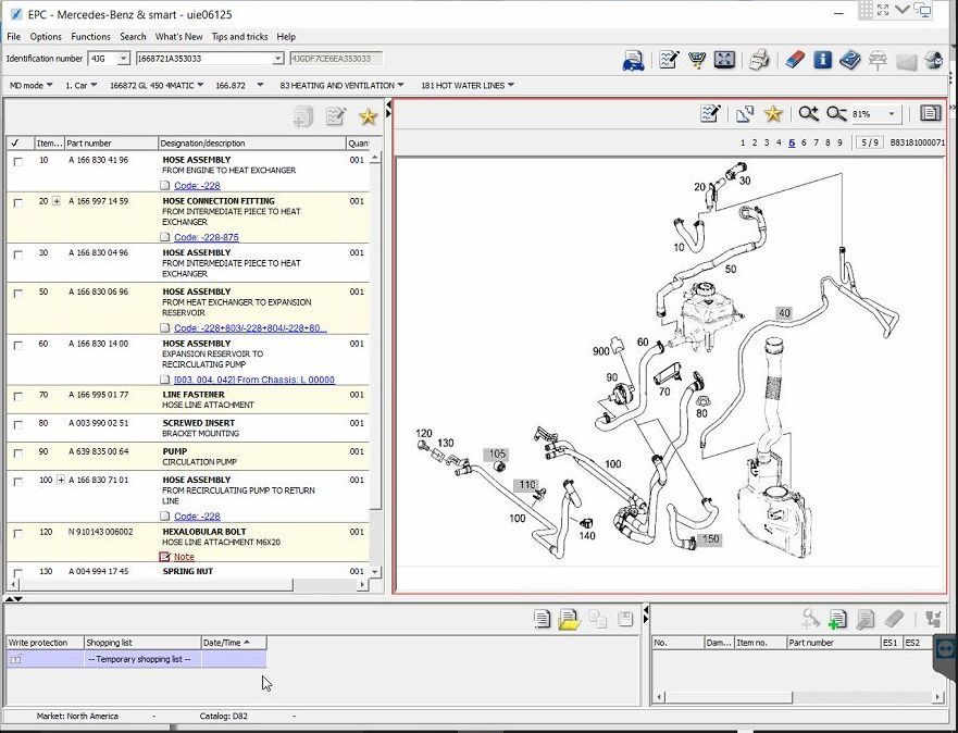

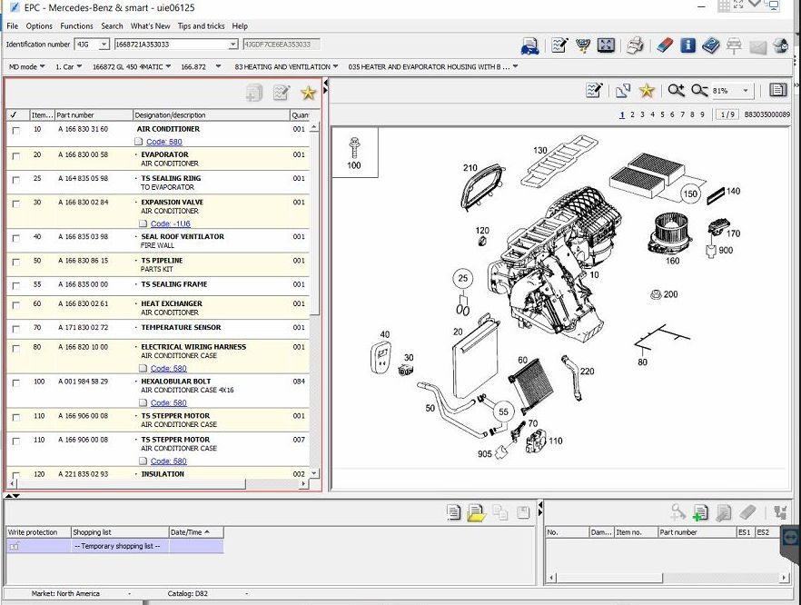

I cannot find it in EPC (screenshots attached)
will try to flush it but doubt I'll have much luck without proper equipment in this weather, so will struggle home if possible and remove the crap ther

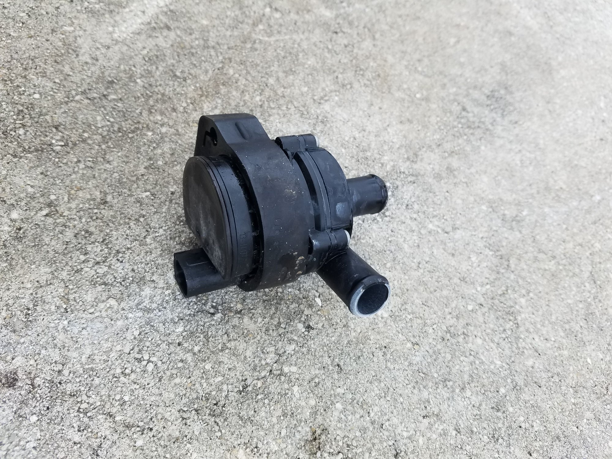

Took it to garage, they said it was the coolant pump (1st pic).
I had one of those so replaced it. Also reverse flushed the heater core, it was blocked solid with the stop leak.
Found some similar sized hoses, rigeed them of in revese to the heater core and fire conpressed air through it. All the crap came shooting out. Then filled with flush and left for few hours, Repeated the compressed air and then ran fresh water through it. Did the same with the rest of the cooling system.
Put it all back together. Refilled system, Jumped in, got engine up to temp. Fired heater up, expecting to be warm and toasty..... NOTHING.
Was scratching my head trying to figure what could be wrong. So I traced all the heater hoses and found one running under the wheel arch next to the washer fluid bottle. Removed wheel, low and behold there was another smaller pump sitting there (Picture 2). I thought the pump I had changed was the aux coolant pump and the main one was attached to the engine. Guess I was wrong.
Swapped out that pump, fired up the heater and I was sweating within minutes. Ready for the next mission on the cold now. Hope this helps someone else.

The bigger pump you changed is for the turbo intercooler. The small one is the aux heater pump. Glad you got it fixed up. Stop-leak is horrible stuff.
