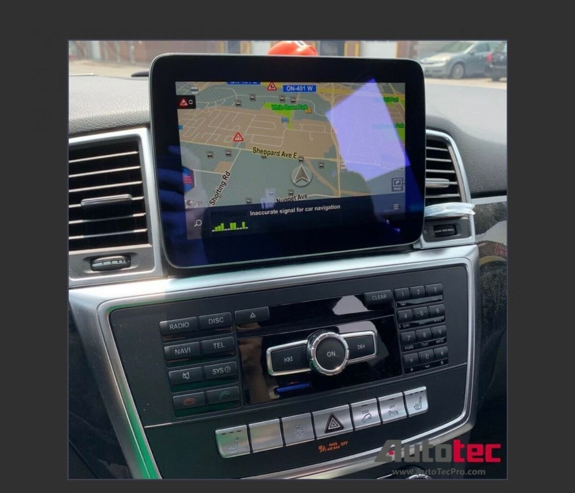

I’m going to pull the trigger on this unit locally.
Newest processor
4gb ram
blue screen.
wireless CarPlay

I’m in Toronto and we have 2 local distributers. I ordered one. I think the only thing that bothers me about these units is that they don’t have radio tunners. No am/fm. You need to go back to the Mercedes system to listen to the radio.
