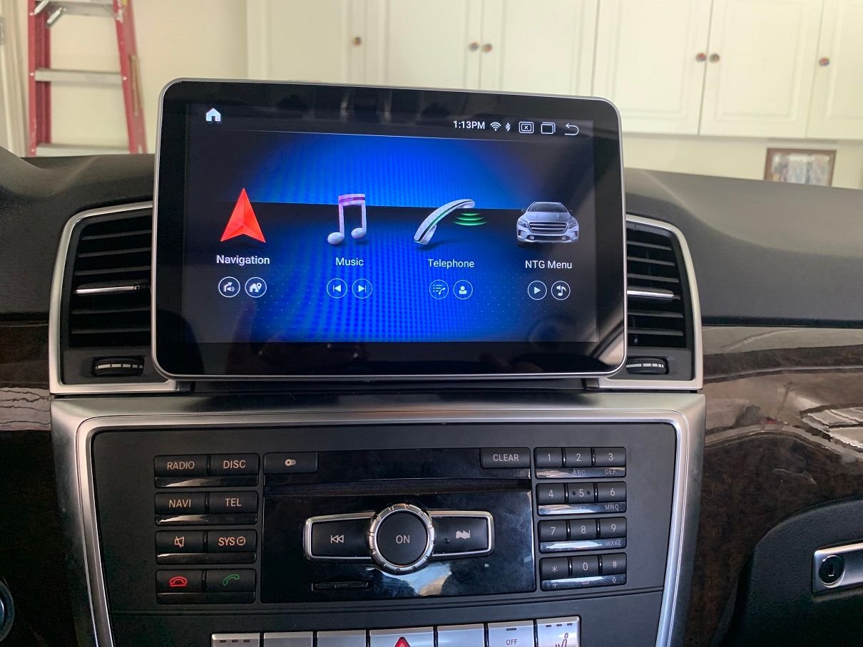

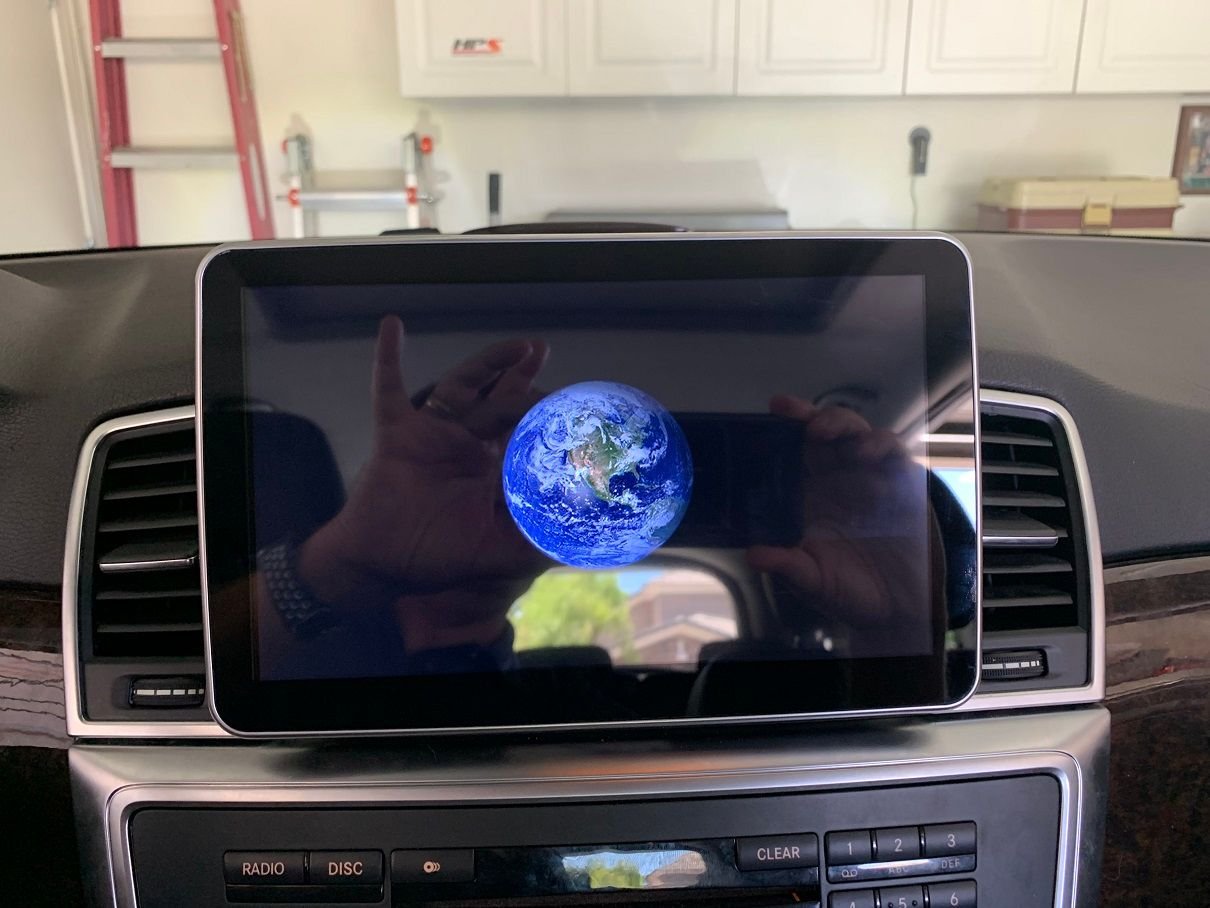

Qualcomm 9" Unit.

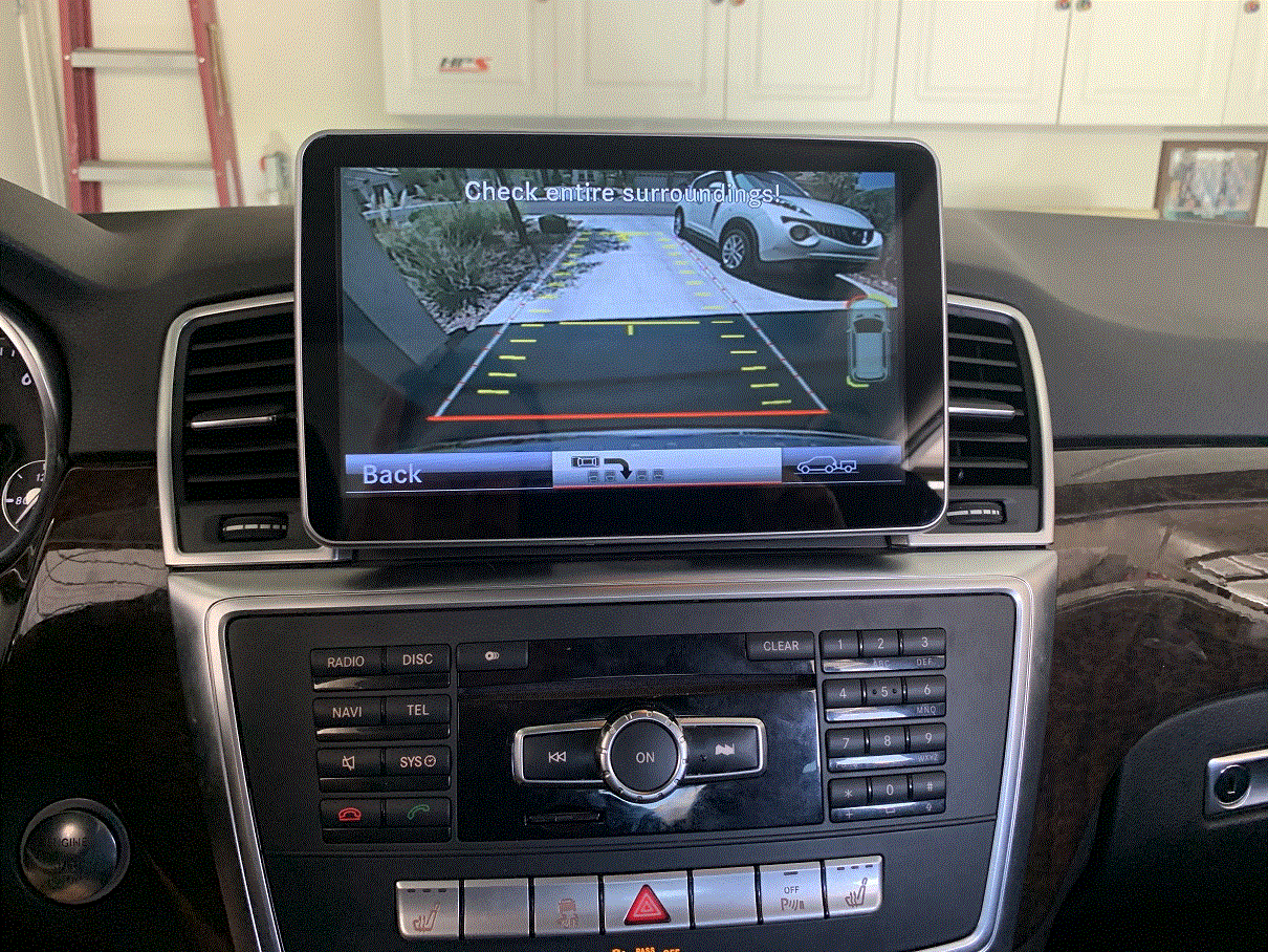

Here are pics of my intstall 2 weeks ago. Qualcomm 4x64 unit. Android 10.
Apple CarPlay
Android Main Menu
Android Start-Up
OEM BackUp Camera
