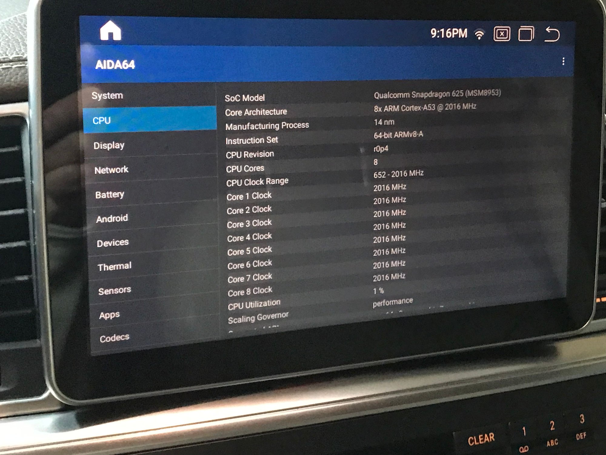

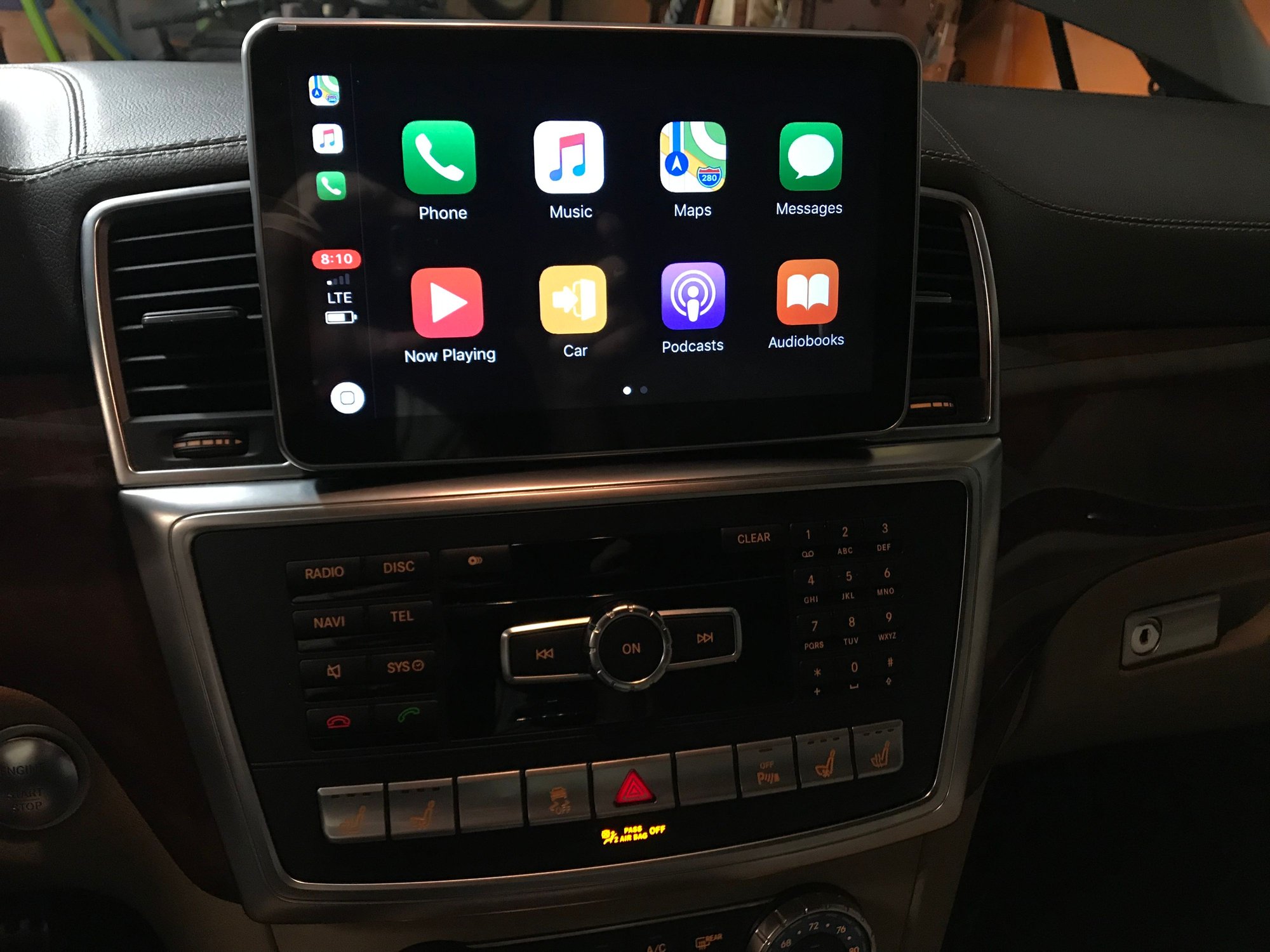

Well, I finally pulled trigger after almost two years watching and learning from you guys. Really glad I waited since I got everything I wanted: newest 9” screen, yes, the bigger size, with newest 8 core Qualcomm processor and android 10. More importantly, on the droid 10, no more of that strange icon on the left side of the screen like in 8.1 and older OS.
Lastly, built in wireless CarPlay and it works great.
One thing to confirm, still has to use ami cable to Aux to make sound work on the android side.
I guess my patience paid off. It seems like Aliexpress is the only place to get the android 10 units.

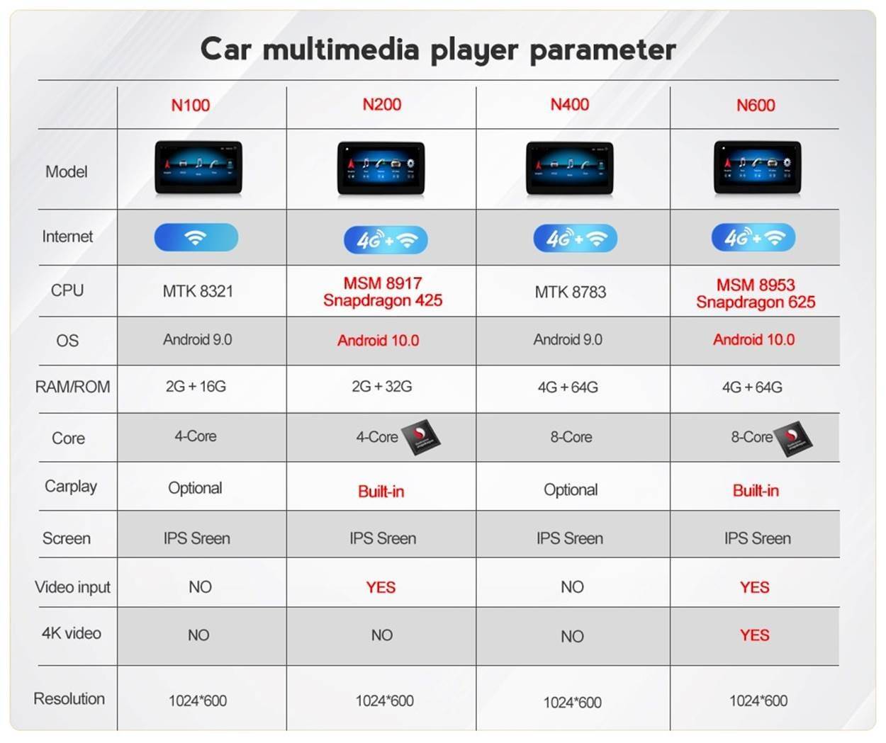

I found the best price and feature set from this listing, I got the top of the line, N600 unit, received in Seattle in 5 days from China.

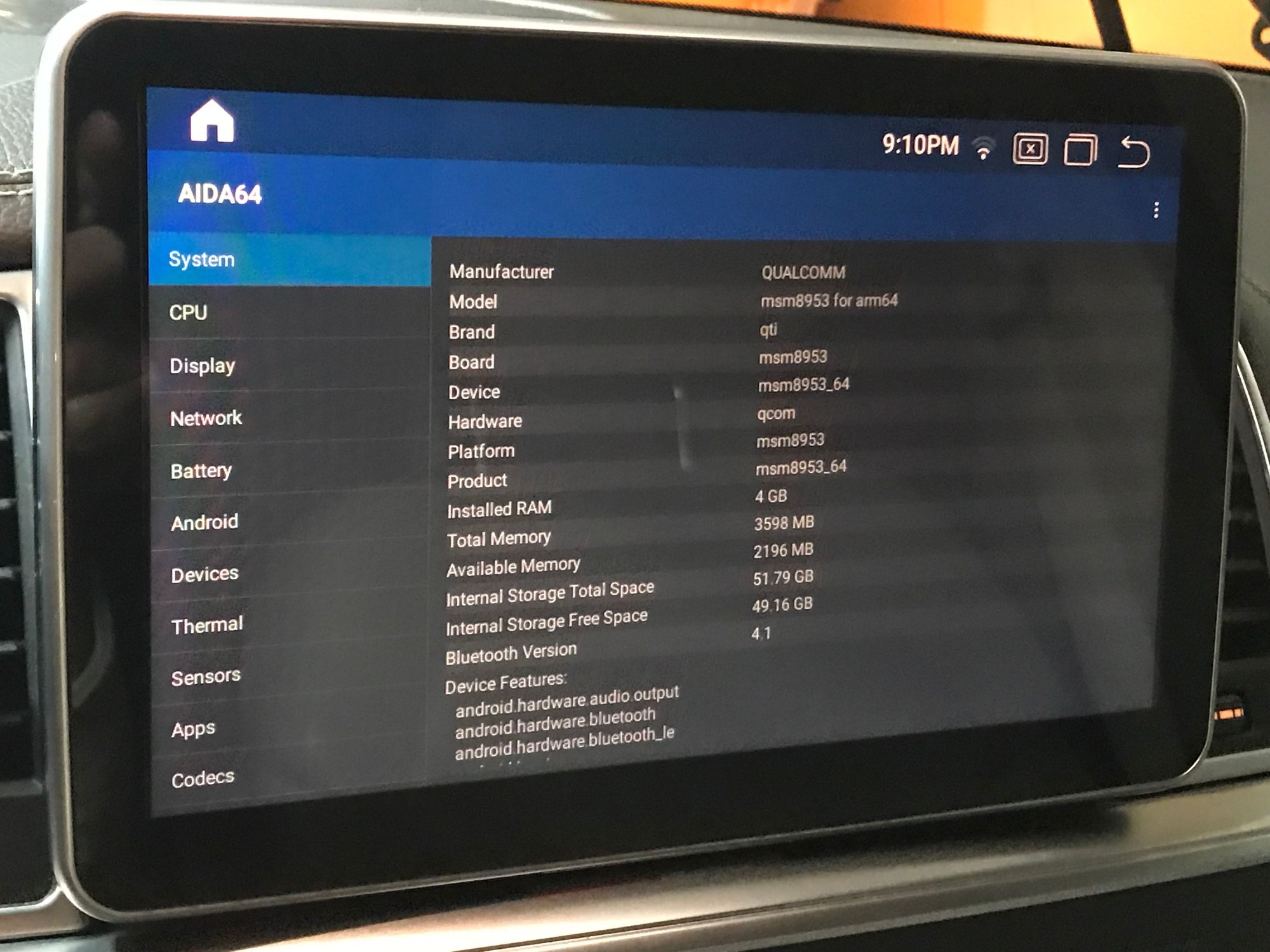

Not to doubt you but I just happened to buy the 9" screen advertised as 4GB ROM - 64GB RAM and 1920x720 sporting Android 8.1. Only to find out by running Android Info and AIDA64 that in reality it has 3GB ROM - 54.12GB RAM and 1020x600 resolution with Marshmallow 6.0 with an 8.1 overlay. Now this is total ROM and RAM not taking in consideration the memory use by the Android system.
I am not yet going to say yet where I bought it from until I hear back as to what they are going to do for me.
Before I follow your steps and pulled the trigger on your android unit, would you mind running any of those two above mentioned android apps and post your finding?

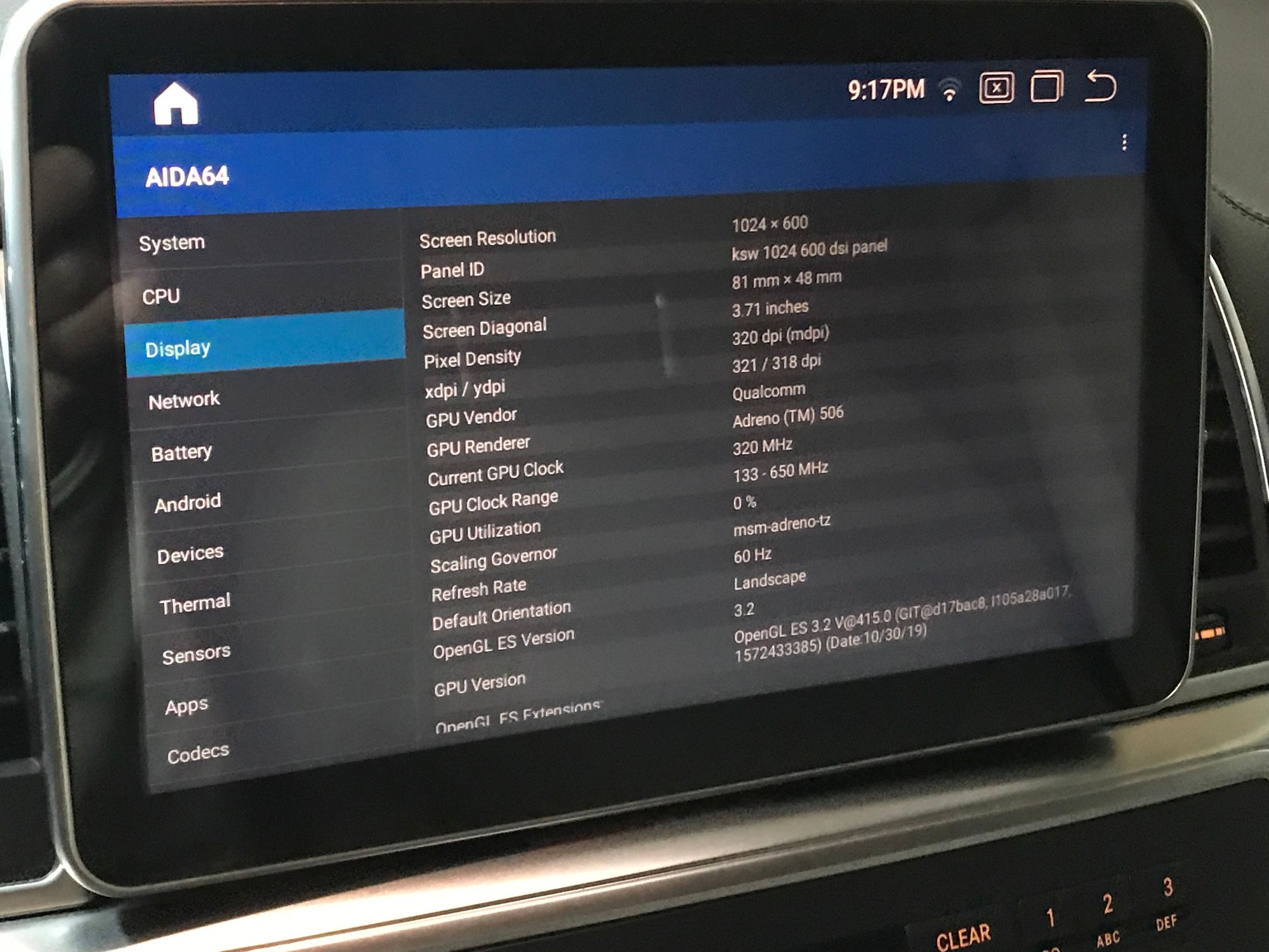

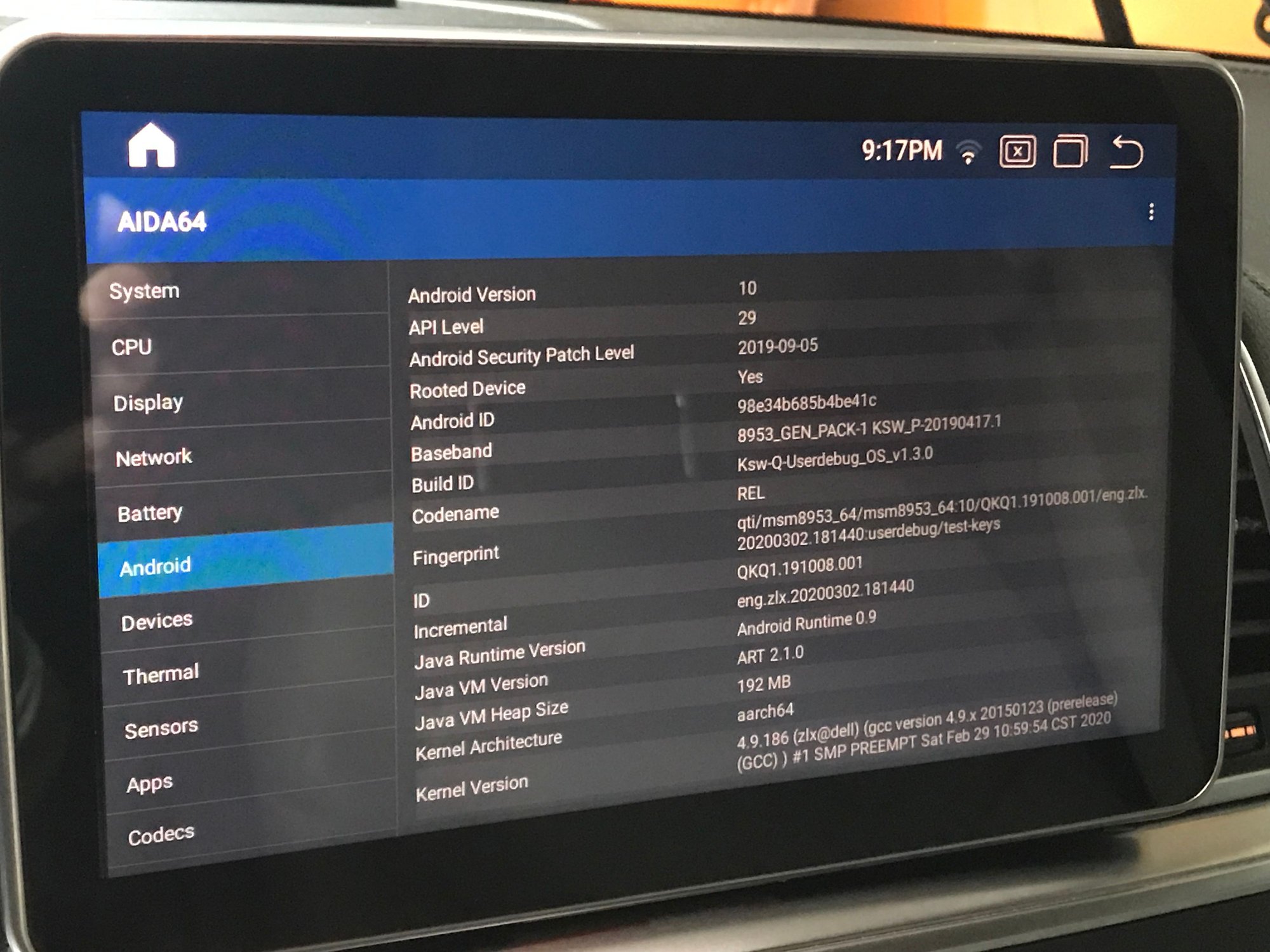

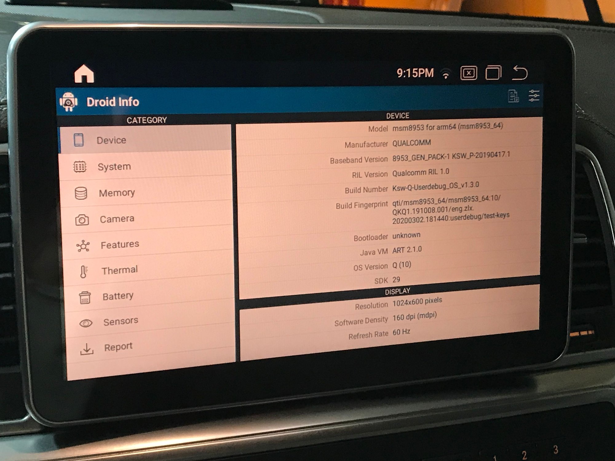

Well, my numbers look good and are mostly true except the same screen resolution issue you have. I will have to confirm with the seller.
I am quite picky hence the long wait since I did not like some of the issues these early units and OS have.
From my research, unfortunately, the place you bought it from looks to be just another importer/reseller with a fancy site and domestic location. I really do hope they will step up and helping resolve your issues.

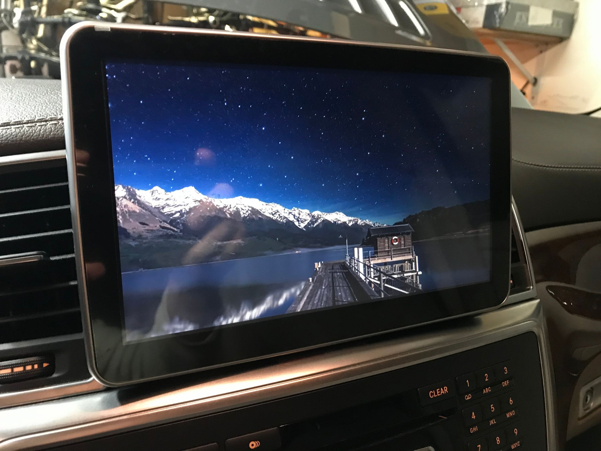

I am really excited about the updated look of the dash, beautiful screen, no ugly icon on the left side, and more importantly, wireless carplay.
I can live with the lower resolution since it’s still much better than the factory screen. In fact, in the android setting, image and video are in HD and look wonderful.

HTCE38- Thanks Much for the picks.
I have spoken to the dealer and they are getting these new units next week. They will according to my conversations with them exchange the unit once they get it next week.. Those are the specs I was looking for and if Android 10 is included with no overlay as you posted I will be happy taking the 1024x600 screen resolution. I think the only way to jump to the HD 1920x720 or even 1280x720 screen is going with the 10.1" screen which is a 16x9 screen. Unfortunately too big for the ML's.
Also one other think to take into consideration is the higher dpi. 320 is much better than 240 dpi.

Be certain that they give you the top of the line, Qualcomm 8653 snapdragon 8 core unit, pictured in my photo.
This is the only 8 core model that has the built in wireless CarPlay which works great. Most of the screens require a separate CarPlay dongle, either wired or wireless, not convenient.
Also insist on android 10 os as there is no software os 10 upgrade I know of. Really glad this os got rid of the ugly bright icon on the left side of the screen.

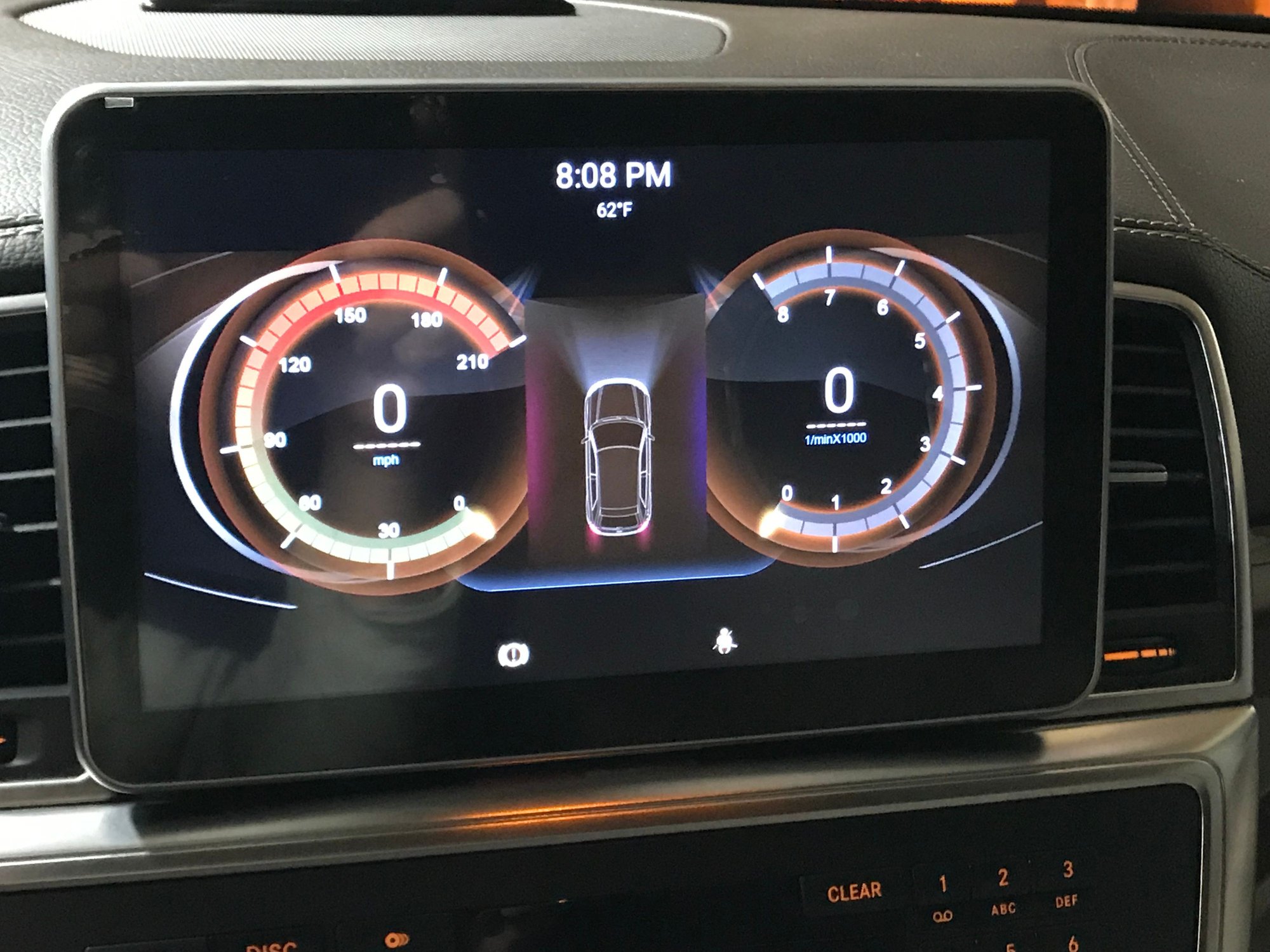

I also notice from your pictures, the speedometer screen now reflects MPH instead of the km/hr, that bugged me along with that stupid blue ribbon and the screen resolution was a step back from the upgrade. Now if they bring in 5G would be awesome to future proof it (not a deal-breaker but nice to have).
What does the app screen look like? Can you download apps? I'm really considering this improved device, I always hated the OEM screen, very dated from today's car screens.
Also, is the install process a little more streamline than before? I know some folks had issues in getting the GPS and audio to work.
Thanks!

I really like my screen, glad I waited for all the reasons I mentioned.
Yes, you can download anything from the android store. You can even download the free offline Google nav map in case you don't have data/hotspot in the car. The wireless carplay feature is great and specially in ios 13, where I can use the phone and have live google map on the android screen in the GL.
I have no issue with the built in GPS's signal, I placed on the under side of dash board. Some folks were able to use a splitter and utilize the factory GPS antenna.
I was using ami cable for android audio, although I actually got audio working though bluetooth and wireless carplay today. It was NOT though AUX or ami cable settings.
I am able to see the screen and back up camera quite clearly. The ips screen is beautiful and resolution is better than the small OEM screen. Maps and videos look great.
I had to trim and put on an ipad screen protector, otherwise, you can't see anything with polarized sunglasses.
