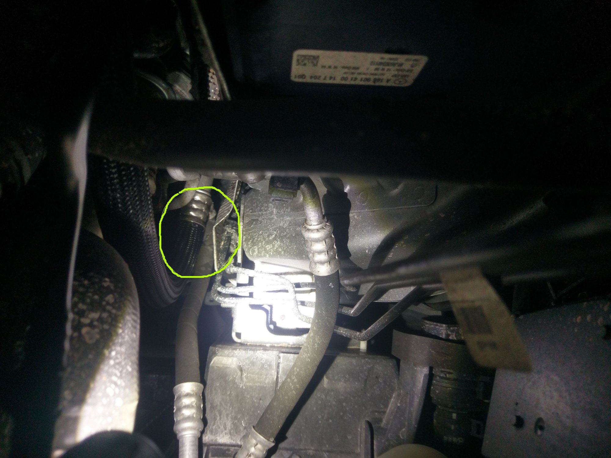

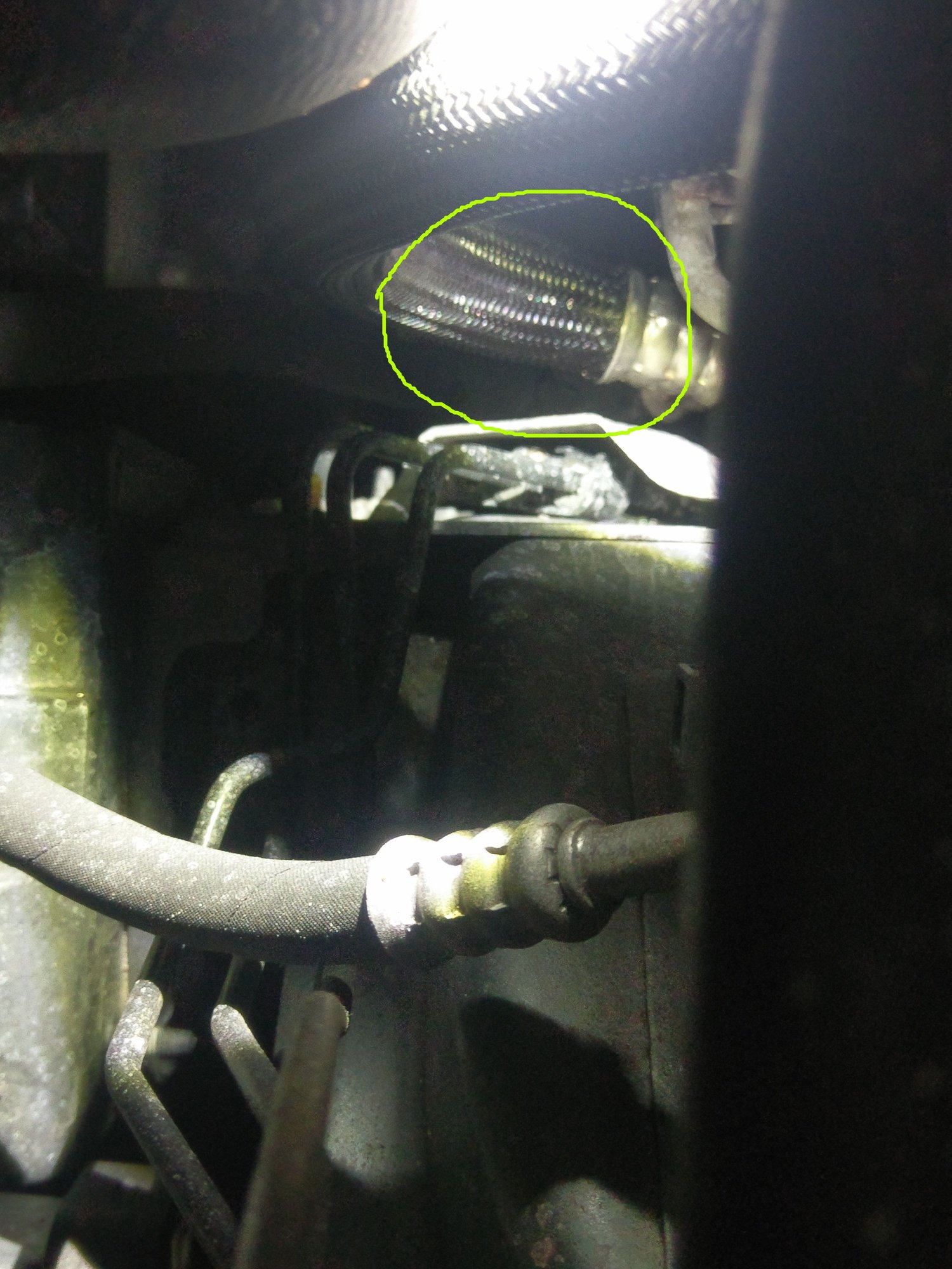

I have a water leak , which appears to be coming from a hose with crimped connections. Is it possible to replace this hose with regular tools, or is it a dealership job?
I have attached a couple of pictures. This hose is wet and swollen, so appears to be the culprit.

That is AC hose. Could be just condensate drips from outside or something else is leaking around

Look up, probably something above it leaking down

Turned out to be turbo coolant pipe.

Turbo coolant
pipe is a common issue with M278. It is the one on top of the engine with plastic housing.

75,000 miles. Bit the bullet and had done at local Mercedes independent shop

Yes, it was plastic housing which was leaking.
