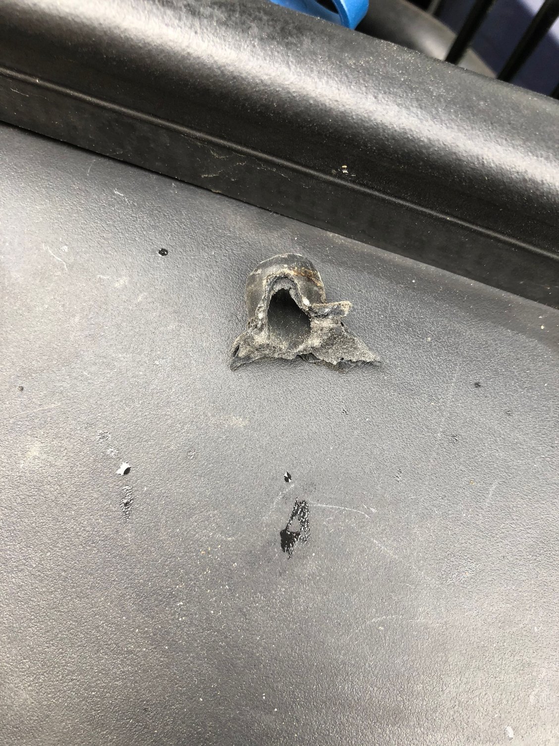

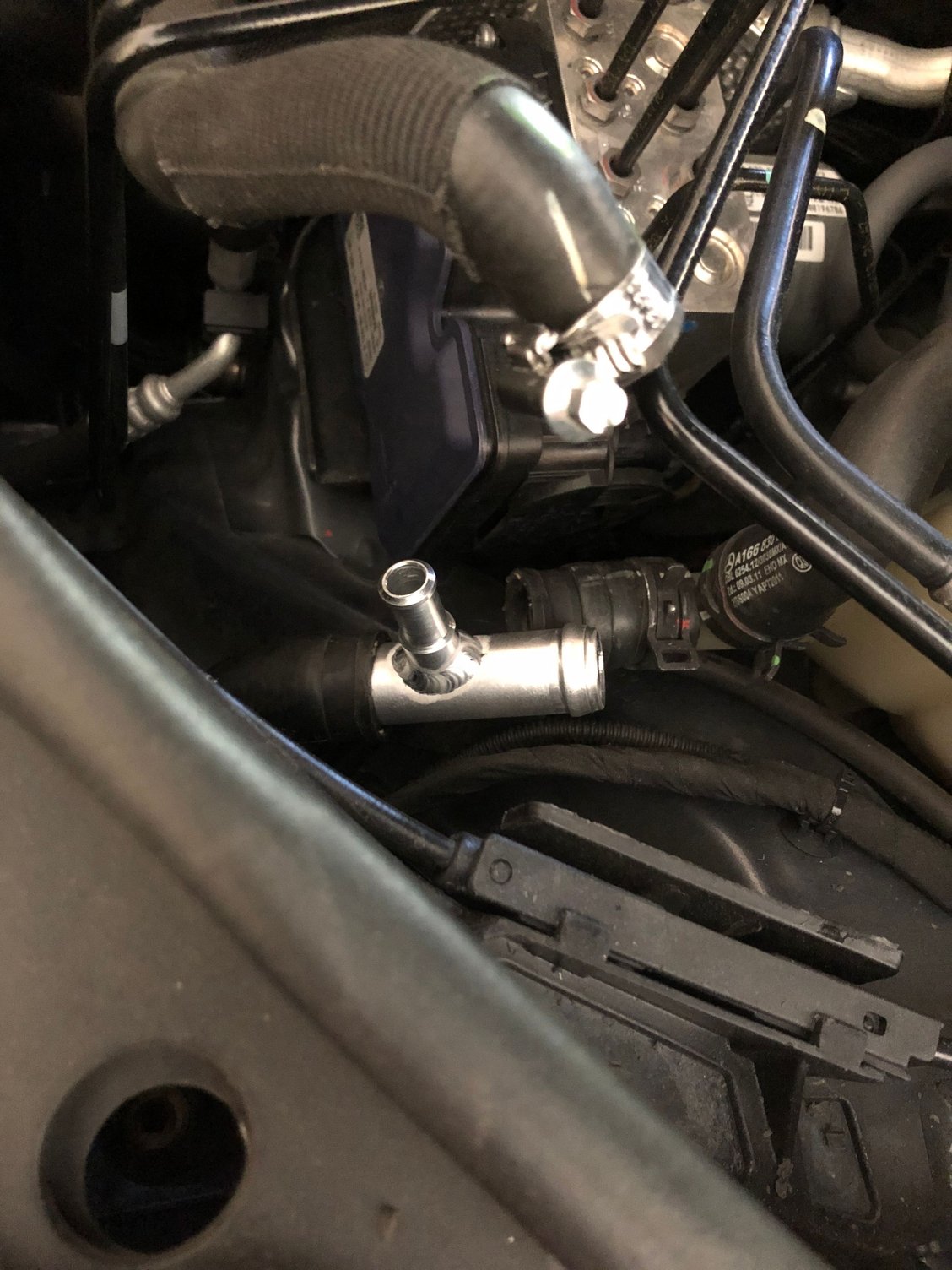

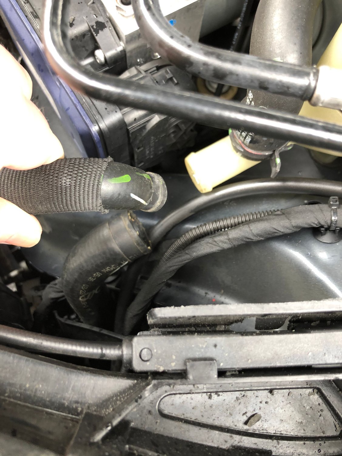

Well, more like coolant explosion. I posted a few months back about a repair I made to the radiator on our GL550. The dealer wanted to replace all the plastic parts associated with the coolant system along with the radiator because, "they'll eventually fail". I'm starting to think he was on to something with all this organic plastic stuff. What are auto manufacturers thinking?? Oh well, I digress.
Fast forward. The wife was down the street and called me before turning into the driveway reporting an antifreeze smell. She pulled into the driveway and I saw coolant dripping from the car. I popped the hood and checked my repair which was fine. It took a minute of investigating but found the nipple on top of the plastic tee, that is connected to hose leaving the reservoir, to be separated. See the pics for the location. This separation allowed for a 1/2" hole in the coolant system which puked out a ton of antifreeze. The plastic part in the pic is all that's left of the nipple. Sorry, did not take a pic of the tee before I destroyed it taking the assembly apart. The hose connected to the nipple goes to the engine and I'm not sure where the other larger hose goes. The tee is connected to all the hoses by one time use clamps so basically you must replace the whole assembly. I never found the part number but assumed it was expensive and looked to be a pain in the **** to replace.
I took some metric ID measurements of the hoses with a micrometer and figured if I could find the right size tee, I could get away with rebuilding the assembly. I found the perfect one on eBay located in Great Britain (took a month to get to GA, lol). If you find yourself on this road, the measurements are 22mm X 22mm X 12mm. I've put it back together with worm gear clamps but need now need some coolant. I pray she did not damage the engine before shutting off the car. I'll report back when its running.
Is Zerex G48 ok for a 2013 GL550??
I hope all of this helps someone else. Here are the pics...

It is a common practice that if you have one coolant hose exploded, we replace all rubber/plastic hoses together to prevent future failure. The rationale behind this is that all those rubber/plastic parts do fade and they fade in a similar pace. If you see one explode then others are likely on their last legs as well. You can definitely choose to just replace the one that broke and keep the others in your vehicle to save some money for now, but eventually you will find that replacing all of them at a time is the most cost effective way to go. Every time a hose/pipe breaks you will need to replace the coolant that was lost, plus you might also have to deal with the inconvenience of the breakdown and the engine can possibly be damaged by overheating.
Zerex G48 is equivalent to the MB blue coolant but not the pink one. You need to check what you have in your vehicle. But why not buy the genuine one from dealer? The price is almost the same.
