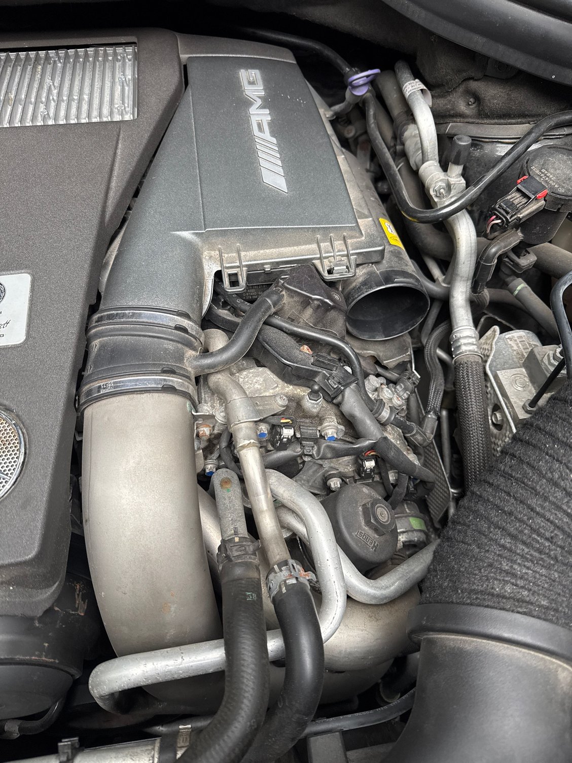

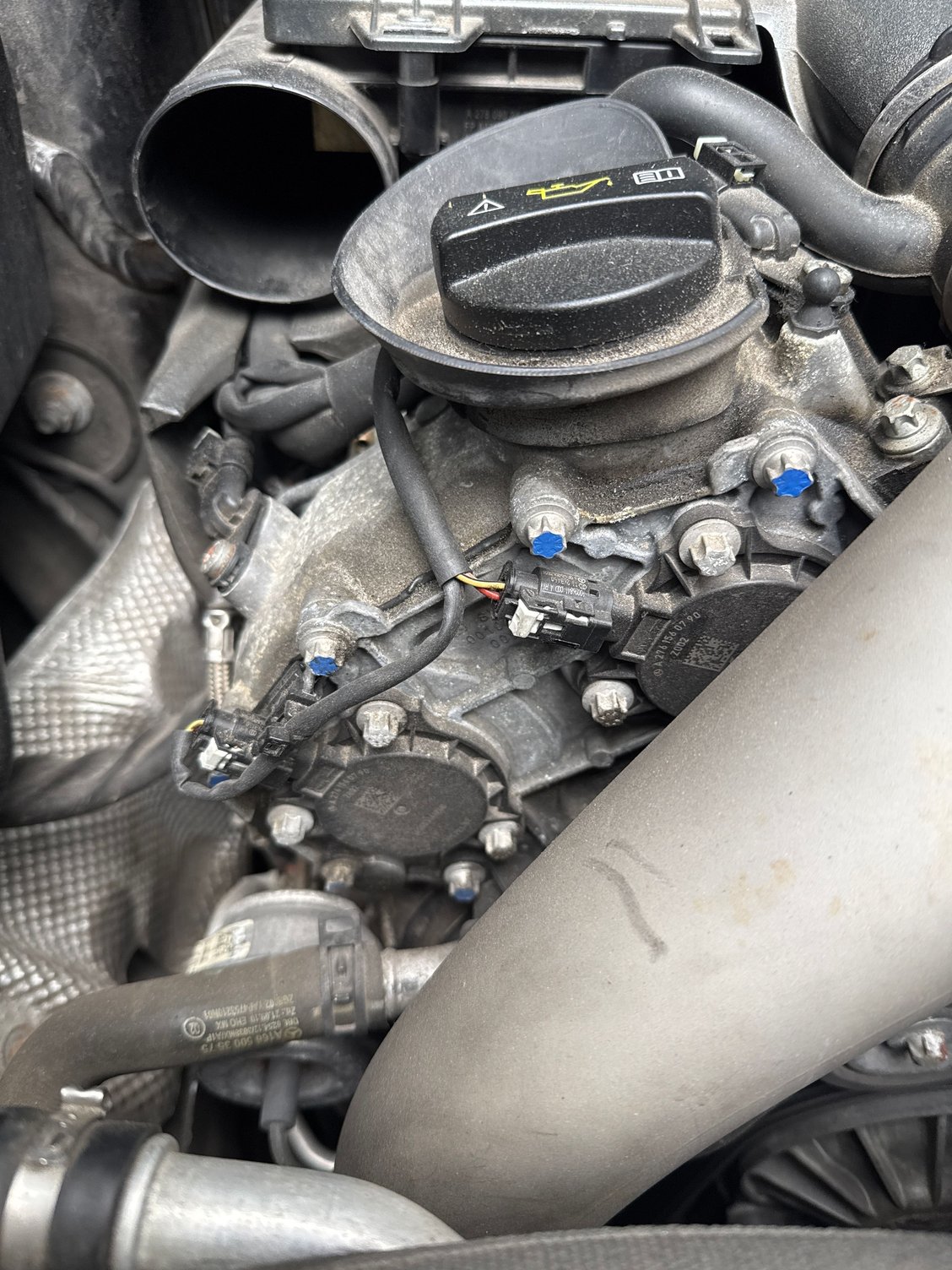

Ok, I still have this truck. This vehicle has provided so much anxiety as it has aged to the point it is hardly driven. I have only around 63k miles. Checked the connectors and they were dry, but it still has some rough vibrations at idle and over 70 mph. I do not believe that pigtails were installed when this was previously repaired. Can someone confirm for me?

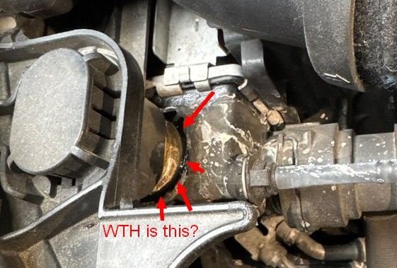

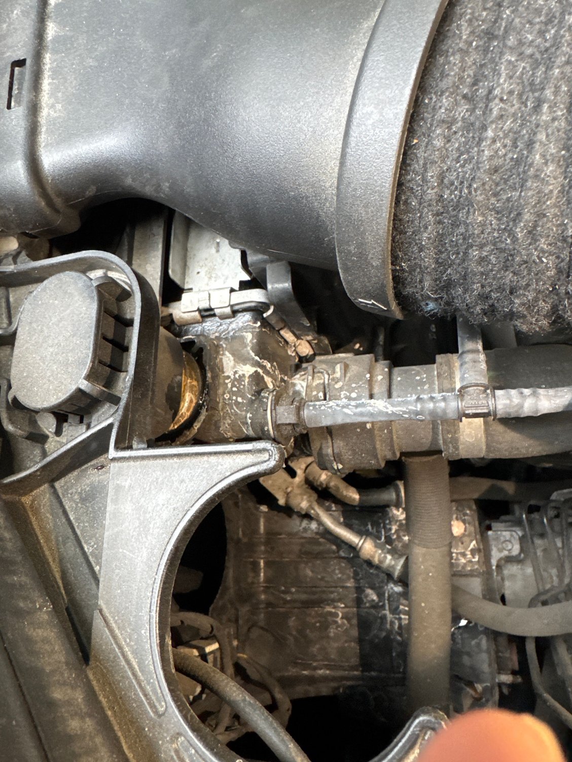

And then lastly, I seem to have a Coolant leak. Anyone seen this before:

I see no pigtails. Just oem wires.
As for the leak, it's hard to tell, especially since your radiator looks different than mine. If it were me I'd just clean it so you can get a better feel for when it leaks again. If it were me, I wouldn't even worry about it unless I was loosing coolant, but it would be nice to see where's it's coming from.
If it still makes a mess all over the place after cleaning then my go-to is to pack the area with paper towels so the air can't blow it around, then pull them off to see where it's wet.
I am curious about that black gunk in the pix. And what is that part anyway? Is that just a mounting point for the radiator or is there a radiator cap hidden under there?
I would also suggest AlumAseal to seal the leak, which I've used since I was 16, but it seems it's discontinued. I can't imagine why because it was awesome, cheap, and didn't make a mess. It was simply Aluminum powder fyi. It gets into and clogs up any hole. They make a liquid version, which makes me wonder if they did that just to charge more $.

To look around the sensor isn't enough, mine where perfectly dry and clean around, exactly like on your picture, but as I plugged it out I realized they were leaking from inside , the 3 pins where full of oil.... 2 or 3 pins in eco plug also oily contaminated with motor oil......don't ask me how the oil can travel to the ecu..

pull the grey tab out for about 2 or 3 mm , then push it down and pull up the connector

I confirm......no pigtail
