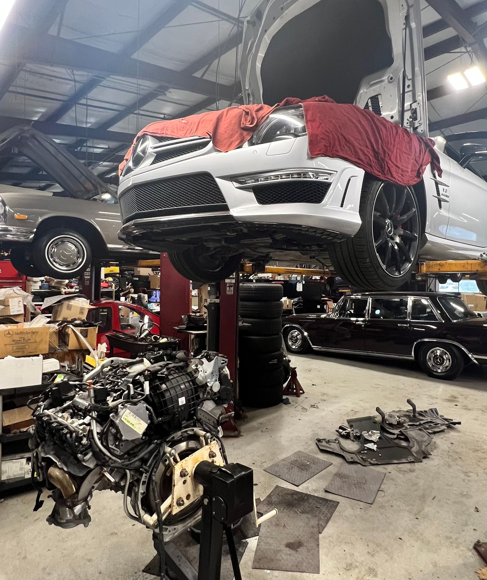

Coming back with an update after two months. To sumarise, I got oil in my engine harness and the oil reached the ECU, 3 injectors, 2 coil packs, O2 sensors, camshaft and crankshaft sensors.
Up until last week, the independent Mercedes shop I took my car to had multiple back and forth interactions with my 3rd warranty company. The shop was awesome in dealing with the warranty company. The owners even prepared a presentation for the warranty company.
The warranty company is paying a significant amount of money to get everything done right. So I decided to go ahead and get the engine out of the car to replace the engine harness and a few other things.
Below is the list of things I’m getting replaced:
-Engine harness
-ECU
-All injectors
-All coil packs
-All the sensors the engine harness touches (camshaft, crankshaft, O2 sensors, MAF, etc.)(excluding the knock sensors)
(oil only got to the camshaft, crankshaft and upstream O2 sensors, but I want to replace all sensors since the engine is out.)
-Camshaft solenoids
-Almost every plastic and rubber hose
-Maybe a few more things
The shop got the engine out this week and they are working on getting everything replaced. Once everything is all set and done, I’ll follow up with another update.
Thank you everyone in this thread for the information and support. Here is a picture with my car with the engine out.

Pretty impressive car collection they're having there, in particular the 600!
Wonder what their total invoice will look like with this kind of work performed....

2012 E63 WAGONL with Oil in Harness
My 2012 E63 wagon (70Kmi) just experienced the same issue and the local dealer quoted Me $10,500 to replace the wiring harness (25 hrs of shop time) and replace cam sensors. I asked if they could give me a quote just to replace the O2 sensor, cam sens54
