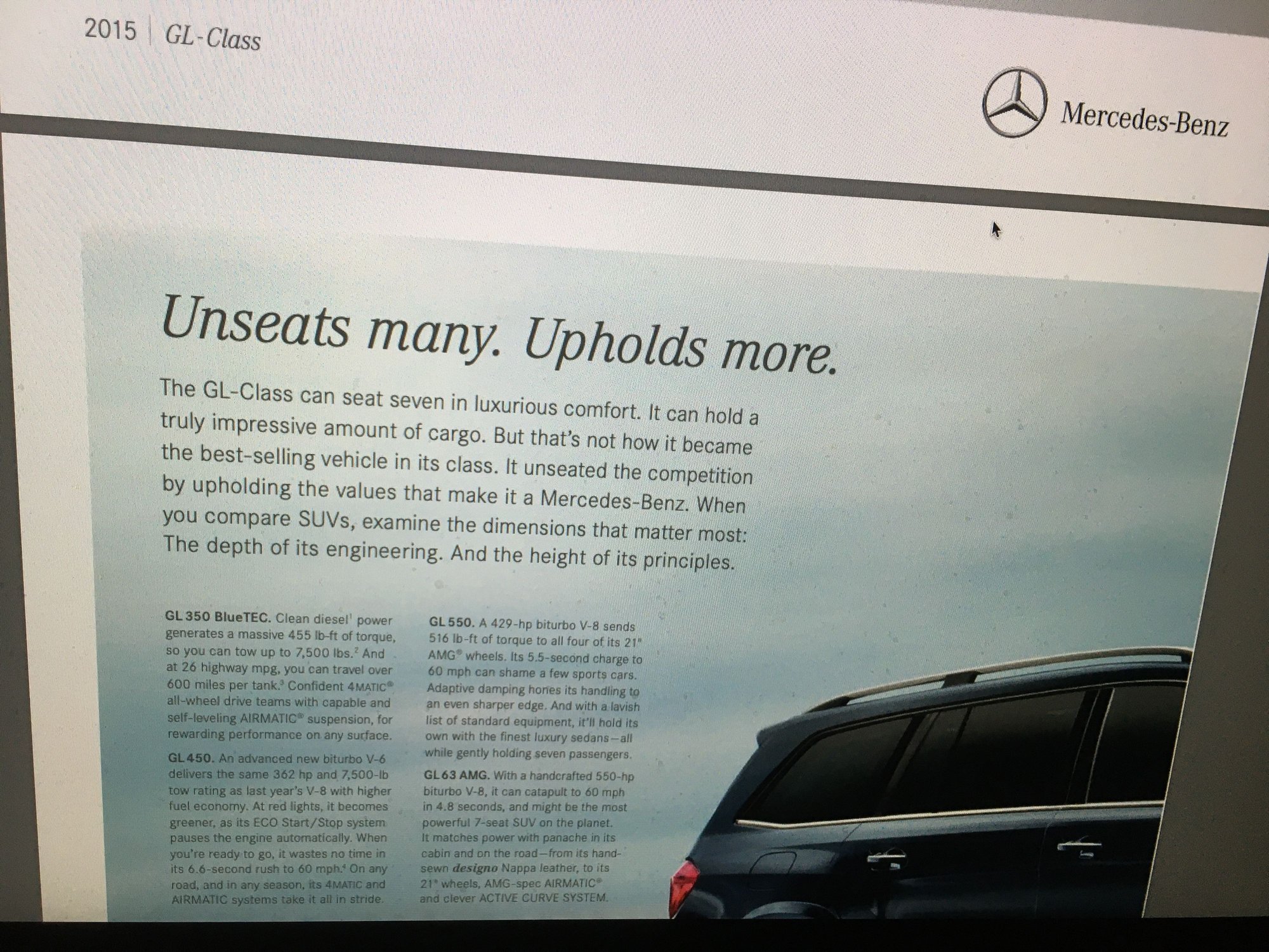

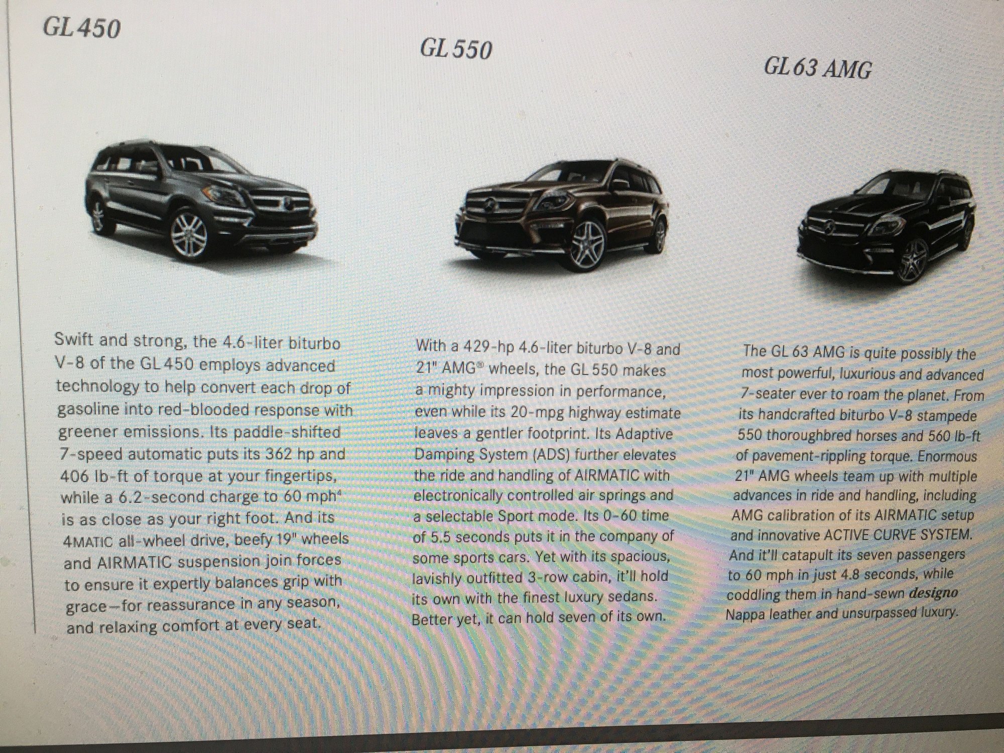

Correct. 6.2 for 450 and 5.5 for 550 from 2014 brochure.
BTW somewhere above it stated 450 had V8 until 2015, actually until 2014. From 2015 GL450 became V6 TT.
