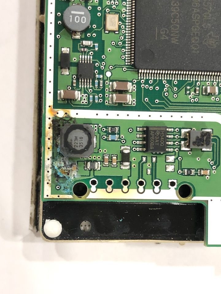

ok, so I found this local shop (owned by ex Mercedes Tech in MotorWerks in Barrington IL), they found a front right sensor defective (not working).
Price for this was little steep, so I said let me look at it.
Surely, indeed, front right radar sensor got a water damage, due to broken housing. How did it happened? Very poor design of the module. I will post pictures shortly
Anyways, I will try to open it up and try to repair the electronics

OK, All fixed now. Defective Sensor Found, and repaired, not replaced. It was defective (due to water damage) So 2 capacitors and a coil was replaced. Cost? Capacitors are probably fraction of a cent, and coil maybe a nickel at DigiKey, and since I do electronics repair, its simple soldering. Here are some pictures with annotations.
I am thinking dealer would take at least $1K from my wallet, with some made up story of taking whole bumper apart, programing, calibration etc....
I am not sure if this will help anyone, this was very odd problem, but who knows Bottom line, anything (well almost anything) can be fixed, just little patience and little soldering skills.
Let's start where its located. Its super easy access, just use flat plastic flat head
Here is the sensor and where it cracked and water/moisture got in
After opening it, well self explanatory
This is after cleaning it, and replacing components
And here is a look at all that is inside
Any Questions ?

I owe a clarification on this post. At first I claimed its a "poor" design. Well its somewhat true, but here are the facts. 2 years ago, my wife swirled off the side street and hit a tree with about 5-10 mph. No Damage, what so ever, just a small crack on the bumper. We did not report it to insurance. But now I see that little "bump" caused a crack in the module, which did not go bad right away, but it took 2 years for water/moisture to work its magic.
So is it really bad design? that 5 mph will cause a sensor to break? You will be the judge.

Dealer don't fix these modules, just install one and program it in the CAN bus.
The squares you see on the board are phase array Ghz antennas for directivity. You can Google it.

How did you hunt down the defective components and cap and coil values?
