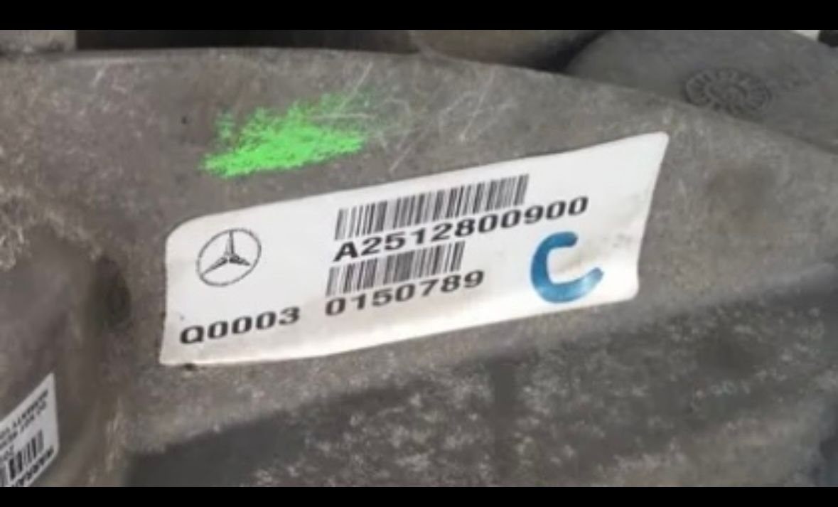

Hey guys,
so I’m getting some hard thumping at the front of my vehicle when I accelerate and the mechanic told me my transfer case is done.
I plan on selling next spring so really trying to budget the repair.
I found a transfer case used with low mileage but want to make sure it will fit my 2013 GL550.
a dealer told me the part I need is A251 280 35 00 80
the seller indicated this one would work on mine but just wanted to confirm:

So i am on my second replacement transfer case for my 13 GL 450. I replaced my original TC in February. I did what you did. I took the dealer part number and found that wow, this "form factor" for the TC has been used for years across many different models. What I have learned is that even though they will fit, you may not get the best life. My first replacement case from ( E B A Y) lasted about 5 months and 2500 miles. I managed to find the only on that site that had my part number on it and not a similar part. The reason you have to be specific is because there are different models supported. ML, GL, RL. Off-road, non off-road. 450 and 550 are slightly different I believe but I dont know the specifics as to why. Also, i have a good indi german shop that does my heavy work. They (and most other shops) refuse to rebuild these.
I spent $1000 for the first TC which was remanufactured. The model number was A2512802900
I spent $800 on the second TC which was used. The model number is A251280350080

I’ll definitely consider it. I have to replace fluid too right?
appreciate all the help!
Yes, I used this one - you need one quart:

No problem. I had a buddy do mine and grease it all back up. Took no more than 2 hours so make sure if you swap the chain they don’t bend you over. Also there are some bearings in there as well. Should you need to replace them I can sell you the extra I have or send you the link. Will have to hunt wheee I bought them from. Chain however likely all you need and be done cheaply and back to normal.
Im still waiting on a price from the mechanic I use. I called a few transmission places who told me they won’t touch that job.
Once I get a price I’ll message you for the bearings. Wish someone can refer me to a reputable shop in Michigan that won’t bend me over lol
