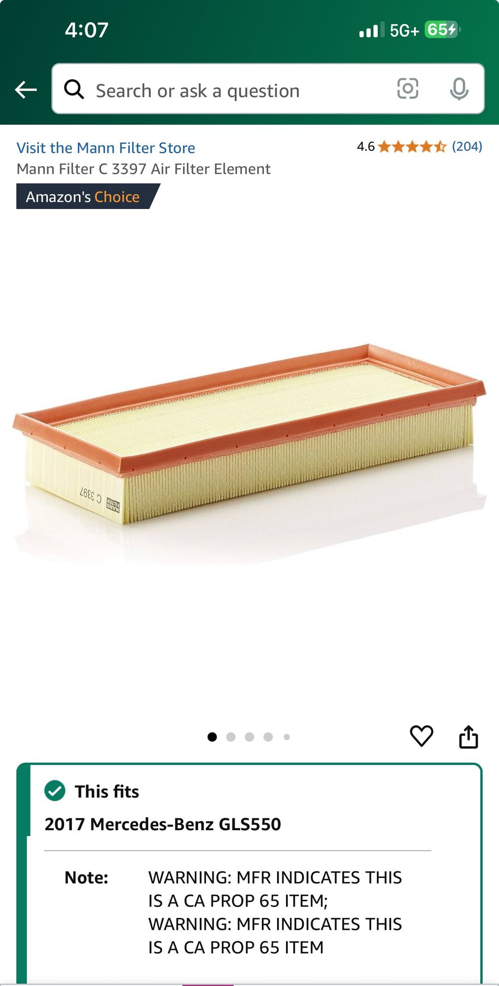

When I got that code I put in new air filters and cleaned out the air filter housings. Error then went away inside 20 miles of driving. I'm not saying this is the surefire fix but it worked for me. I put in the OEM paper filters. Thought about K&Ns or other 'high performance' filters but from what I read the OEMs are best for a turbo charged engine.

thank you! I will pick some new filters up and try that. I looked at mine and they seemed good but who knows? Definitely worth a try. Thanks again

Thank you for the air filter suggestion, I dropped new filters in and instantly when I turned on the car CEL was gone!!

Car having that error also - which air filter are we talking about? Can you post the part number - are we talking about cabin air filter or something else?

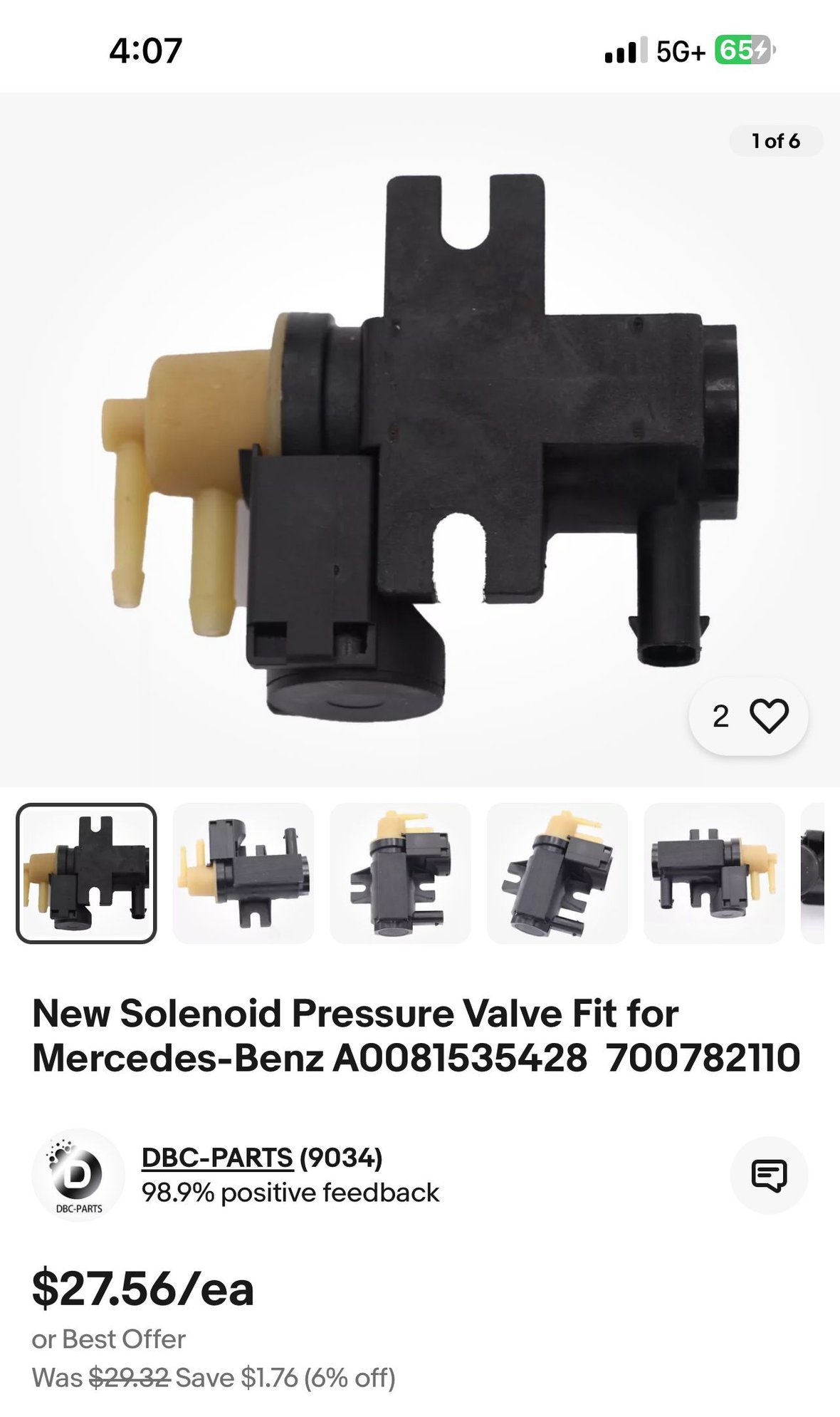

Thanks for asking the question. So after my first update the car ran fine for about 2 weeks. Then the CEL came on again with the same code P0299. After more research and asking around I purchased a mityvac pump. I used this to pull vacuum on each waste gate valve actuator, I pulled enough vac on them to extend the rod all the way then held it for 15 minutes. Once I confirmed no leak on each side I was left scratching my head…but excited because that means turbos probably won’t be the issue. So after lots more research, mainly on here and YouTube to be honest. I came up on the pressure solenoid and little check valves in those lines. After inspecting the check valves for oil and finding them relatively clean I went on to the solenoid. I tried testing it but was not too confident in my execution of said test. But I don’t know, call it intuition, but I decided to replace the solenoid anyways, I found a seller on eBay with same part numbers for like $28. Thought to myself I’ll order it, if it works for 6 months then takes a crap on me I’ll at least know what I need to order. So here we are today, replaced pressure solenoid and still not codes. Hope this helps, I replaced both; engine air filters and pressure solenoid, the solenoid has been the actual fix in my case. I attached picture of exact items I purchased. For reference I have a 17” GLS550

Hi @ItsMrG - I have the same situation. Do you have a DIY on how you placed replaced that solenoid? This code keeps coming back every two weeks. It clears itself when I drive very casually, but then when I get on the expressway, Infor to pass somebody it always comes back

Sorry @jvakos but I don’t have or didn’t make a DIY. I went off a YouTube short video. It is pretty easy to replace once you know where it is at. I left the YouTube video I found down below. Sorry I couldn’t be of more help and good luck.

@ItsMrG hey that video is super helpful. Thanks so much! I’m probably just gonna buy the part for 40 bucks and replace it myself! Thanks again for taking the time to reply!
