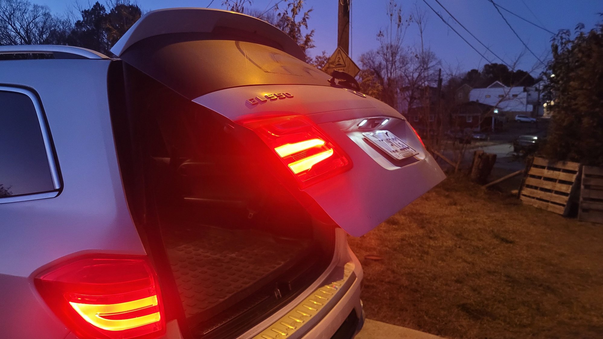

The tailgate on my 2013 Mercedes GL550 only opens halfway, I've tried opening it up all the way and holder the tailgate close button but I don't hear any beeps. I also hooked up my scanner and monitored the tailgate position, at half open the sensor thinks it's fully open. Does anyone know where the limit sensor is on these vehicles?

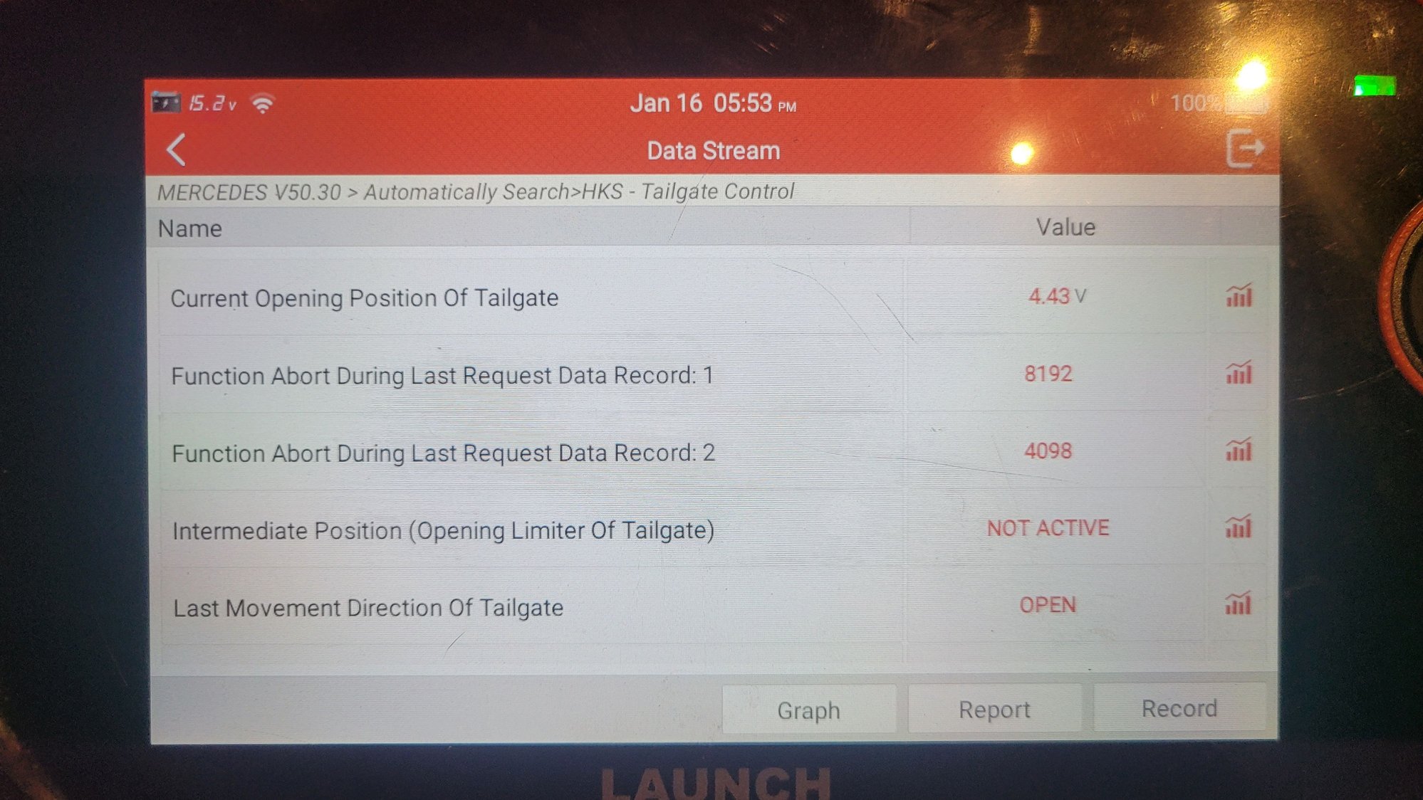

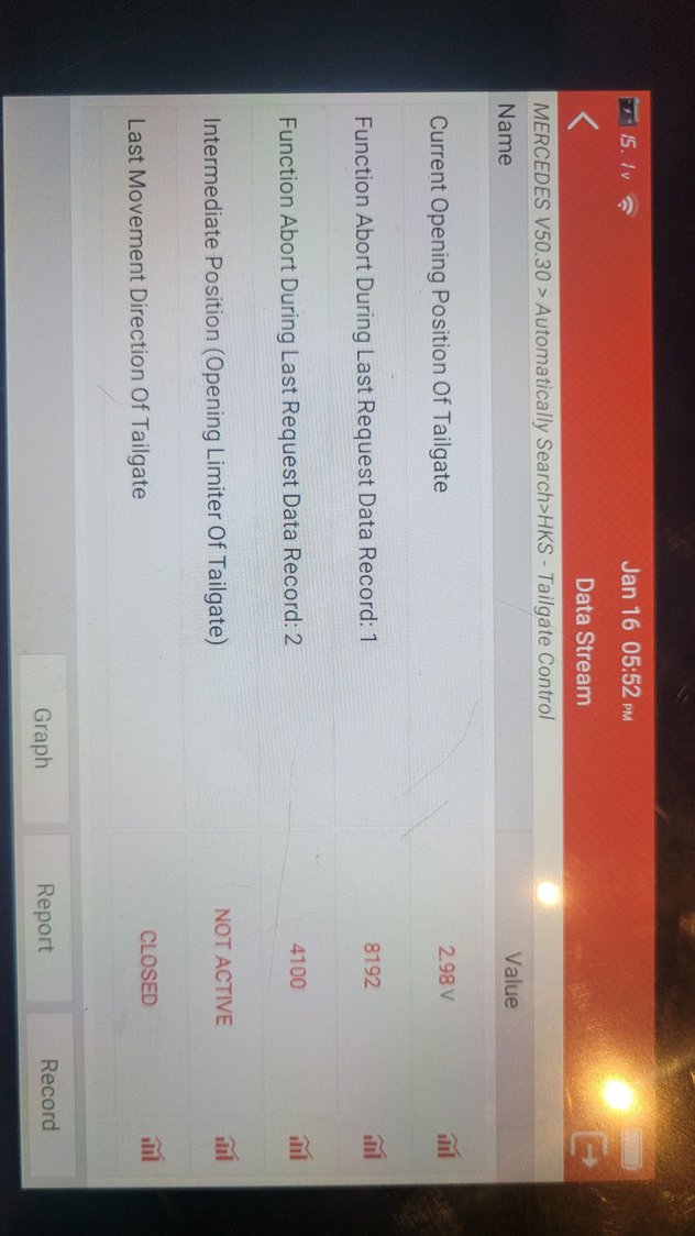

I did some more testing, the problem is the sensor for the tailgate is not reading correctly, at full close it's supposed to read 0.5v and at full open 4.5v. The problem is it's reading 2.9v at full close and hits 4.5v at half open. If I push the tailgate manually up to the full open positive it's then reading 0.5v which is supposed to be full close. Anyone know where the sensor is located?

I tried that, didn't work, the problem is the sensor thinks the tailgate is half open when it's closed and fully open when it's only half open, it must be the sensor that's messed up.
