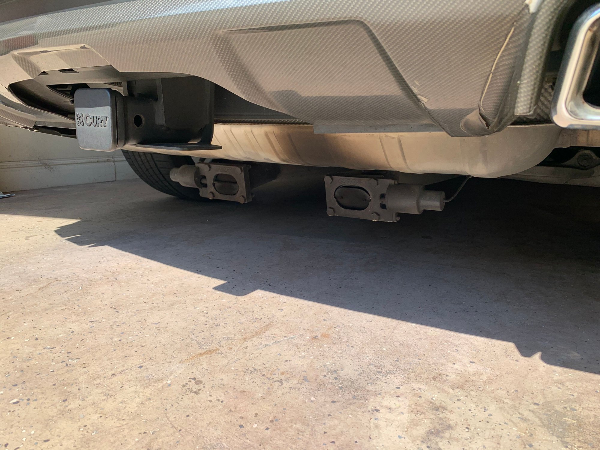

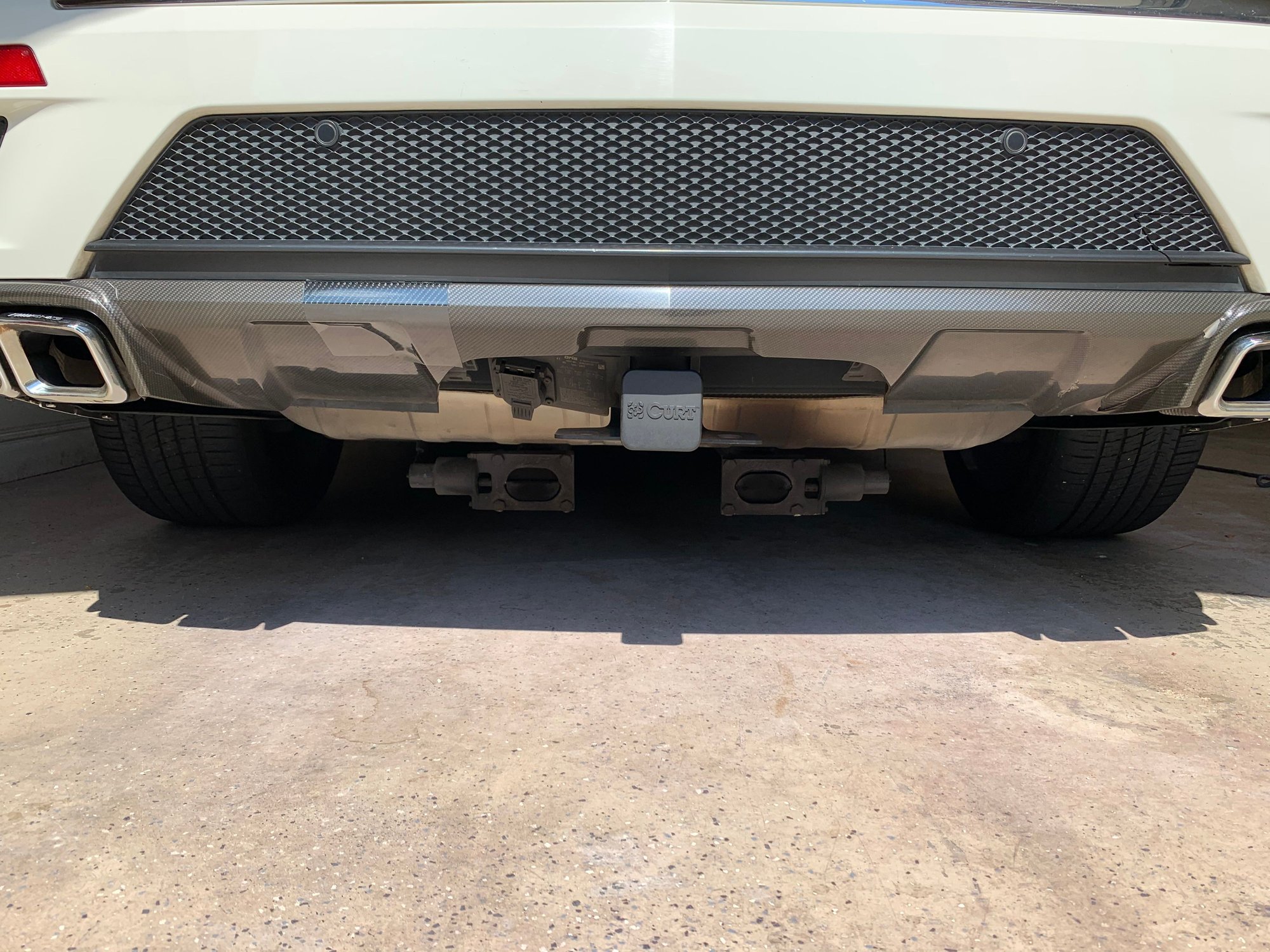

Added exhaust cutouts to ours. Controlled via the homelink buttons to open and close.
have catless downpipes and now resonator too

Quote: Added exhaust cutouts to ours. Controlled via the homelink buttons to open and close.
Just aftermarket cutouts, vented to the atmosphere? So completely bypasses the factory exhaust?

Yes full bypass of the stock mufflers if so desired.
smell? Barely noticeable to me vs my E55 which smelled with windows down at lights. The E didn’t have cutouts but was catless. With the exhaust so far back don’t get any real smell.
I will snap a pic and upload the cutout location later on. I have a few videos I can try to post to YouTube and share too

Here are some vids and pics. We have a 550 but similar motor of course. The 63 mufflers do allow more free following still so on the Downpipe and no cutouts or closed cutouts gives you a good idea.
Open all the way they become a bit much for me. I keep them about 20% open usually unless I pull up against something to let them know this big ol SUV is quick too. I think fully opened should be a bit deeper?!?
In the acceleration vid the cutouts are open all the way.

Very nice. Not worried about the decreased clearance with the cutouts?

No issue with clearance and never think about it.
