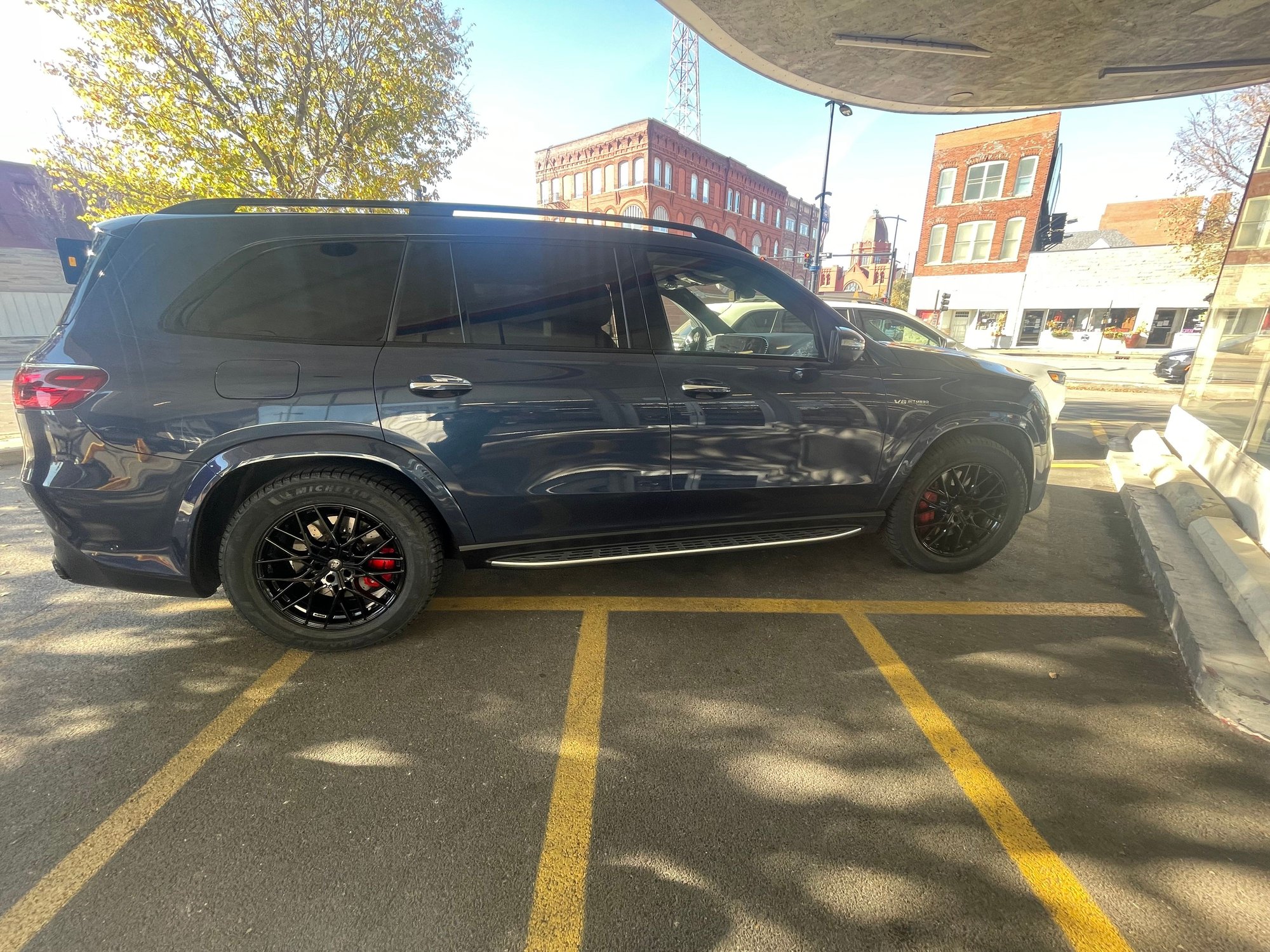

Update:
I went with MSW type 74 20x9” with all square 20” Michelin X-Ice Snow 275/55R-20. All in about $2800 with TPMS. They look nice and clear calipers. Spacers not needed but would help appearance (5-10 front and 25 or so in back). But diameter is within 1/10”, so no AWD or speed/odometer problems.

Originally Posted by KS_ASeitz
@losy Tagging you in case you didn't get a notification.
Old Jan 30, 2026 | 03:52 PM
Johnnybotz's Avatar
Joined: Jan 2026
Mercedes GLS580
rims
Originally Posted by kfehling
What rims are those? They look great
