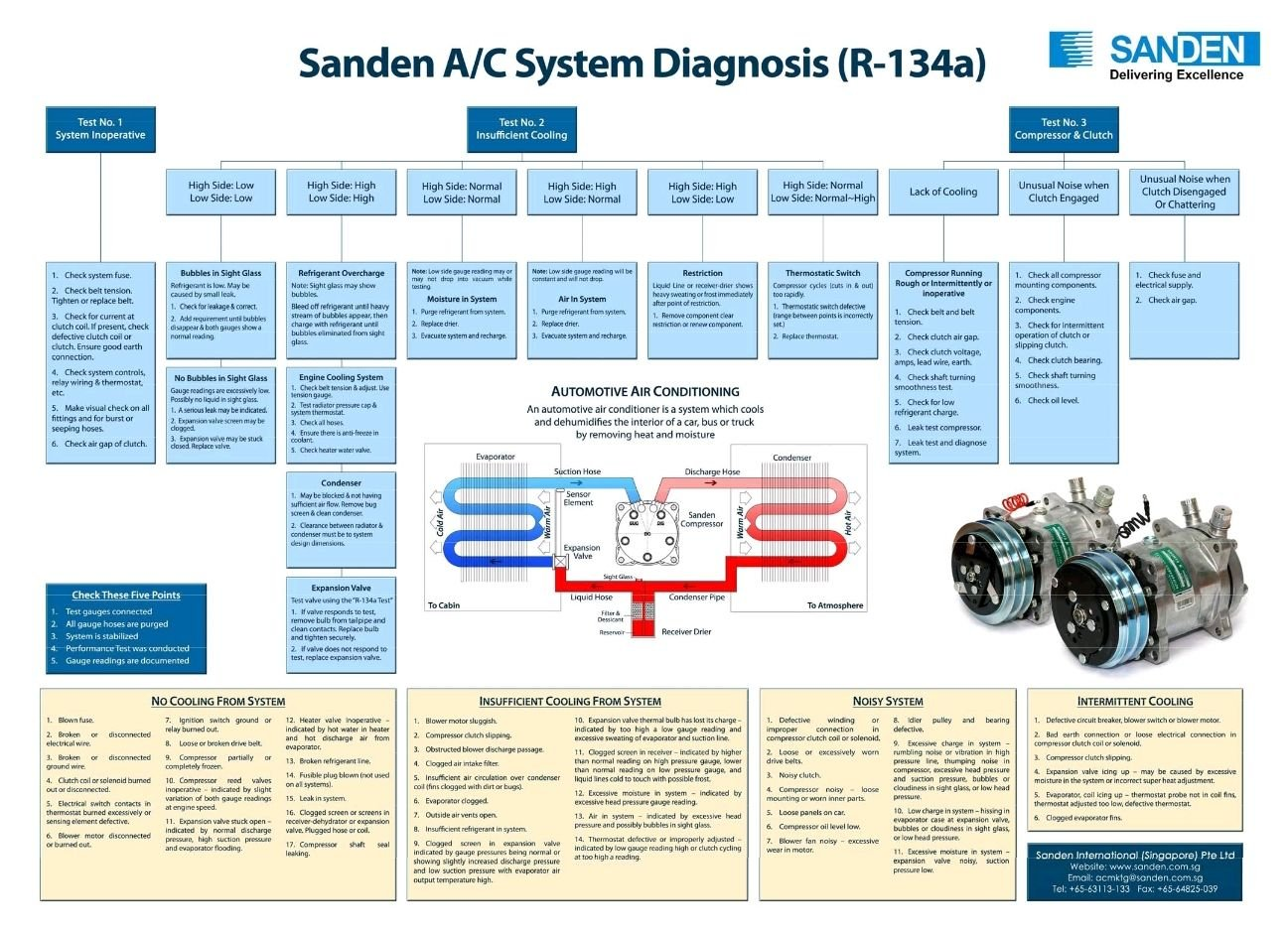

I’ll add a little follow up. When the car is shut off and restarted the AC works…..but only for a few minutes which is indicative that the system is shutting down the AC compressor in order to protect it. When I said the low side AC pressure was high I mean “in the red” on the “top up can gauge”. By top up can I mean the $30 can you buy at Autozone. Typically a low system will read yellow (low pressure) and as you add a bit it will goto that green indicator area on the gauge. What I saw was an immediate HIGH pressure issue in the system and I probably should not have but went ahead and added the contents of my small can to the system hoping the high reading was “incorrect”. After adding the can of r134 no change the system turns on AC works but after a few minutes drops out and trying to activate the AC or Max AC switch the led indicator simply blinks 3 times and you have to restart the engine upon Which you’ll get three minutes of AC until again the process repeats (system shuts down the compressor). Hopefully someone who has seen this before can chime in. Wondering if it’s a block evaporator etc….car has 90000 original miles on a 2014 model year.

Do you have a trouble shooting chart for these kind of compressors, so that you can diagnose the system using the set of pressure gauges. For example,
https://www.densoautoparts.com/troub...ts-compressor/
https://www.densoautoparts.com/refer...oubleshooting/
More important, careful starting a parts canon since you can get into spending $$$ and still have an AC problem.

wrong. Those gauges are a very good indicator of what’s going on (on the low side). I installed for sake of argument my low and high side gauge set when I got home from travel (having used a small
gauge) and it reads exact same. Low side is high and high side is reading low. Thanks to the fellow who posted a chart on troubleshooting. I’ll follow that.

As long as you do not use those can to charge by pressures, you will be fine. Recall you need to be able to know how much refrigerant is IN by weight. Pressures mean nothing about refrigerant quantity unless is ZERO
Here is another chart, more visual and compact
https://nissens.com/Admin/Public/Dow...134A+-+ENG.pdf

Initial pressure immediately behaves abnormal out of range on high side only with an operational compressor upon which after a few minutes the compressors shuts down and system pressures recorded are out of range on high side as well as low side.
the troubleshooting chart available online indicates potential compressor failure or expansion valve. I’ll replace it evacuate the system, run vaccum and re charge it. Wasn’t needing all the information. Take care

Difficult to read the information you provided. I take it as "there is a blockage in the system". If so, and you plan to replace the compressor, you need to flush well the whole system, replace the condenser, drier, compressor, and likely the expansion valve as well. If you do not replace those components, the new parts will fail prematurely.
