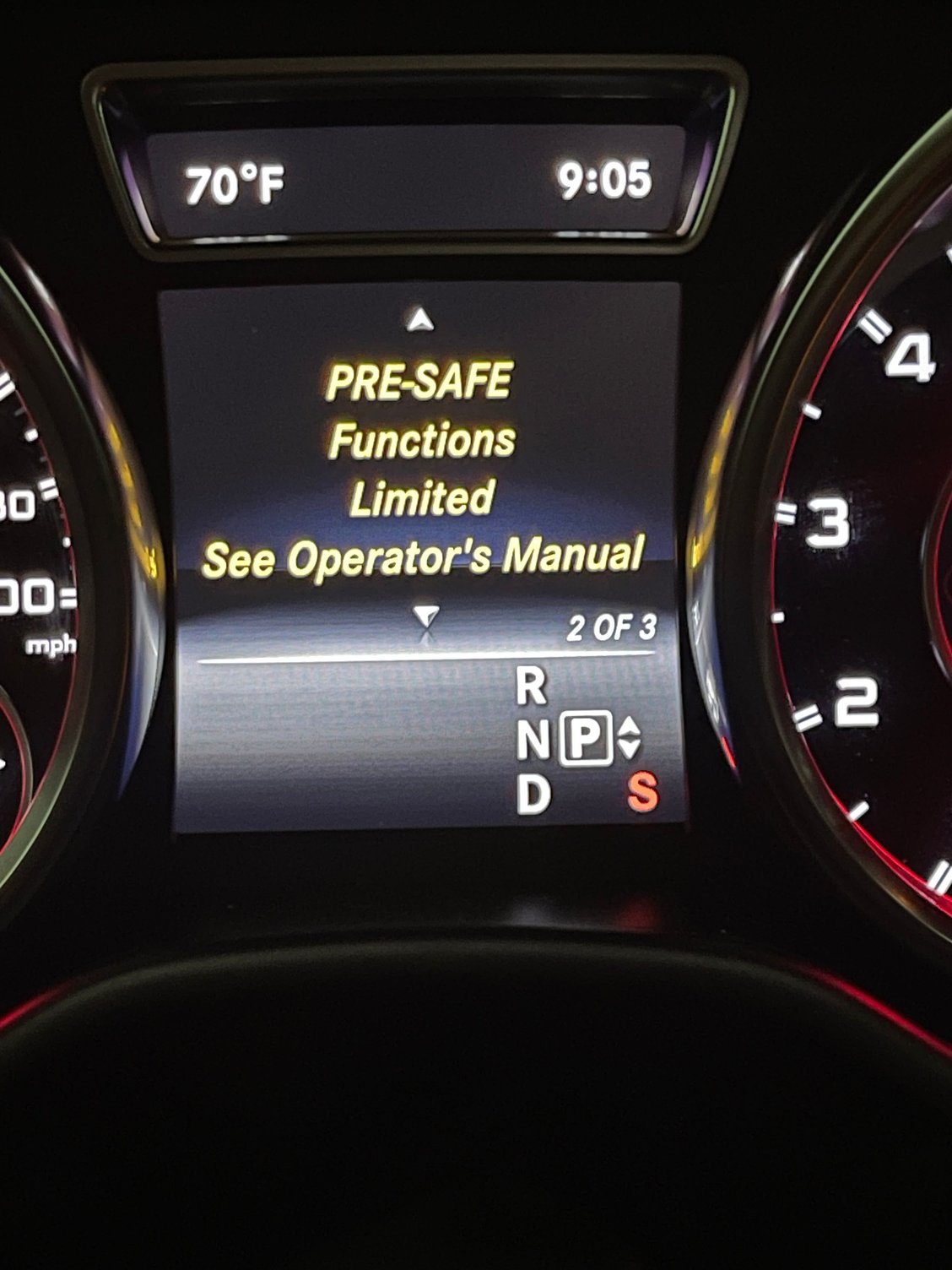

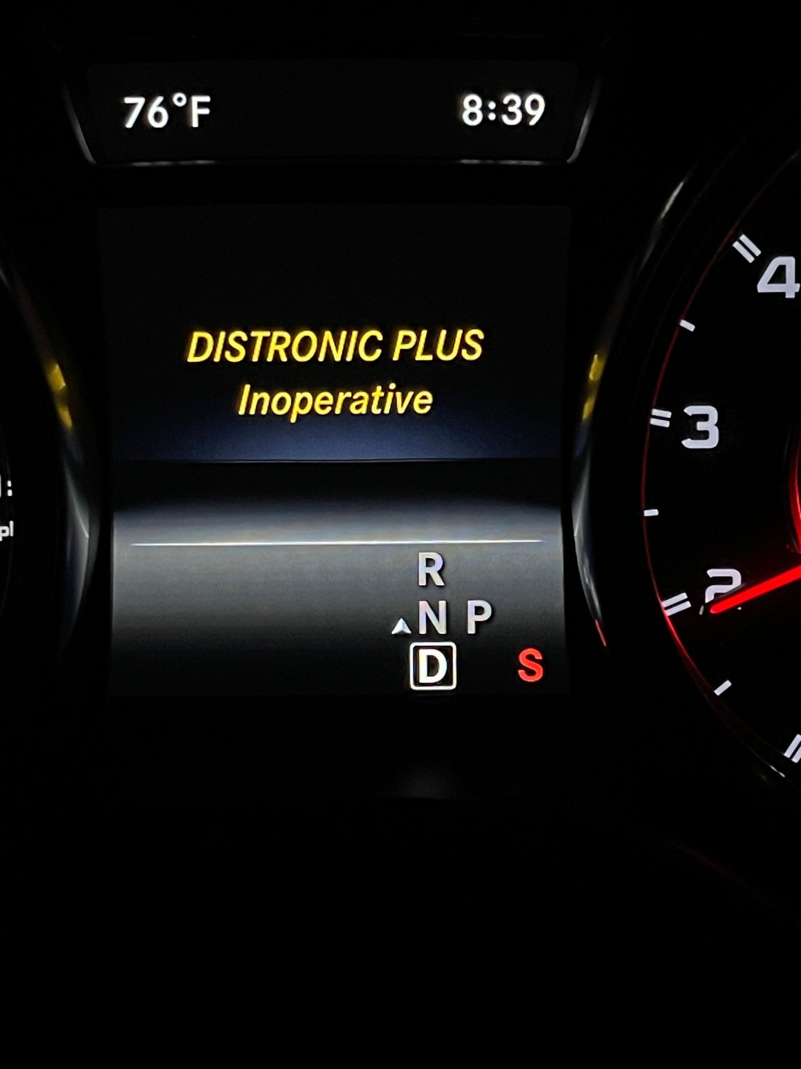

I have a 2015 GL63 (X166) with 108,5xx miles. Recently I started getting the following warnings immediately at startup (within seconds, no driving required):
  • DISTRONIC PLUS Inoperative
  • PRE-SAFE Functions Limited
  • Active Blind Spot Assist Inoperative
I originally had a weak battery, so I replaced it and registered the new battery. Voltage is good (12.9V+). However, the warnings were present before the battery replacement and did not change afterward.

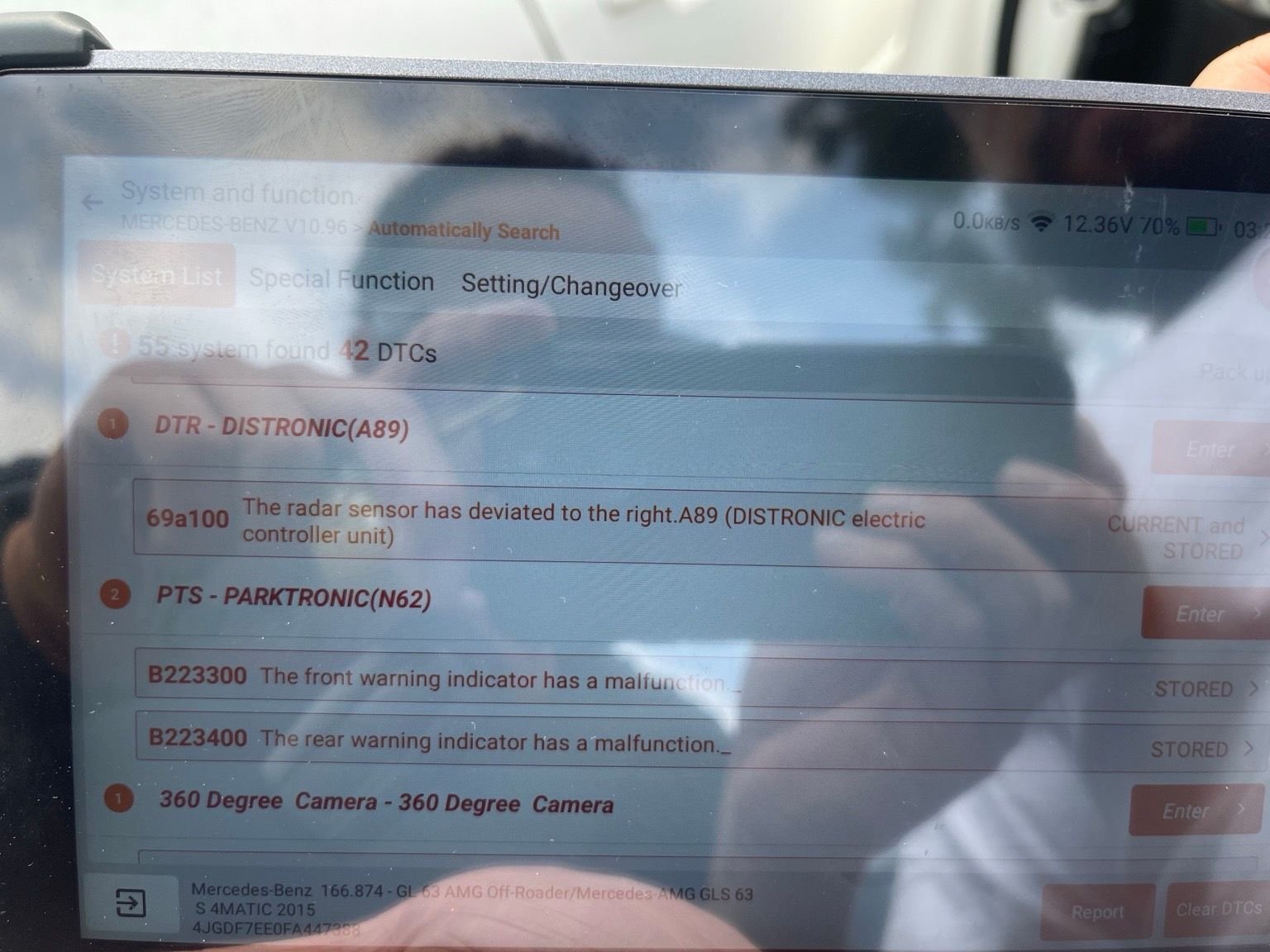

Scanned the vehicle and found:
DTR – DISTRONIC (A89)
Code 69A100 – “The radar sensor has deviated to the right.”

Code 69A100 – “The radar sensor has deviated to the right.” - this is a Fault Code based on history of calibration values changed dynamically while you drive.
First, Faults Codes with " Current " mark can't be deleted because those are "current" meaning still present.
Second, even if you try or even if your generic tool delete this code, the calibration values will remain deep inside the radar.
If you are sure about the radar support (although in 99% of cases the support or the support of the support... is bent...or the front grille is not original) you can try to trigger a new Calibration procedure - this will erase the old values and will start to learn the new ones.
Distronic is a very complex system and is part of the safety feature, so I would not recommend to do any calibration without Xentry.

I can almost guarantee your car has some sort of physical damage. The sensor is located directly behind the Star in the grill. Is your grill damaged or popped loose? Open the hood and look down there at it. The threshold is 3 degrees in any direction. Anything more and you get a code like this. The bracket for it is probably bent. The only cause for this fault would be if you're alignment was insanely out of whack and the truck dog tracks immensely. It's not an electrical issue as the fault doesn't state an electrical open / short / message fault - it says it's aimed wrong.
