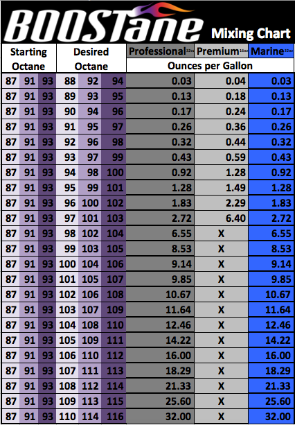

Use the grade of octane gasoline called for by the factory. While you can use say 89 and add an octane booster I think if you research this you'll find it not cost effective.
Boostane is a "good" octane booster and here's a link to a chart that shows you how much octane booster to use per gallon of gas to get the desired octane:
https://boostane.com/about-boostane/...-mixing-chart/
I am *not* recommending you use Boostane. I haven't bothered to check but generally automakers are against any fuel (or oil) additives.
Boostane is good in that it works but it uses MMT. Reports are by those who have used this and then for one reason or another have had to tear down the engine report the additive coats all combustion chamber surfaces with a red colored deposit. Pretty sure this includes the O2 sensors and converter surfaces too.
So to repeat use the grade of gasoline called for by the factory. I'm pretty sure the factory also limits how much ethanol the engine is capable of safely "consuming" so unless E15 or even E85 (this would almost certainly require your vehicle to be a flex fuel vehicle) stay with E10 at a maximum.
