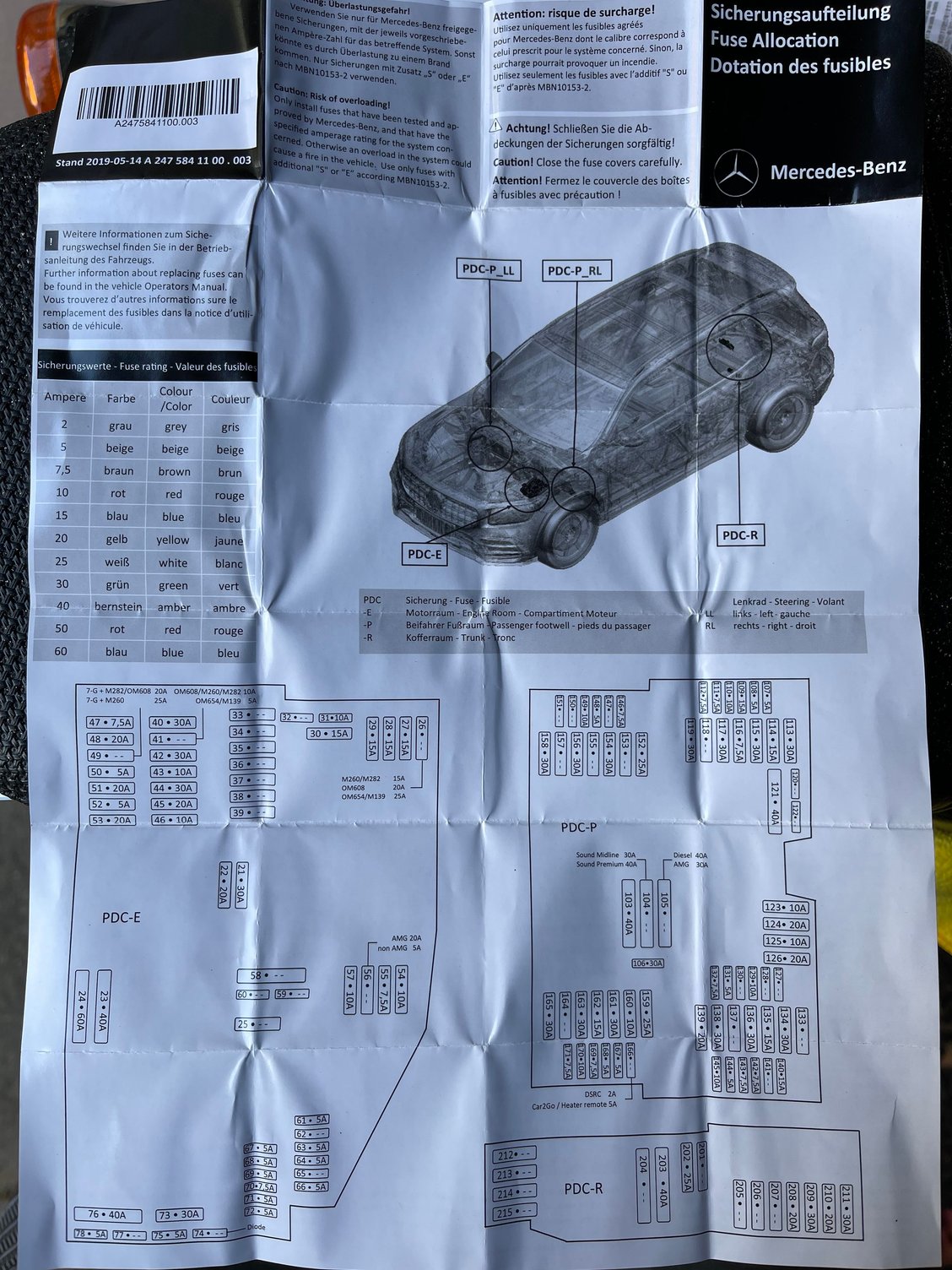

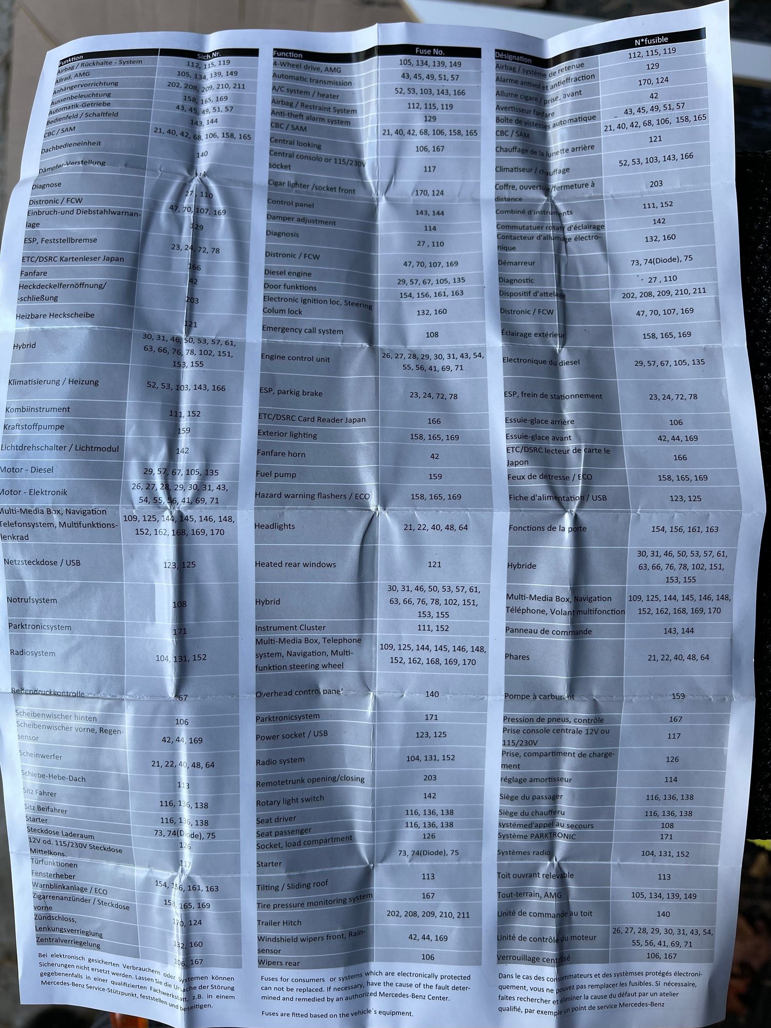

09-16-21 post has pictures of the fuse legend document. You can find it inside the fuse box.
Both battery and fuse box are located on the driver side under your front hood. Box with red tab is your battery. Ground is the brass nut to the right. Fuse box is to the right of the battery.

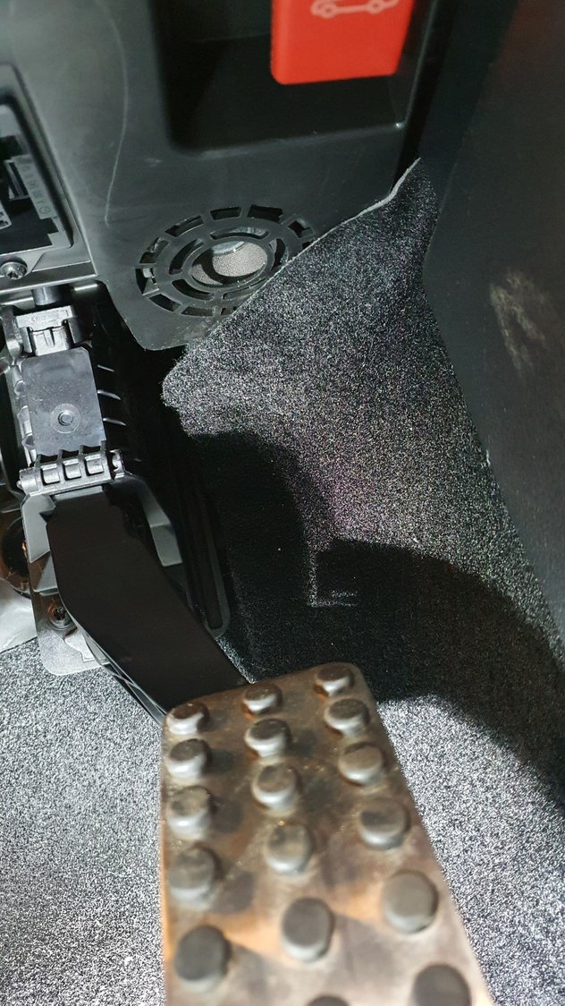

I found a small speaker (about 5cm across) in the footwell - if you lifted your foot up you would pretty much be on it.... I wonder if these are the speakers the sound comes out of?... there doesnt seem to be any sound from the audio system through them
If so it would be easier to just disconnect them.....

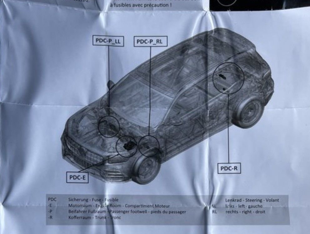

There are 3 fuse boxes. One under the hood, one behind a carpet in the passenger foot well, and one in the trunk. Although I am not sure of the exact location of trunk fuse box.

From Vtek's post above:

no, you misunderstand, they are not in the back, they are in the front footwells directly above your big toe if you were to put your feet at 90 degrees to your stretched out legs

there only APPEARS to be a speaker in the drivers side...it's a bit difficult to get to when you're 63 and have arthritis
pic attached
Maybe I will disconnect it and see if it stops the childish noise

P.S. I was wrong and I do have a speaker in the footweel. I never looked there nor I ever heard any sounds coming out from it.
