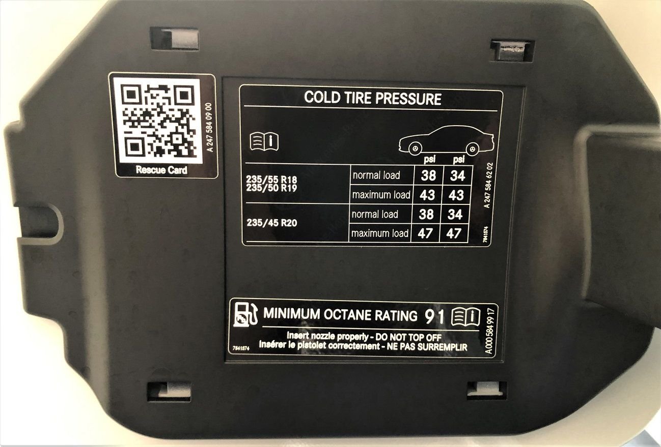

Hey folks - Have a GLB250 with 19" rims. What air pressure are you filling in your tires? Get this, on my door jamb there's two separate stickers giving the tire pressure and one in the gas tank flappy thing. Gas flap says 34 PSI for normal, 43 PSI for max. Stickers in the door jamb say 43 for cold but doesn't specify if normal or max load.
My car is never loaded up...but should get better mileage at 43. What are folks doing here?

Use the tire pressure from the gas fuel door:
https://mbworld.org/forums/glb-class...-pressure.html

GLB250 7 passenger with 19” Continental ProContact GX SSR (MOE) — gas filler door 38 psi front, 34 psi rear for normal load.

I was looking into this now I switched to 19" wheels with non RF 255/45R19 Michelin PS A/S 4. GLB35 requires 35/33 for 19" wheels. Tire installation was done in evening, so tire air pressure was even lower at 34/32 in the morning. It is much more comfortable and a little floaty compared to higher psi. I was leaving 20" winter wheels at 38/36 following GLB250 recommendation rather than GLB35 after 21" OEM wheels had road rash at manholes when the dealer dropped its air pressure below recommended 39/35 psi.
Here is GLB35 recommended tire pressure, 19" has 235/50R19 (RF) and 20/21" are 255/40R20 & 255/35R21 (non RF):
