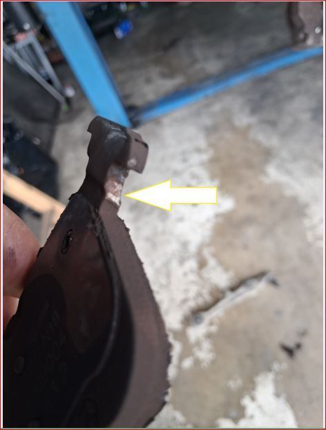

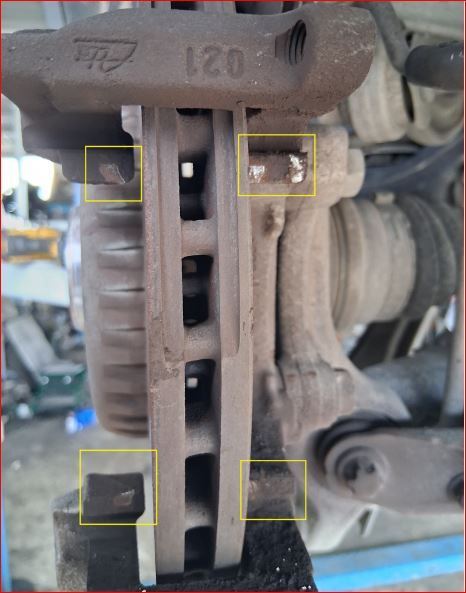

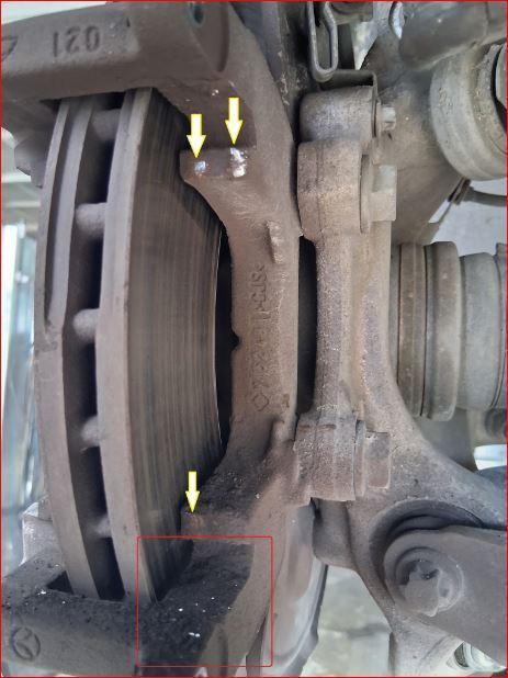

During replacement of all brake pads,it was noted, that there were multiple areas seen on pictures,
where brake pads directly contact in brake caliper. In GLC(X253) there is NO stainless steel anti
rattling plates. If You take a look at design of brake pads for W213(E class) it will be noted, that
there are specific stainless steel plates, preventing or reducing friction.
Sorry to say, but for me it is 100% clear, that MB just saved few dollars and ruined the image
of the brand, because noise is coming from design flaw.
I applied copper grease in contact areas and there is NO noise in both cases-forward and reverse,
but this is a temporary solution. To apply grease to inner contact area is relatively hard.
I accepted that, it is NOT possible to solve this problem.
