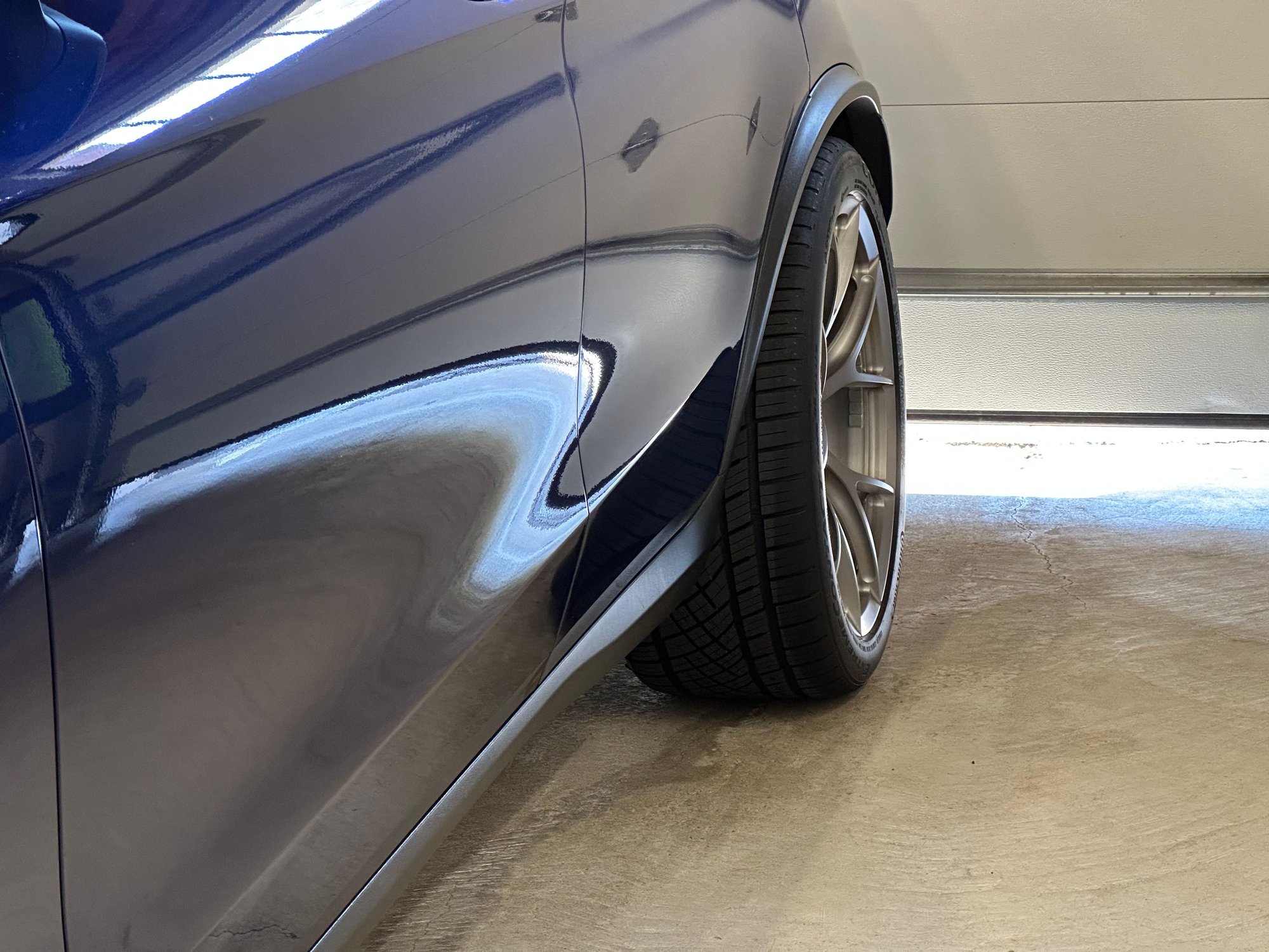

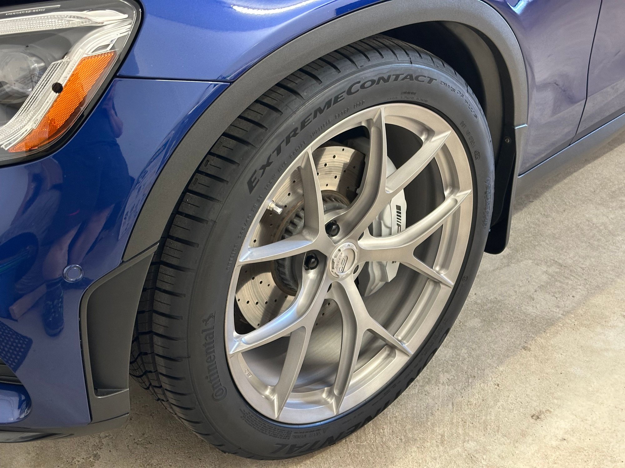

I went 265/40/R21 front and 295/35/R21 rears and they fit perfectly. They do not rub at all and I am lowered 30mm all around.

sorry for the big pics
