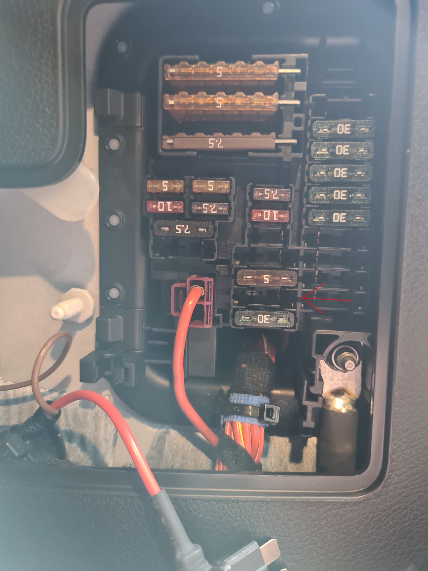

Can someone post a picture how the driver fuse compartment looks after hard wiring your dashcam?

Hi all,
Here's what the driver's side fuse panel looks like on our car (apologies for the large photo from my phone):

Hi Oskidbear, thanks for your help. I use the same positions, but I think hou have the right fuse tap (position 216) the wrong way around?
I measured that the 12V is on the left side from fuse 216. So with the fuse tap positioned as you pictured the fuse does not work?
Am I right?

I used post #1
Hi tjerkpolle,
When I installed the add-a-fuse to position 216, I followed a photo from HeroAychillus's post (#1) for orienting the fuses.
It seems to work, as the camera starts up when we start the car & parking mode did run correctly when I tested it (though I should test it again).

@oskidbear Yes, but the way I positioned the fuse tap it also works.
@oskidbear @HeroAychillus Guys maybe I 'am wrong.
But I measured the Fuse position 216.
I measured without the fuse/fuse-tap in position the feed is on the left side.
In the pictures/schemes I also post you can see how the fuse tap works.
I think the fuse from the fuse tap in second position for the dashcam does not work. I think if you pull out the fuse from the fuse tap you still get signal with ignition on and that is wrong??

Hello tjerkpolle,
Regarding the correct orientation of the add-a-fuse in position 216,
You could be right. I'm definitely not an expert on electrical systems.
When I installed my add-a-fuse at 216, I used the following to guide me:
  • photo from post #1; &
  • maintaining the same physical orientation of the original fuse from 216 as if there was no add-a-fuse (current rating reads upside down when installed; does this matter for a fuse?)
Is this incorrect? It wouldn't surprise me if it was, but the system works so far. I'm definitely not the right guy to ask why...
When I get some time next weekend, I'll pull out the fuse from 216 to confirm whether I still get power to the camera. Should I pull the original fuse from 216 or the one for the camera?

You should pull out the fuse from the camera. When you still get signal something is wrong.

Camera did not turn on when fuse was pulled
Originally Posted by tjerkpolle
Hi, maybe an other forum member can help here?
Hi tjerkpolle,
I got a few minutes today to pull the camera fuse from the add-a-fuse I installed.
Before I removed the fuse, I pressed the start/stop button to turn on the car & the dashcam turned on by itself, as it normally does.
After pulling the fuse, I pressed the start/stop button to turn on the car & the dashcam did not turn on.
Still not sure what it means, but the dashcam works the way I want it to.

This pic is like our 2020; there is nothing there in the 216 slot, not even a usable slot to stick a fuse in. Now where to tap for a radar detector that’s not hot?
