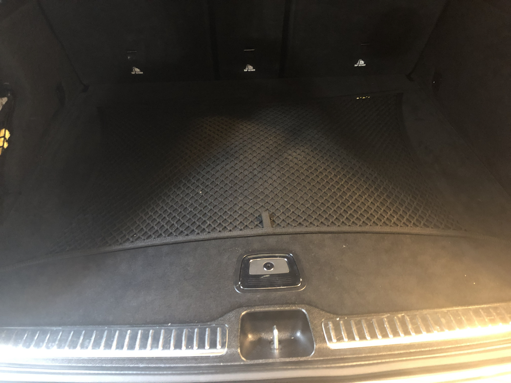

Hi, so the trunk (broad cover) closed perfectly right?

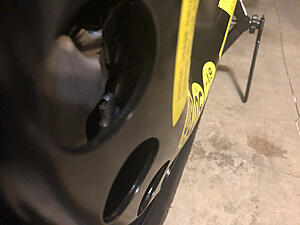

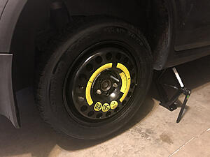

Here's a picture of the factory spare. It comes with nice white gloves tucked in the side to not dirty your hands while changing the wheel 😂

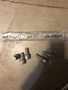

and now to the lug bolts..... the ML350 are M12 x 1.5 but the GLC300 are M14 thread..
All MB's SUV (except for 2020-on GLE/GLS which now use 15mm bolts), including all generations of ML350, use M14x1.5 bolts (not 12x1.5).

Well I purchased a MB pare tire(ML350 series) A1644000002 and a Jack tool kit from MB they are both shipped.. once I get them, I'll update on fitment... ( i hope it fist like the others have said)
Now I need 5 short lug bolts..... but I'm confused on size.. ML350 specs called for M12-1.5 but the my 2019 GLC 300 says lug bolts are M14. M14-1.5 size are hard to find.. ???

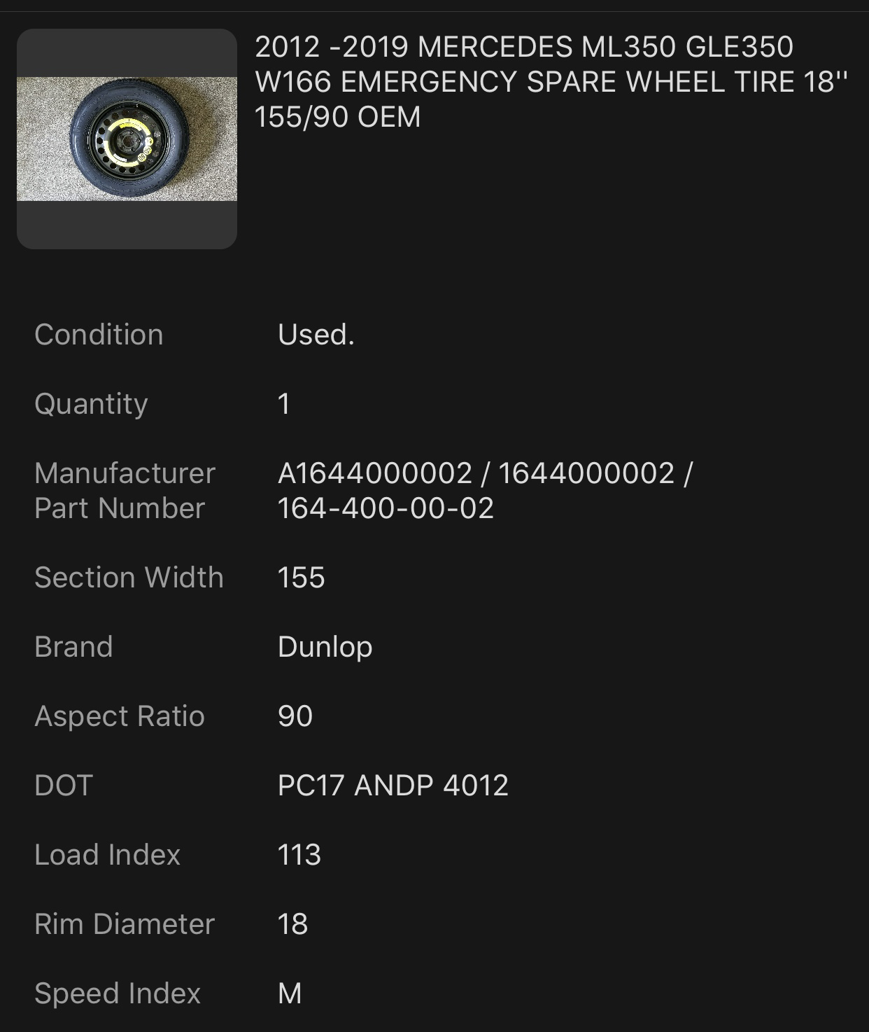

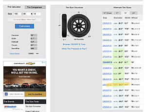

Thank you for taking time and share this information , just quick question
Is it really 80 in size of A1644000002 155/80/18
Everything what I could find T155/90/18
for the part A1644000002 ? Thank you.
Dan,
My apologies it is indeed T155/90/18 I think the A1644000002 might actually be the steel rim part number but it still leads to the over all spare tire on google search.
Look locally at salvage yards that have ML350's your save a little I got mine off of Ebay free shipping $105.00 unused off a 2015 ML350 Take your time in searching.,, make sure you get the actual tire pictures before you buy it verify it's condition.
Good Luck

Thank you for checking.

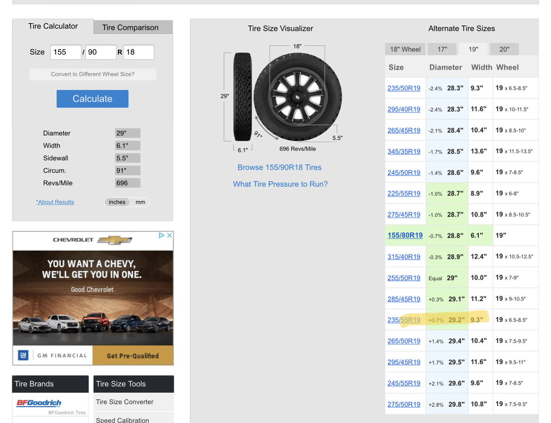

I just bought one of ebay, looks like diameter is in the spec with original 19in rims.
I really hope it will fit under the lid, will report back when its get here.

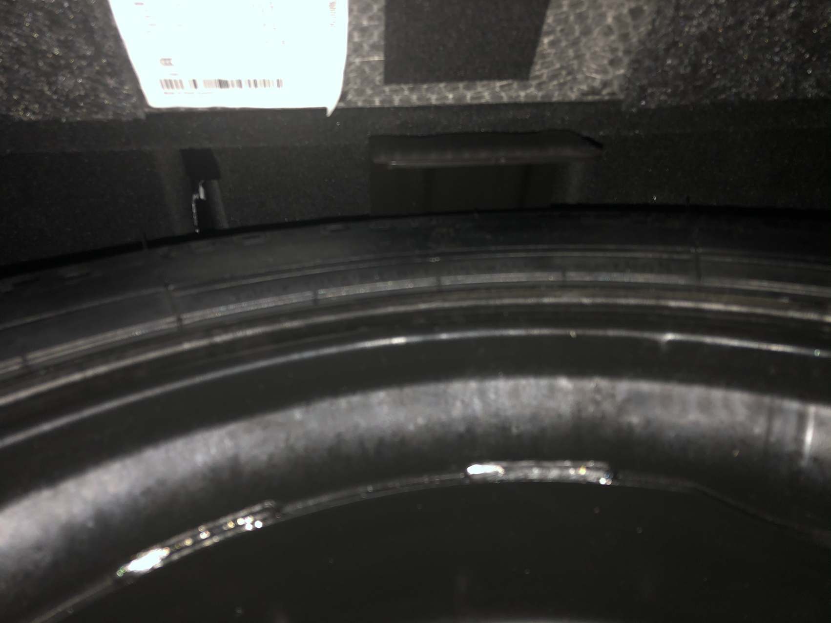

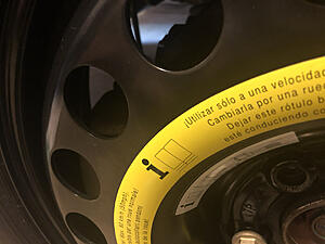

Hi All,
Thank you all who provide feedback, because of all of you, I was able to get all and its does look good, so now is my turn to provide the feedback.
It does fit under the lid with other junk no issues.
Here is my setup,
Spare tire
MB Vehicle Tool Kit
Part #1665806900
