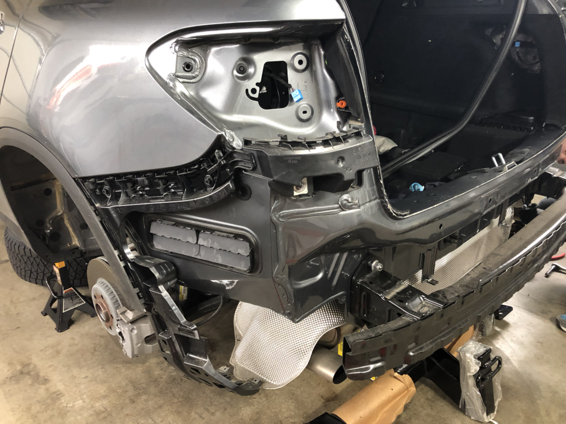

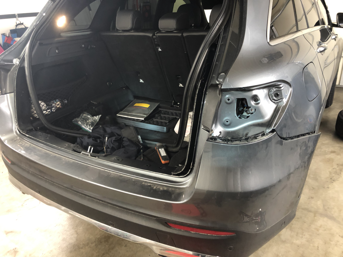

Remove bumper shell starting from the side
And 3 bolts from the trunk.

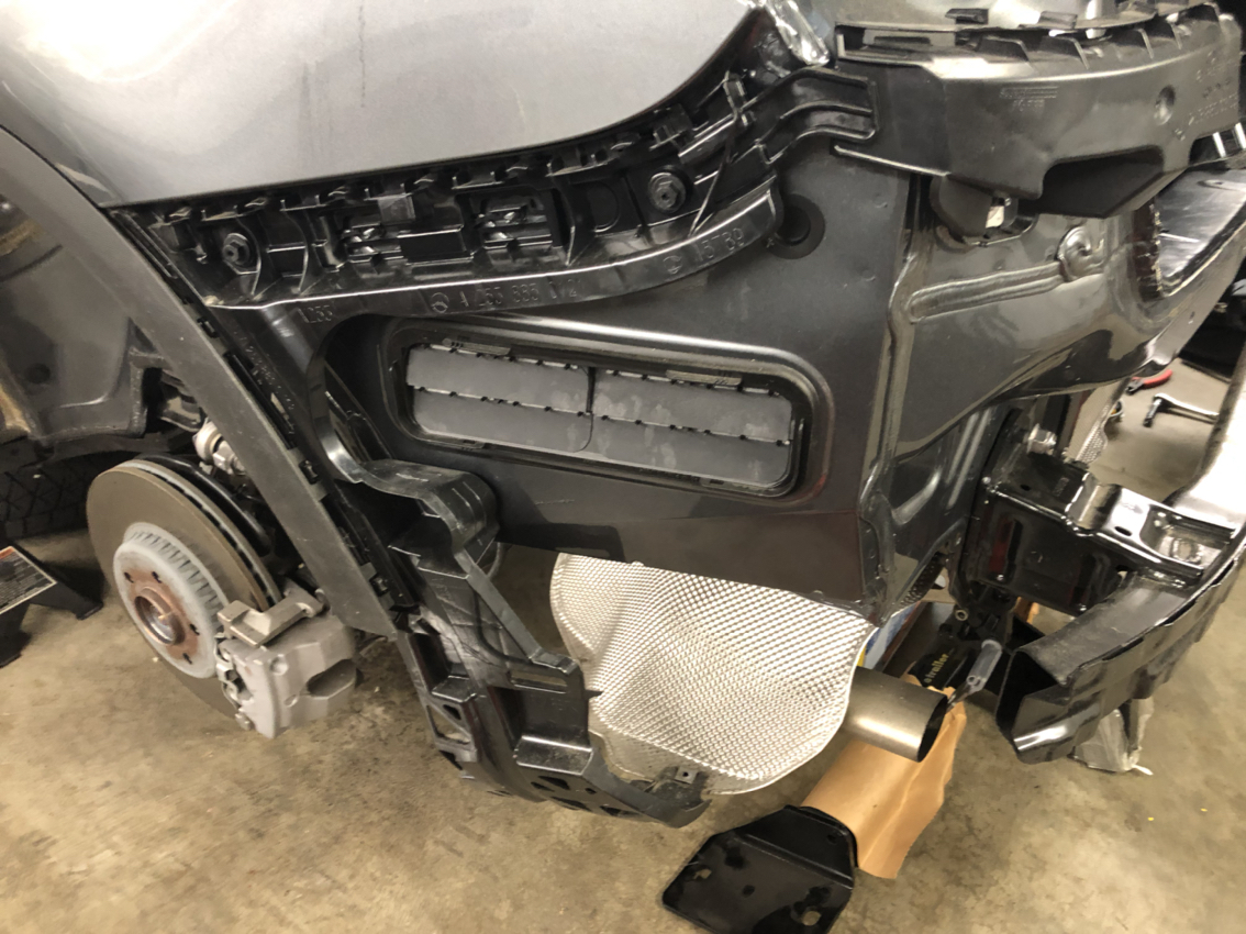

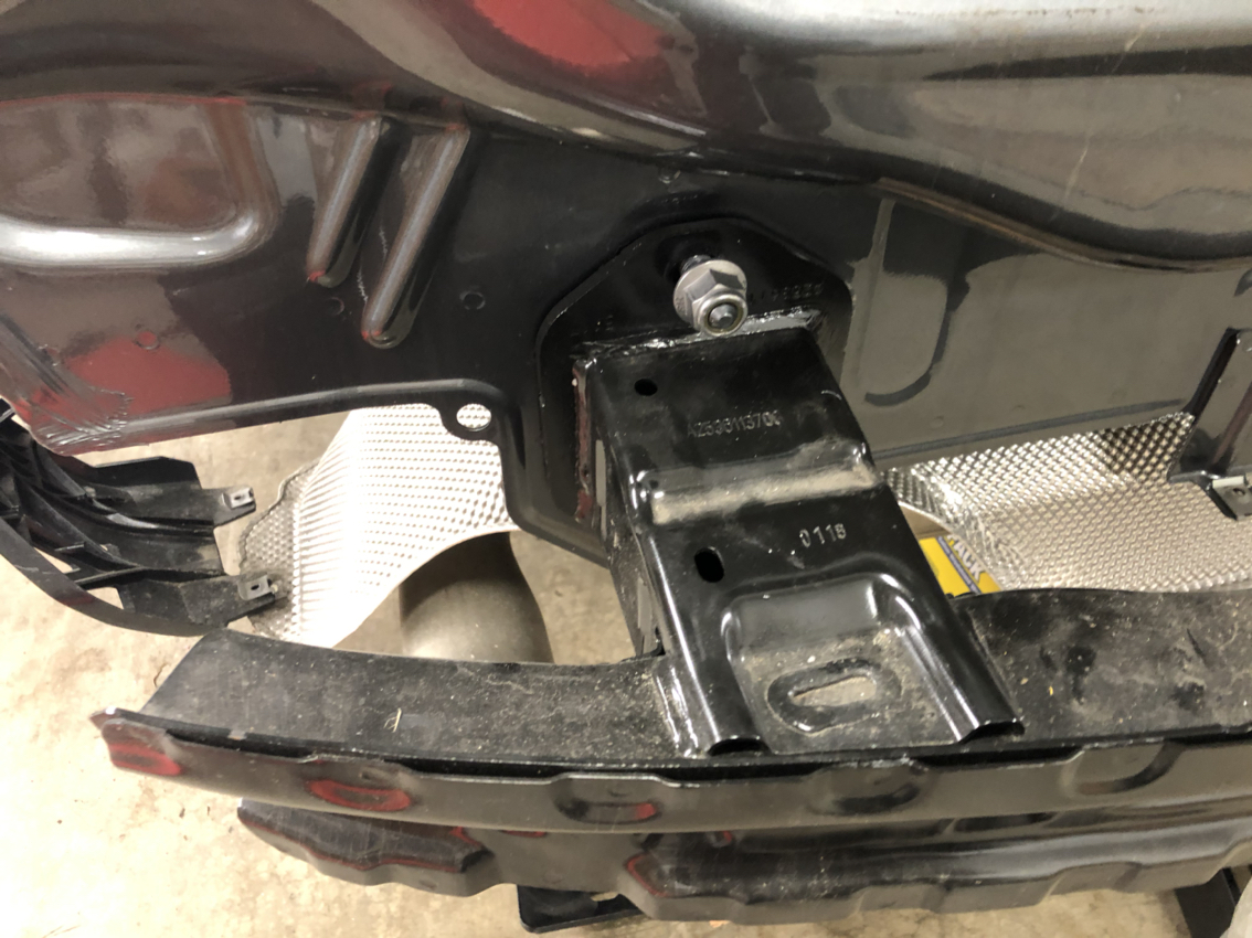

Remove this part, it will go over the hitch
Install hitch and install all parts in revers order.

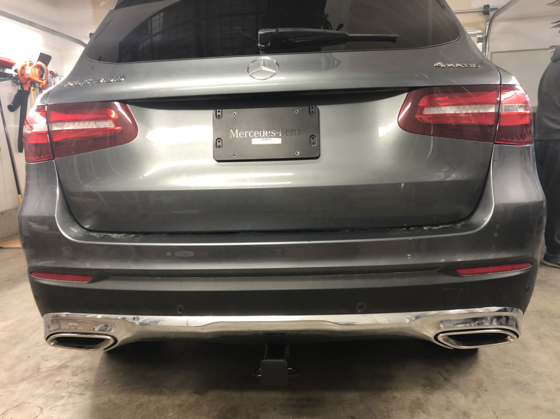

At the end all should look like this.
Its about 4-6 hours process.

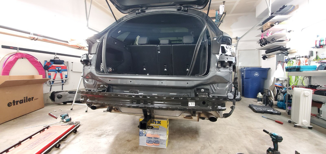

lol, I know the RainX is just propping the exhaust system up a bit, but that one pic looks like its holding the hole car up!
On the pics above car is actually on regular jack stands. ))
