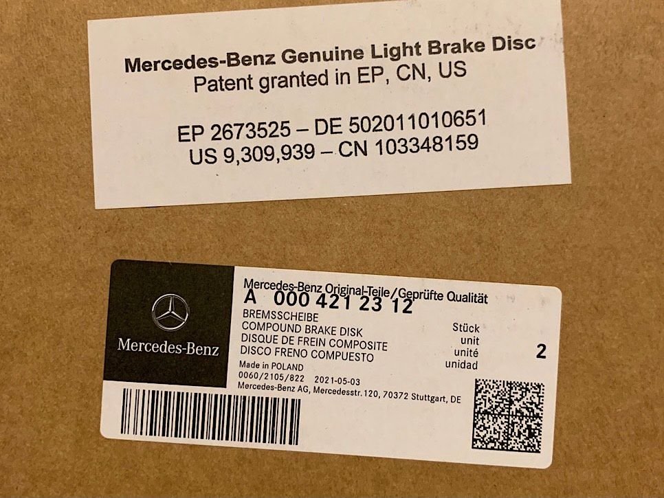

Following up on this for posterity because I dug a little deeper online and by process of elimination I think I found the right rotors and pads… Hoping to install them this weekend or next, at the latest.
One other question for the group; does everyone sand off the coating on new rotors or just let it burn off when you bed the pads?
These rotors are f-ing huge BTW. This is the first time I’ve replaced them since I bought the car in 2017 so I’ve never seen them off the car. Simply massive for a non-race vehicle. Pads are huge too.
Edit; These are the parts I ordered…
Front rotor
https://www.fcpeuro.com/products/mer...mer-0004212312

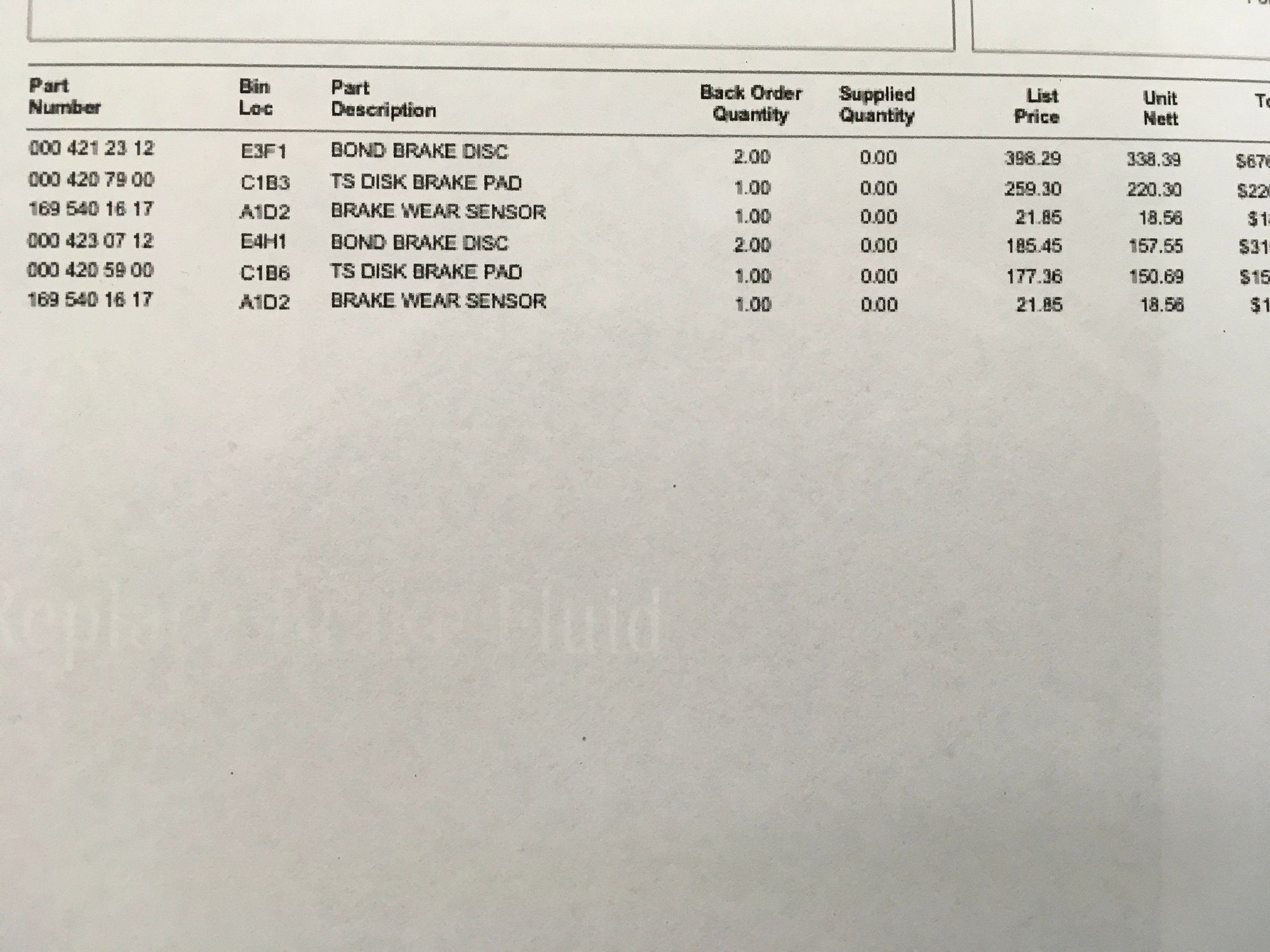

Hi, here is a copy of my prices for the parts.
Ask what the Dealer labour rate is - some here are $220 up to $340 per hour.
Hope this helps
Are these pads ok for sports pack? Part numbers differ from ones Grey Matter listed 0004205000.

Hi, not sure - ours have AMG pack and drilled front discs, larger brake area, hence AMG type 20” rims for clearance.
Always give your Dealer your VIN so they can generate a quote for your car build.
These parts suit both 2016 and 2017 of our vehicles.
MB do issue new updated to part numbers to allow for design changes. This happened I believe with some front pads due to screeching issues where sides were modified.
MB also use same parts for a variety of models across CLC, C Class and other models to same on inventory and parts design.
If there is only one Dealer locally, try emailing some other ones in your Region, asking for detailed quote for parts in Spares and a quote to Service for labour to compare.

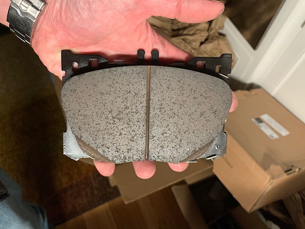

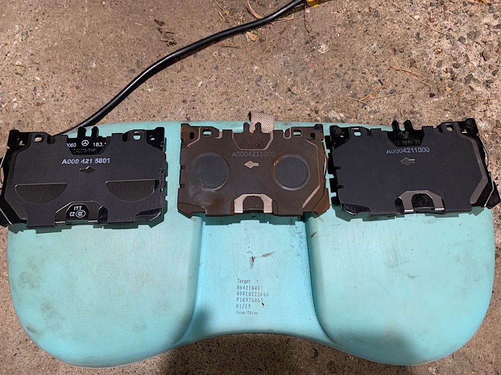

Hey gang! Responding to clarify a couple of things...
Attached photos show the p/n's for the pads I used front & rear.
To clarify; I called the dealer after I ordered them from FCP Euro to confirm I had the right p/n's. (Didn't want to get halfway through the job only to find I had the wrong parts!) They told me the rotor was correct, but the pads were wrong, so I purchased the pads from them, only to find that the front pads were not identical to the ones that came off the car. (Photos follow; Left pad is the dealer-sourced part; Center came off the vehicle; Right is from FCP Euro.)
Ultimately I replaced the fronts with the FCP Euro pads because they were identical both in profile and the part number on the back.
That said; The dealer used my VIN to look up the parts, and while the pad may not be identical, it might have been updated and that's why the p/n wasn't the same. I think they would have been fine to install because the shape and thickness was the same, although it didn't have the slit in the middle, but as I already had the pads from FCP I decided to install them ILO paying return shipping. Dealer is 20 minutes away so I just returned them.
Rear pads were a different story... FCP-ordered pad profiles were different, and the numbers weren't correct, so I went with the dealer pads. I'll be returning the rears to FCP.
BTW - Replacing the pads was a piece of cake. One word of caution on the rear pads; Make sure you disengage the EPB (Electric Parking Brake) AND put it in service mode or you won't be able to push the piston in. There are videos on YouTube for this.
Hope that helps anyone else DIY-ing pad replacements...
