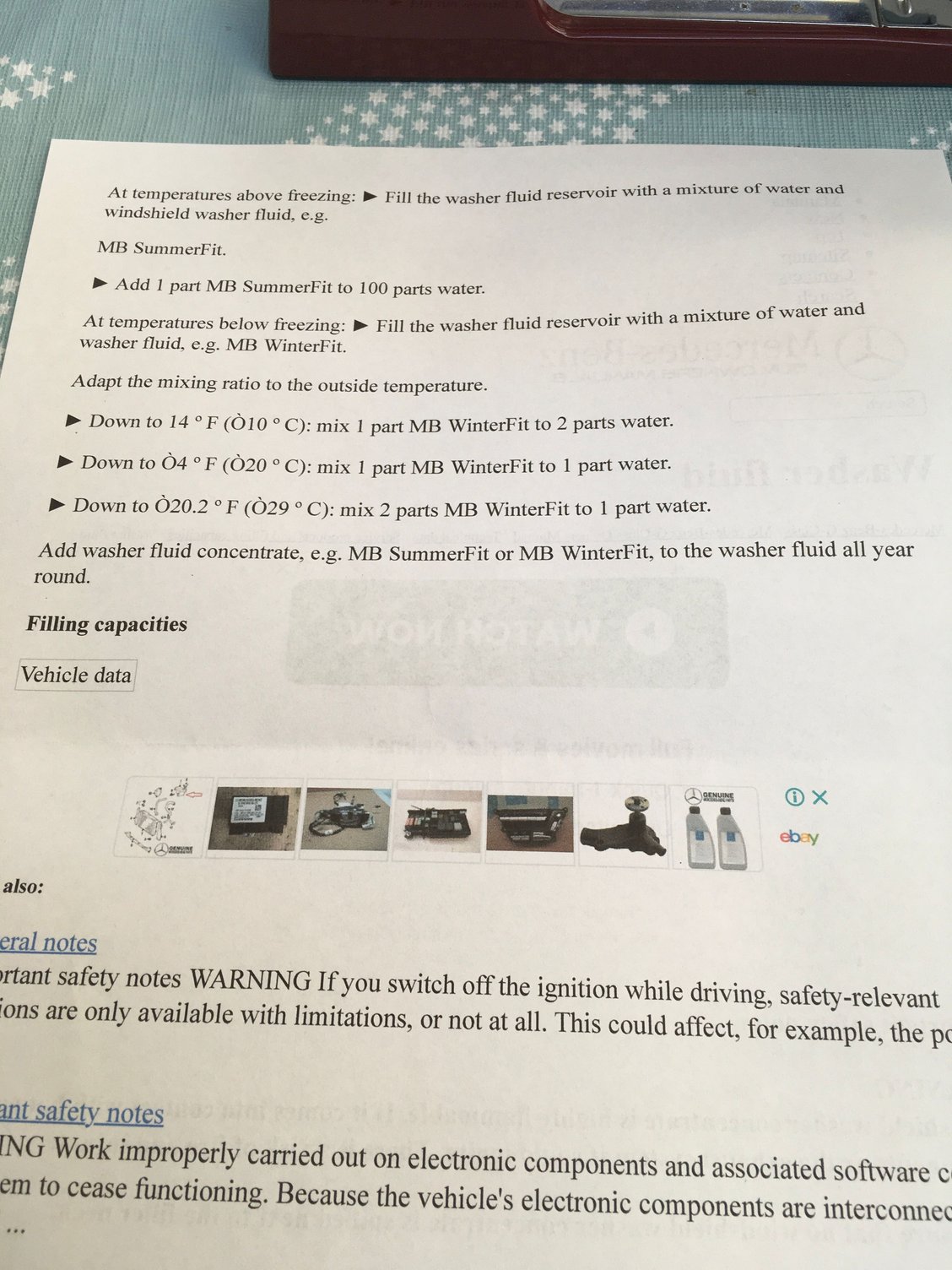

Found this link that could help.
http://www.mersuv.com/mbread-884.html.
Do not add distilled or de-ionised water to washer fluid container. Level sensor may be damaged……

It is a bit too much to premix washer fluid. Not sure elsewhere, but in Canada, ppl just use premix for winter, even the dealership.
​​​​​​Its function is not only freeze protection, but corrosion resistance. 'Not adding' the prescribed coolant can void the warranty.
Also added salt (recent post) can void the warranty, because it's corrosive on its own.

I bought the Mercedes winter fit and it said to dilute with water. I did and I’m getting the message too. This is bananas.

Originally Posted by QueenKeKe
I have a 2017 GLC 300 and also used the same Reflex washer fluid and got the "check washer fluid" message. Added 2 tbsp table salt and the message also went away! I just did this last night and this morning when driving to work, message gone!
It's best to flush your system and get that corrosive stuff out of the system. Warranty killing or not, it eats expensive stuff.
​​​​​​The salt just proved that your antifreeze was too diluted.
