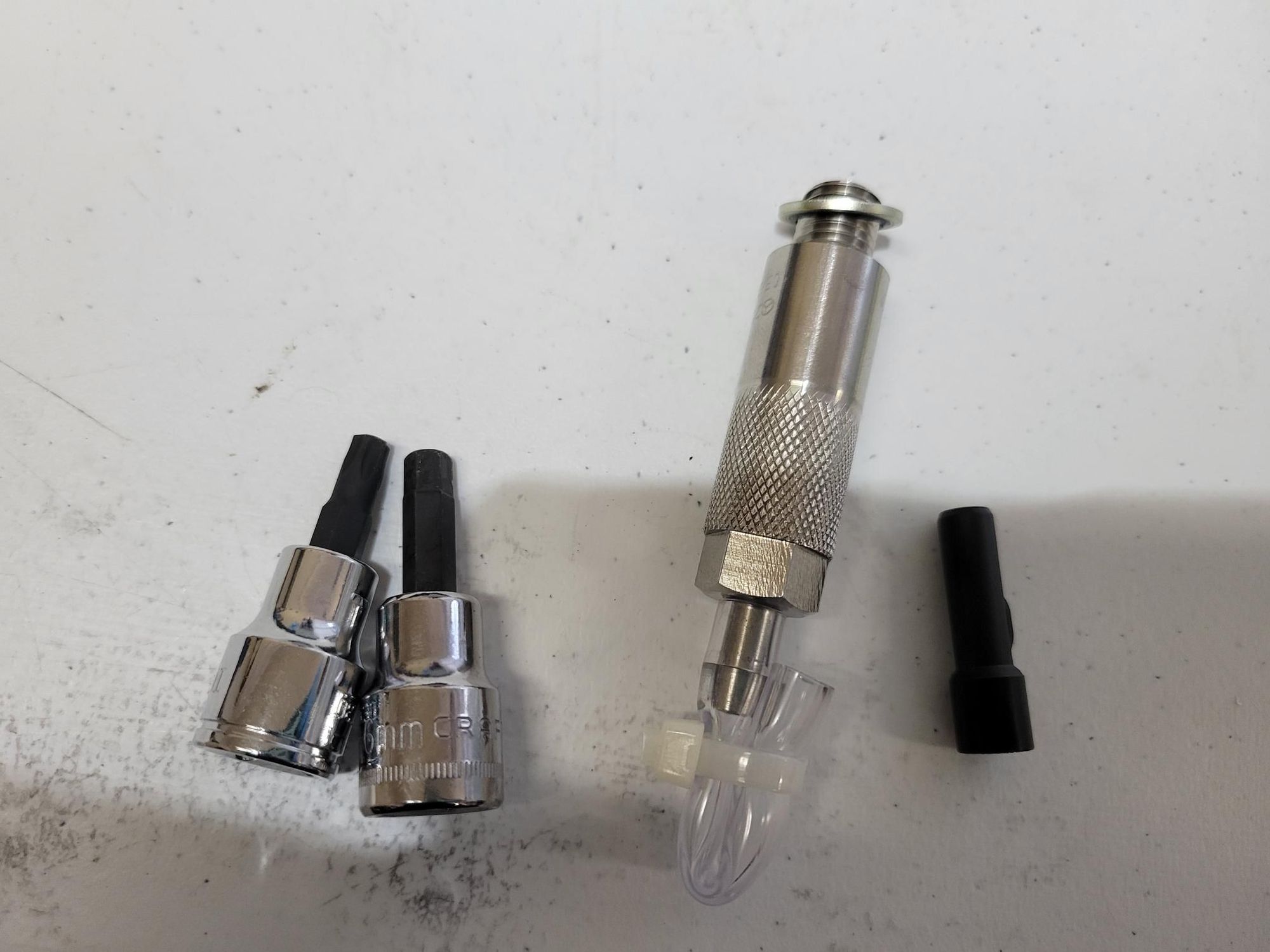

I did it last weekend. The tools you will need. 6mm hex, torx, the adapter and a new pipe insert. I also had a new drain bolt. Instructions says to replace with new one each time.
I used Liqui Moly 1900. Thats what came up on their site

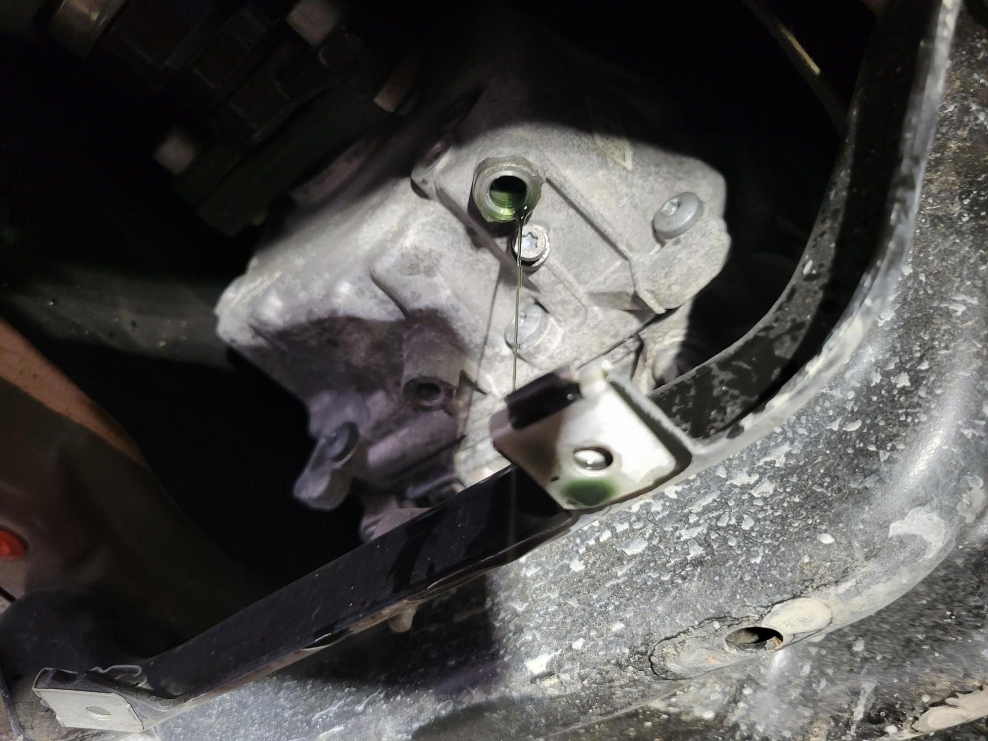

Then just loosen the screw next to the drain bolt (torx), then the bolt. Only a little fluid will come out. Remove the plastic tube, and a lot will come out. Its a mess. I used a little allen wrench I cut and bent and that worked well for the tube.
https://cimg0.ibsrv.net/gimg/www.mbw...9372d3ae7f.jpg
https://cimg9.ibsrv.net/gimg/www.mbw...e47afcf03b.jpg
