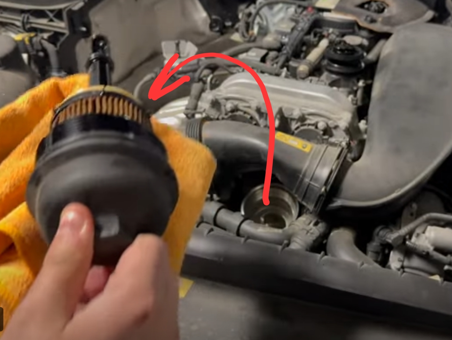

If your oil filter is inverted on the engine bottom, and if your filter cover has a drain plug, this is an easy way to get less than a liter removed. The oil drain plug also works, but getting it back in against a surging stream of oil can be difficult.
Old Feb 21, 2026 | 01:08 PM
no_mulligan's Avatar
Joined: Apr 2007
Posts: 311
Likes: 73
From: Richmond, Virginia USA
'12 E550, '10 ML350, '06 E350, '20 GLC300, '21 GLC300
The oil filter is too mounted.
Attached Thumbnails Removing some oil from the oil pan, can it be sucked out?-screenshot_20260221_130526_chrome.jpg
