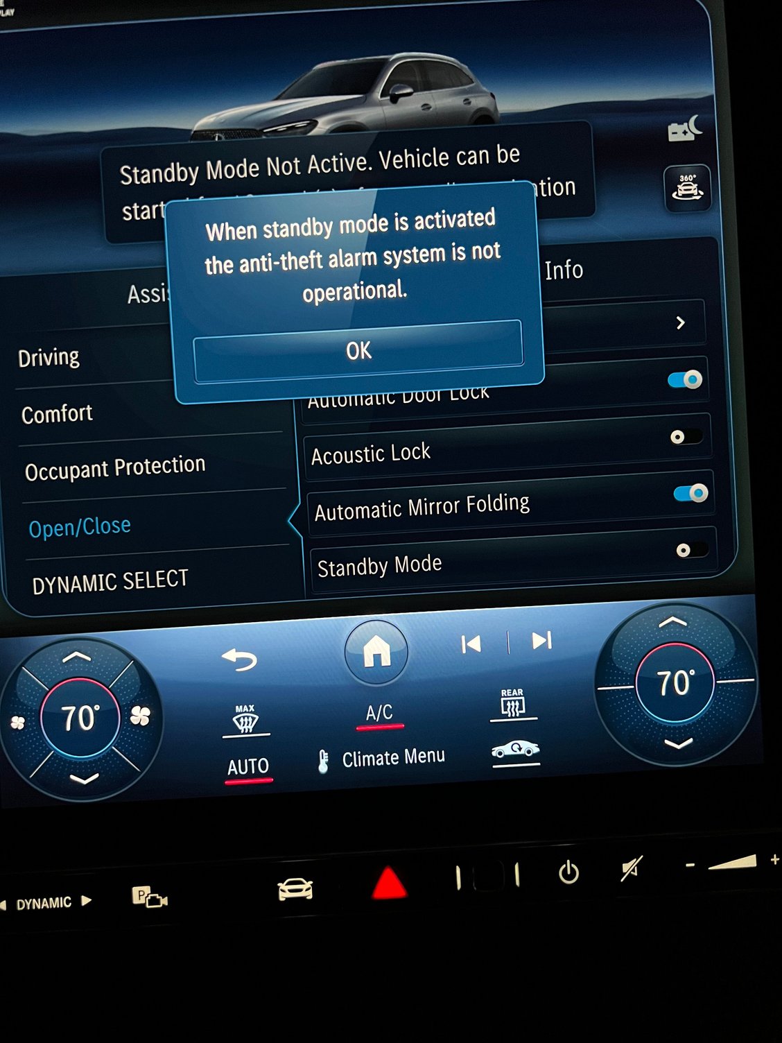

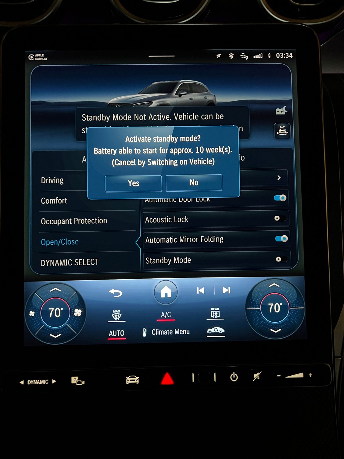

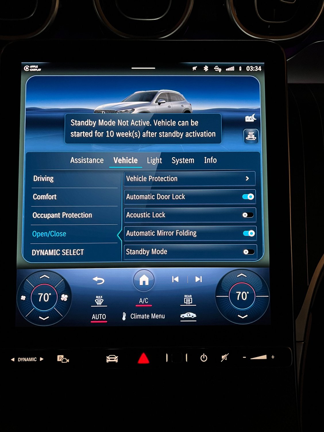

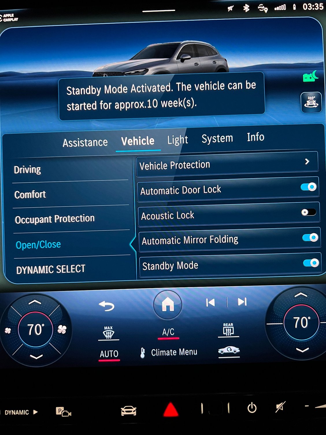

Thank you superswiss for your very much appreciated information. Surprising that the battery information for your 2019 holds true for my 2023 GLC. I had thought it was a new problem just for the x254 cars. I hope MB clears this up soon. It is not something one should have to worry about with a new car. Here are some screen shots for activating the standby mode. Your 21 week activation is surprising. The most I have been able to get is 12 but still a good length.
Screenshots are in reverse order.
