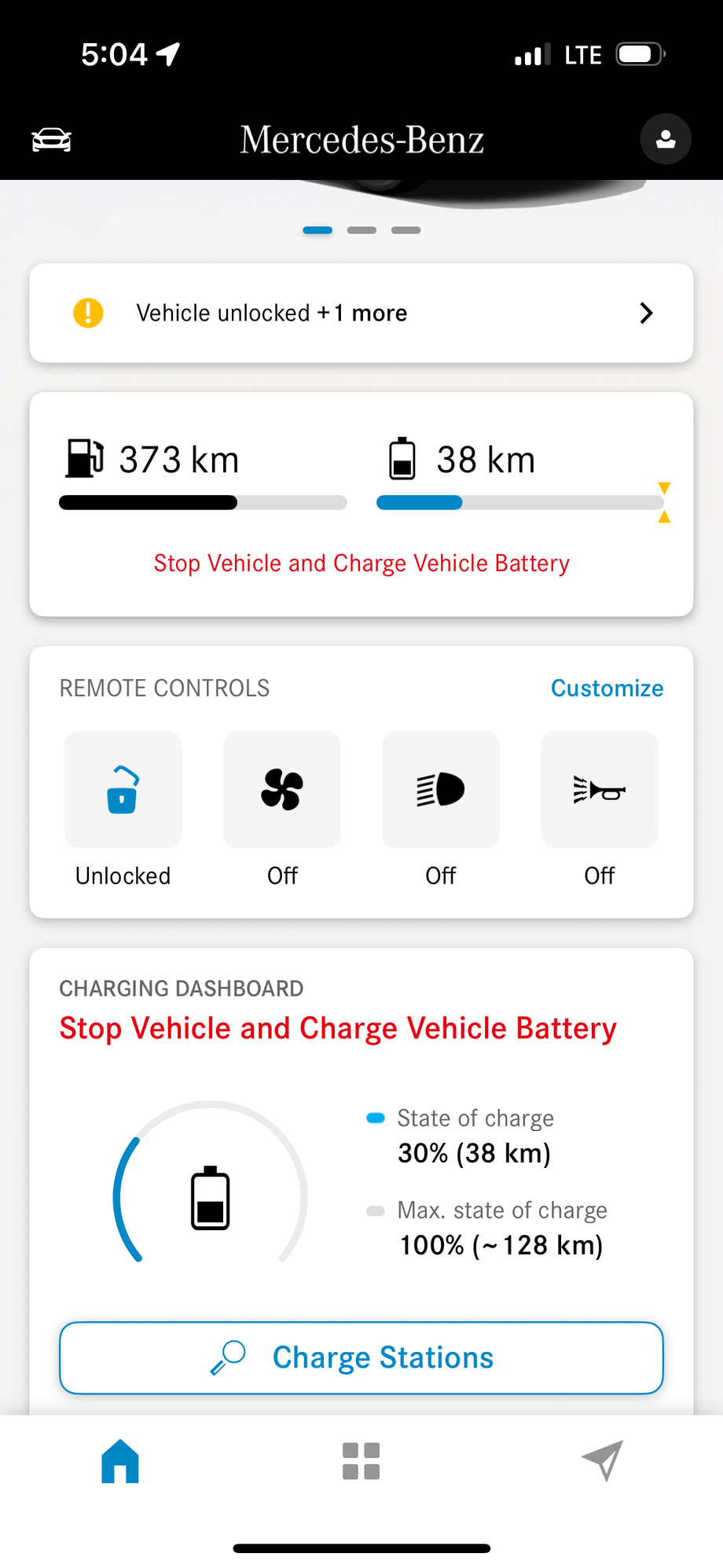

Just checked on the phone app and it says it's set to max out at 80%...but the car itself says 100%. Also, I can't see in the app how to change the maximum. I'm not so good with apps....
I have attached screenshots below. If you hit the little grey box where it says "Max 100%" you'll get a drop down menu that allows you to change the max percentage. This of course only works when the battery is lower than your set percentage so you'll need to use up your fully charged battery before you try this

Old Jul 5, 2025 | 11:54 PM
