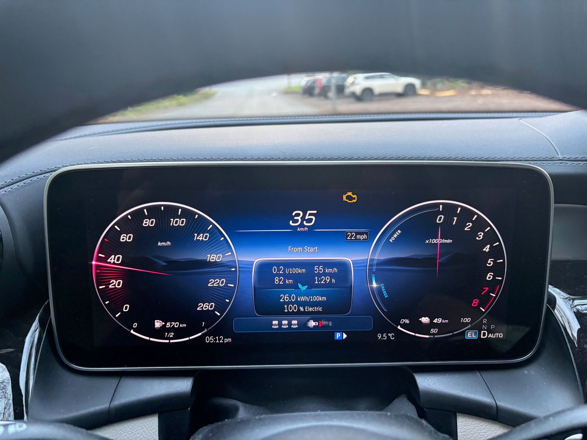

I had the first check engine light today. The odd thing is that the car was in EL mode when it happened. Trying to book an appointment to find out what the cause is.
Old Feb 28, 2026 | 01:16 PM
  #89
DESAL's Avatar
Joined: Nov 2007
Posts: 431
Likes: 64
From: Delray Beach, Fl
GLC SUV 350e4 Verde Silver Metallic
Had the same issue with engine light. If you recently got gas the 1st thing you might try is simply open and close the gas cap. The light has not returned. Had the same issue with my 2023 GLC it’s a sensor reading thing.

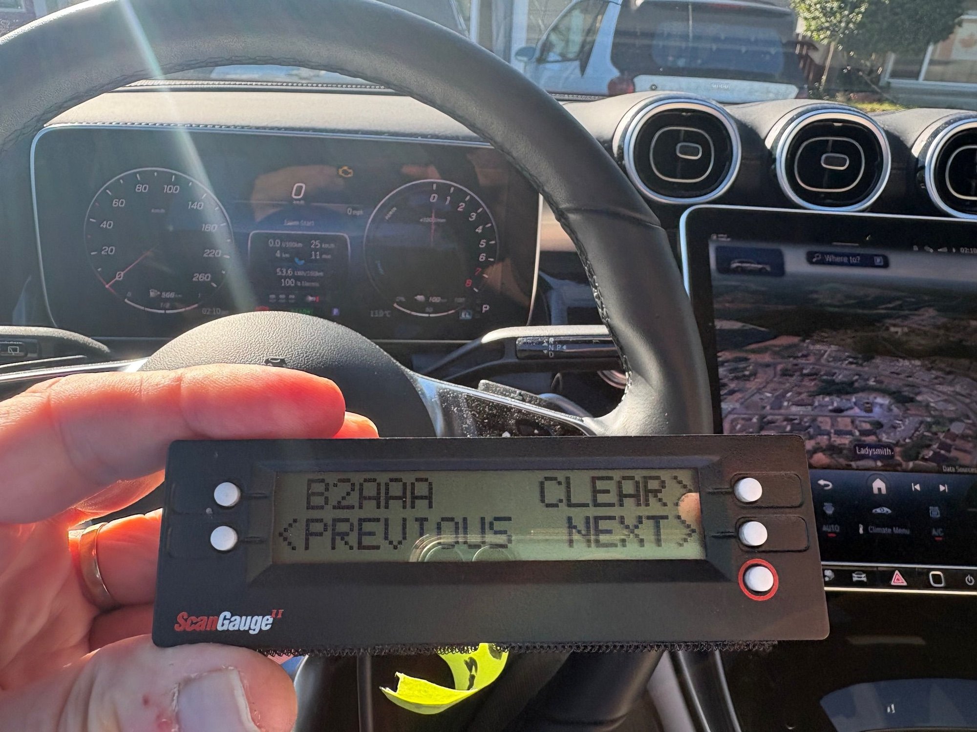

Dealer will have to decode:
Could not get a real code from the OBDII
B2AAA - the ScangaugeII could not get a real code from the OBDII
On the other hand, the CEL reset to off after five drive cycles. So it's a minor error, whatever it is. Today, after 90 km on a not full battery, we needed a touch of engine to get home and it was fine.

Update on the CEL:
The code was P2DD303 - DC charge connector unit (single fault). Cleared and loaded new software for that. I've never had a problem using DC charging, the six or so times I've done it. It does explain why the ScanGauge could not decode the CEL, and why the CEL came on when the engine was off. Clearly some electric drive system errors will show a CEL.
The service rep also noted that Attention Assist was "suspended" (good, I don't need it), but there was a code stored for that too: C112C97 - Mid-range RADAR obstructed. Sensor was clear when the car was in the shop, installed software update.
The two "low beam malfunction" warnings were not stored and I've already stated that I think those were due to driving literally straight into a bright sun up a steep hill and the sensor getting blinded.
Anyway, we will see how it goes. The Service A should be coming up in about 3 months.
