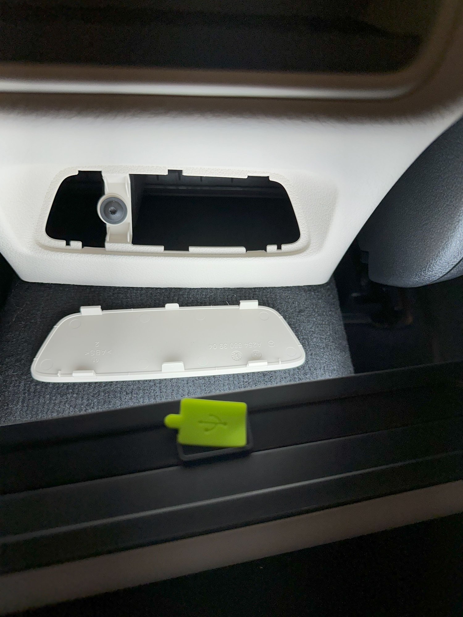

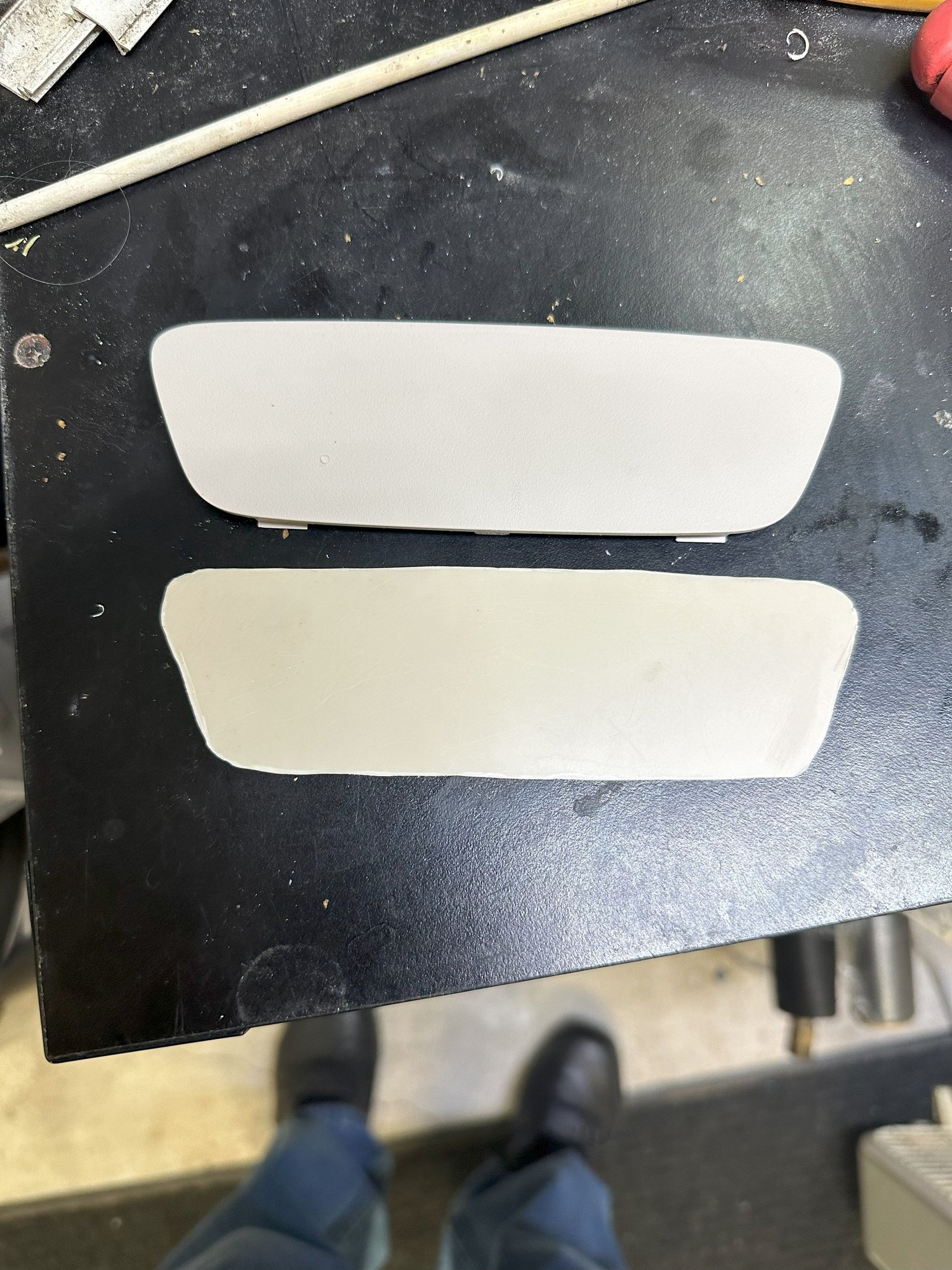

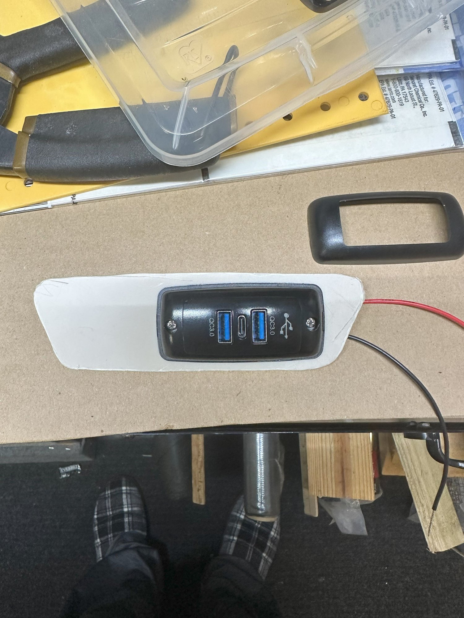

The panel where the ports should be pops out. There is no wiring behind it. You can run a USB C cable from the 12 v socket in the passenger footwell using the above adapter back to the panel area by tucking it under the edge of the console. I made a panel that would fit but without the oem clips I couldn't make a decent looking way to attach it so I gave up. I might be able to find the pics I took.

I made an error above. The USB ports I show need to be connected to a 12v source. The adapter output is 5v.
