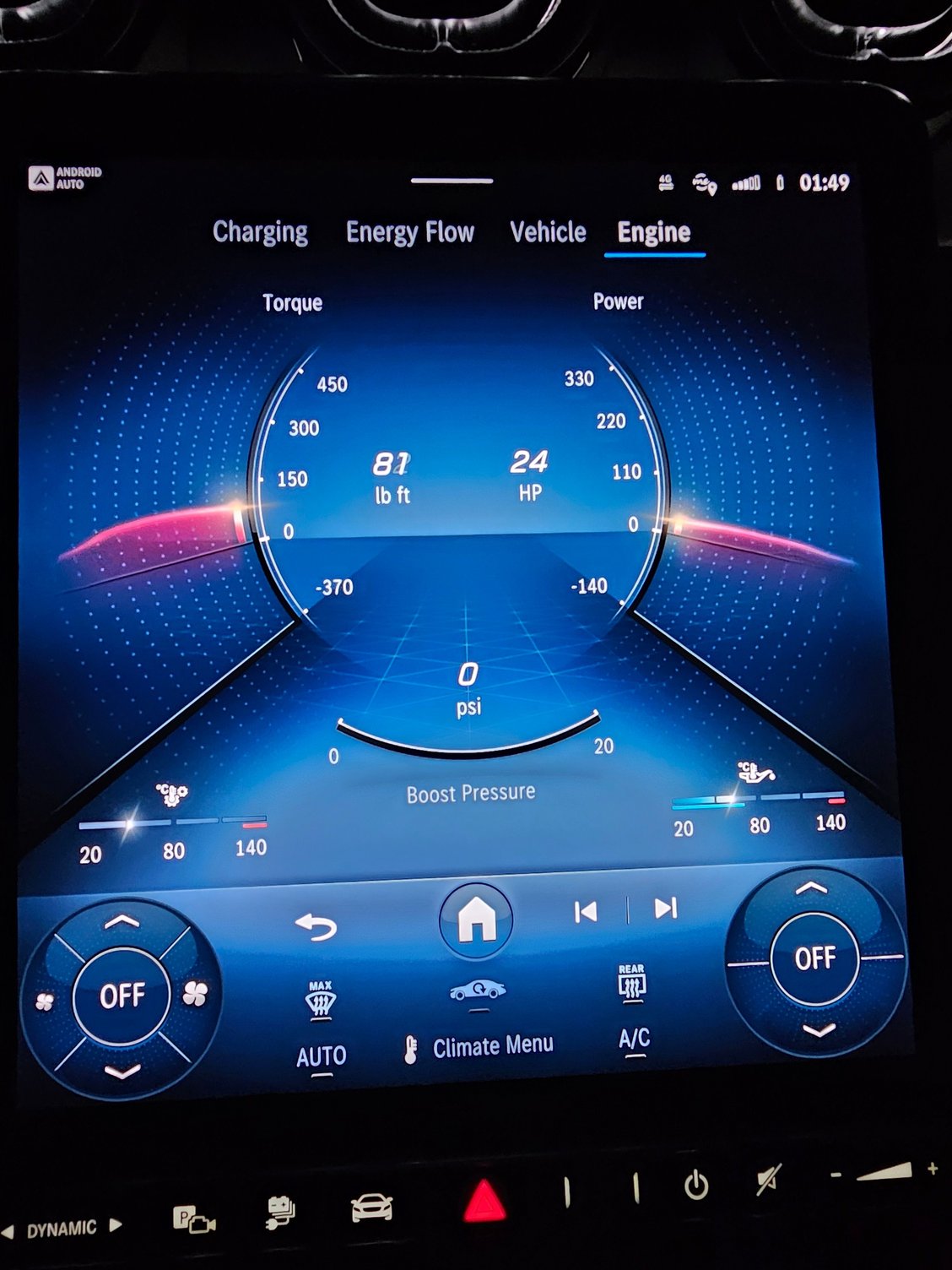

I did a quick test myself this evening. I drove the car in electric mode for about 15 minutes and took a picture of the oil temperature (first pic below). I then put the vehicle on battery hold mode and took a picture of the oil temperature after 5 minutes of driving (second pic below). As you can see, the oil temperature was low on electric mode and increased when I turned on battery hold mode. It was about 13 degrees Celsius outside when I did this test so we will have to wait and see how it is in the winter.
Electric Mode
Electric Mode
Battery Hold Mode (after 5 minutes of driving)

Perhaps I'm not reading the meters correctly but to my understanding the oil temp on Electric mode reads just above 20 degrees Celsius and ~60 degrees Celsius after being on Battery Hold mode for 5 minutes. The question is, will the oil be heated in colder weather when driving in Electric mode? Is it safe for the engine to turn on mid driving with oil temperatures below 20 degrees Celsius or would it be best to pull over when possible and let the engine and oil warm up a bit? I understand it won't be an issue when driving in Electric mode but say the battery is depleted while driving and you suddenly go into hybrid mode.

I took a couple pics on my way home from work today. My car was parked outside for about 12 hours. It was -3°C today and when I turned on my car, the coolant temperature was 11° and the oil temperature was 5°. After about 30 minutes of driving on electric mode, the coolant temperature rose to 40° and the oil temperature dropped down slightly to 4°. I had 17% battery remaining when I turned off my vehicle. So it looks like the oil is not heated while driving on electric but I'm curious if it will start warming up the oil if the battery percentage is less than 5%. I will try and go out for a drive later tonight and see if the oil temperature changes before the battery depletes.
Temperatures when I turned my vehicle on after sitting in -1 to -3°C for 11 hours
Temperatures when I turned my vehicle on after sitting in -1 to -3°C for 12 hours
Temperatures after 30 minutes of driving on electric mode

I depleted my battery and the oil temperature remained the same as it was when I turned on the vehicle. The oil only started to warm up once the ICE was running.
Question for any mechanics on this forum: is it harmful to have your engine turn on while driving with an oil temp below 5°C?
