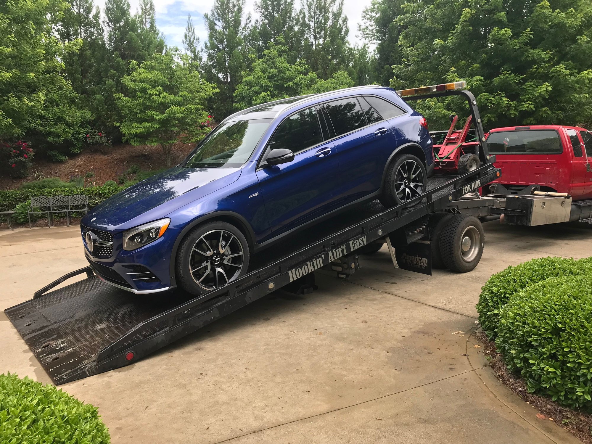

I'm sure there are other threads on this issue, but my 2 month ownership experience just hit a brick wall ... due to a nail!
Yes, there are some design things which niggle us, but the 2,600 miles since taking ownership have been fun ... and the car gets lots of compliments, especially about the color. Heading out to dinner the other night we got a tire pressure warning. Because we were only 10 miles from home I turned around and put it back in the garage. The next morning I tried to fix the issue - a pesky nail in the outer most circumferential groove of the rear tire tread - and the ownership euphoria hit rock bottom. A local, reputable tire dealer wouldn't touch it ... his equipment doesn't work on low profile tires (the rears are 285/35 ZR 21 ContiSportContact). So I called roadside assistance, who put me in touch with the nearest MB dealership. I offered to drive the car there (50 miles away), on the basis that I have run-flats, but the dealership pointed out these are not run-flats! The dealer we purchased it from, near our primary residence over 300 miles away, assured me they were run-flats ... but who gets down to find whether they have an MO or MOE designation on the side of the tire? There is nothing in the trunk ... no spare, no jack, no wrench, not even a can of goop ... this is weight saving gone crazy! I started the process before 9:00 am, the recovery truck finally arrived at 4:00 pm ... it's a good job we weren't stuck on the side of the road on a dark, wet, cold night. I'm currently waiting to hear whether the dealership can repair it, or whether it needs a new tire - we do have the wheel and tire warranty - it will take a couple of days for them to locate a new tire. Then I need arrange a lift for the 50 miles to pick it up!
When I ordered it I knew the vehicle didn't come with a spare, it was one of those trade offs I accepted, confident that the run-flats would be OK to get me home for 95% of my trips. But the fact that I don't even have that fall-back, together with a terrible response time from roadside assistance (they sent the truck to an address 60 miles away!), leaves me concerned about the safety and security of my family whenever we're out in this vehicle.

Back on the road again, with a repaired tire. Plus the TireFit kit has been found!
No, it wasn't a spec vehicle on the lot, we did a custom order for the car, fully loaded including the 21 inch wheels (we tried to replicate the exact options on a coupe version we test drove at the dealer ... and loved, but needed more rear space for our dogs!). After a 3+ month wait the car only arrived at the dealer 48 hours before we took delivery, so I don't think any items had been swapped around before we took delivery. While the vehicle was having the tire repaired at another dealer we searched (again!) for the sealant and compressor. Armed with the input from this exchange, help from the local dealer, and the manual, we were able to find the compartment under the floor. Wow! We had been shown the (empty) slots in the open area under the floor and were told that was where the jack, compressor, etc were stowed, if the car was so equipped. I had even lifted that tray to see if anything was under it, plus I am sure I had seen the tow eye before, but maybe that was in another vehicle we looked at. Now the manual makes perfect sense ... although I'm still searching for the reflective vests in the door bottoms. Our take-aways from this experience are 1) our salesman didn't understand/know about run-flat capability when you move to a 21 inch wheel, and 2) no-one understands TireFit, starting with the statement in the build configurator and including 2 dealerships. Even the MB Customer Assistance number gave me the runaround ... they confirmed it was in the build, but then the virtual arm waving started, claiming it was so the information display could recognize the 21 inch wheels (pure BS).
Now I'm a little more confident about the car. While I don't have run-flats I do have sealant, which should handle the simple flats ... small objects penetrating the tread area. (I've had multiple BMWs, mainly Ms, both with and without run-flats. I concur the handling is compromised, but I've also punctured two run-flat tires hitting an Interstate pothole on a dark, wet night - which split the sidewalls - but I was able to limp a few miles to somewhere safe and dry.) I am still considering how I might get additional levels of security. The sales pitch for the ContiSeal technology appeals to my aerospace engineering brain ... I might just weaken and replace all 4 to get that feature. The only other option would be to find a space saver spare (from Europe?) which could fit under the rear floor and also clear the AMG calipers on the front wheels.
