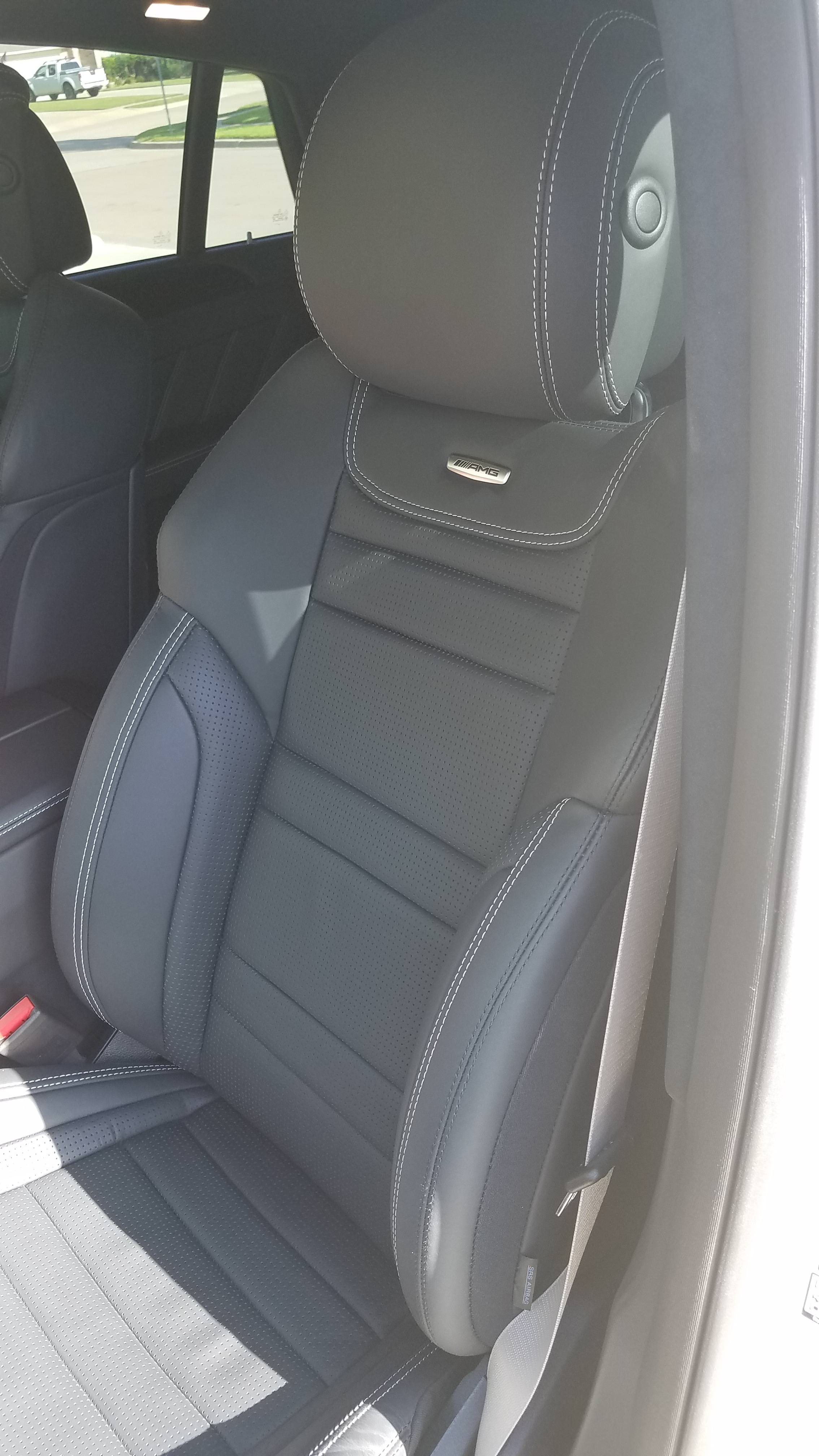

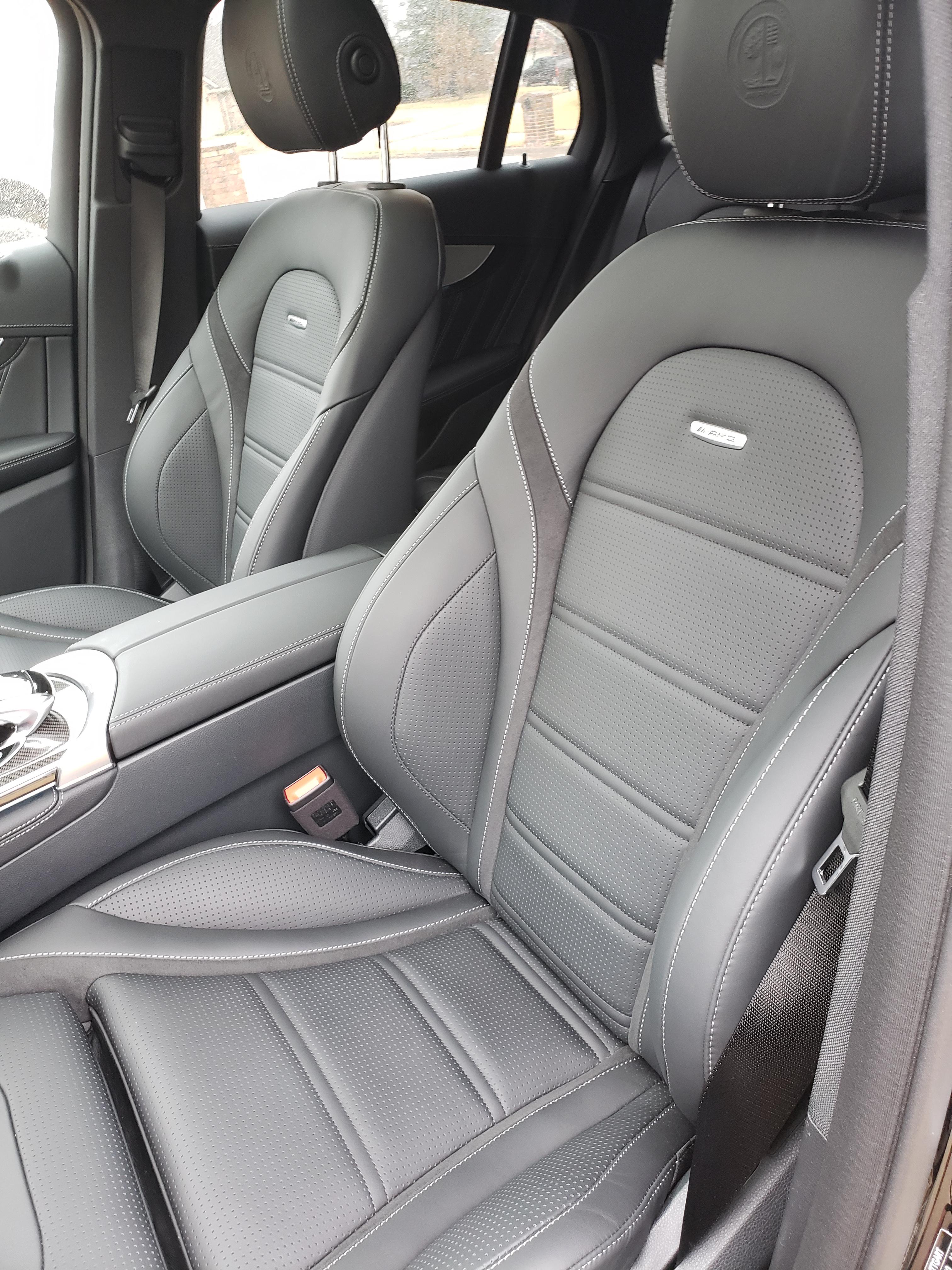

Funny, I went from an AMG to a BMW and sold the BMW after 6 months because the seats were killing me and I wanted to get back into the comfortable AMG seats.
Maybe the 43 doesn't have the same seats as the 63? It is a different vehicle.
The seats in my GLE 63s were the best seats I have ever had. The ones in my GLC 63s are good but not as good as the GLE.
GLE:
Attachment 440053
GLC:
Attachment 440054

My 43 has the same leather seats as your 63, just doesn't have the AMG logo on the backrest and headrest. Looks to be the same otherwise. MB-Tex is an option for the 43 though, if not upgraded to leather.
