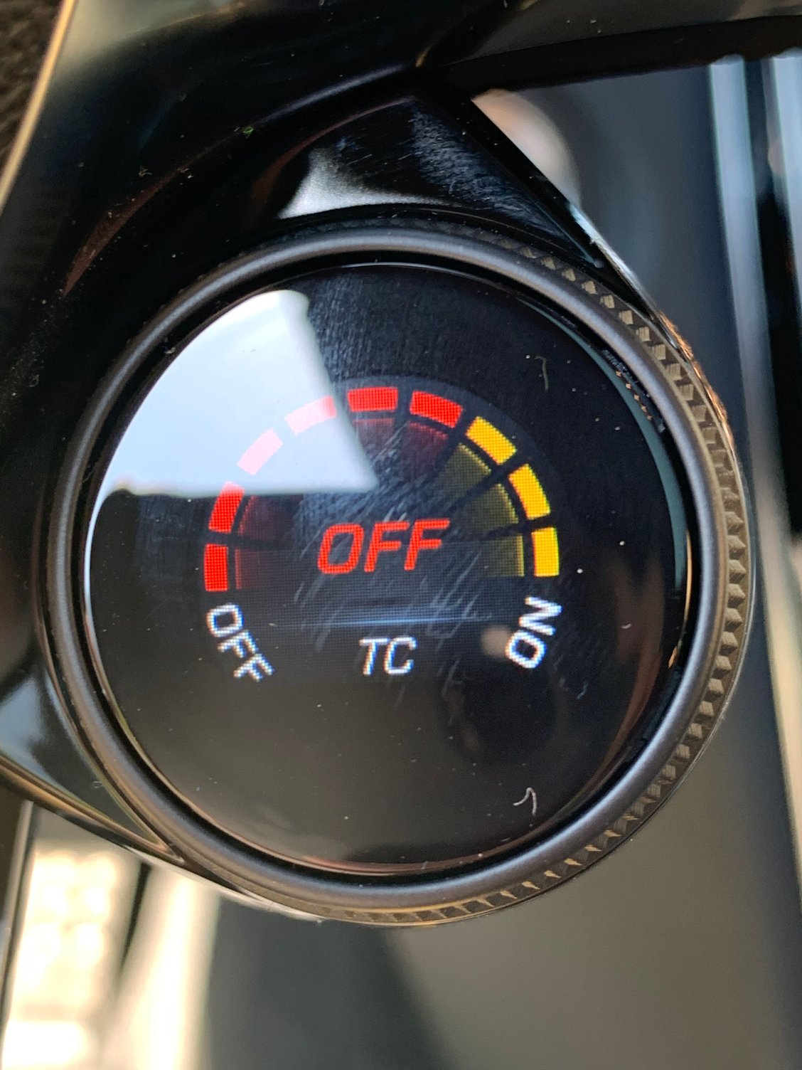

Just wanted to add a couple things.
GTR does not have a nine speed transmission.
the ability to control traction is only through the nine stage dial that is standard on the GTR and is becoming more available on other s models. Otherwise there’s no way to directly adjust traction control. ESP, while has a traction control component is a multi module stability monitoring system that is given three general stages in most AMGs and for each model it is tuned differently to prevent the average driver from getting in trouble. As mentioned it is not possible to completely disable it. It doesn’t surprise me that it is more intrusive in the GLC than say in a C63s.
Correct, but I don't think we mentioned the transmission anywhere. Traction control has nothing to do with the transmission. The GT R, GT R Pro and the 2019+ C63S are the only models currently with the 9-stage traction control. The upcoming GT Black Series will most likely get it, too. I'm not aware of any other models and with future AMGs going AWD, I doubt it will be found on any future models. It really only makes sense for RWD models. 4Matic+ manages traction by appropriating torque between the front and rear axles mostly and the E63/GT63 drift mode only becomes available if ESP (and therefore TC in those models) is completely turned off. In the SUVs the 4Matic+ system can't be turned off, which means even if you get it to drift, power will get sent to the front wheels to pull the car straight. The E63/GT63 do allow some drifting even with 4Matic+ on, before it sends more power to the front to straighten the car.
Indeed ESP in AMGs is a three stage system and it should be clarified that in order to manually adjust traction control in the above mentioned models, ESP first needs to be turned off (Stage 3) and only then can one select one of the 9 TC levels. However, the computer selects an appropriate relaxed TC level in ESP Sport Handling mode, allowing more tire slip than with ESP fully on, and the new AMG DYNAMICS system which is standard in the 2019+ C63S and the FL GT models also affects the TC level. The GT R has a dedicated yellow knob to adjust the traction control (still requires ESP to be fully off), whereas in the C63S the drive selector knob on the steering wheel changes in order to adjust TC once ESP is fully turned off.
Basically ESP off turns off what's known as yaw control. Meaning if you spin out, it won't save you. On many models turning ESP off, also turns off or relaxes TC, but TC is really a separate and somewhat standalone function. The unique thing about the GT R derivatives and the FL C63S is that it doesn't fully turn off TC if one turns of ESP. It sets it to level 5, so halfway, and then the driver can adjust it up or down from there.
