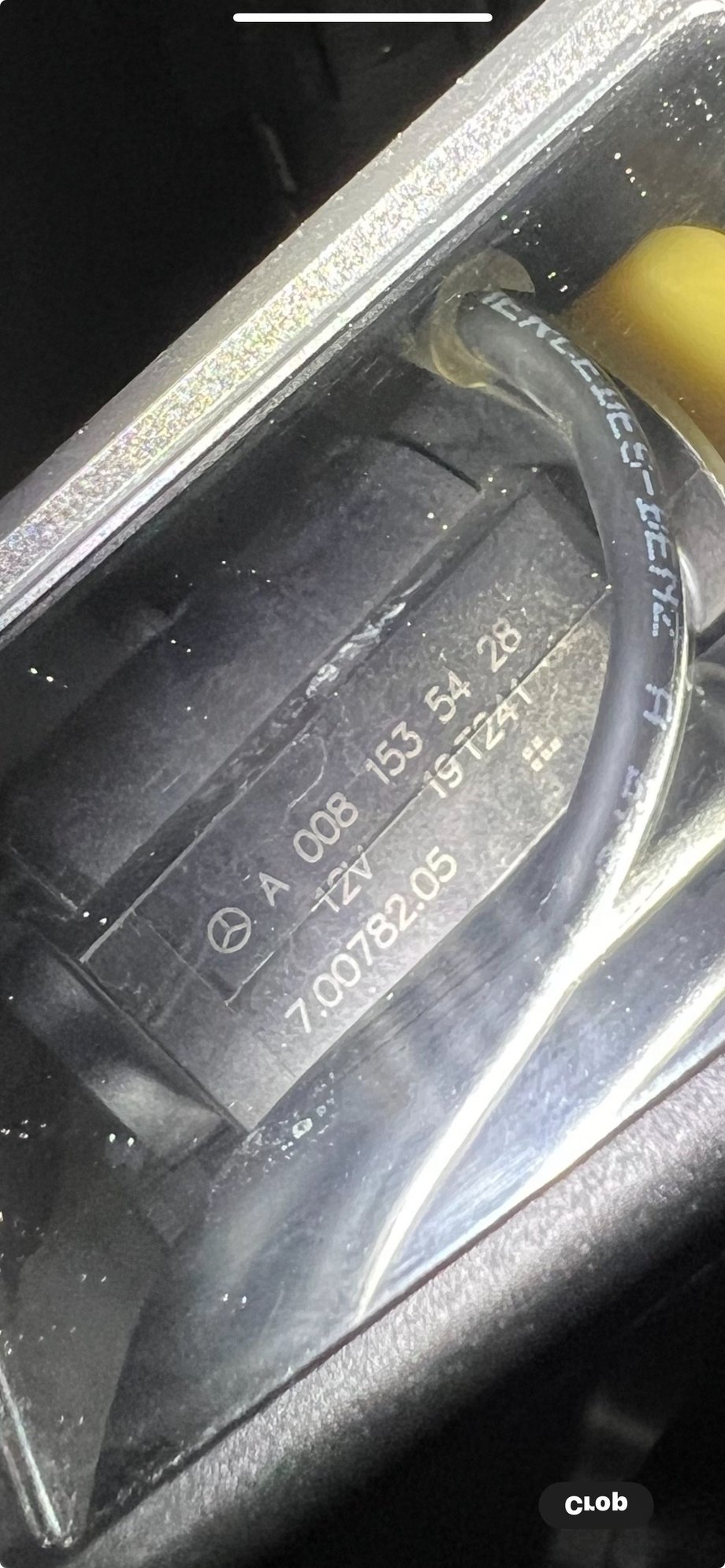

Thanks for your input. I tried it the other day and i pinpointed the noise to what looks like a solenoid valve in front of the engine. Part # is A0081535428. Taking back to dealer on monday. If replace this, hopefully noise will go away.

I own a 2017 GLC43 and I had the exact same vibration/noise....but i had one more symptom that led me to exactly what it was......
with this vibration/noise my radiator overflow tank was spilling out anti-freeze. this issue was this little tank cap which is releasing i addressed it to the dealer and they fixed it. I am not sure what the changed or actually done to fix it, but my guess is the tank cap was replaced.

I had the same problem on my 2018 43, the mechanic at MB Northshore said it was a valve that keeps the water to air intercooler system pressurised. Replaced under warranty a month ago. Pretty embarrassing when your 43 farts its way around the carpark

I have the same exact noise coming from that same vacuum solenoid valve. I have attached a video and a picture of the part number of the offending item. I have an appointment with the dealer and will update here with results. Perhaps not so coincidentally; I can smell coolant but can't find a leak. Maybe the cap as mentioned. And maybe if the cap is not holding pressure it cause this val to activate constantly in a failed attempt to maintain proper pressure? Just a guess that may make sense if the noise is "normal" when activated occasionally if the system is properly sealed. I may be way off but I will update wafter my visit to the dealer. Thanks for all of the information.
