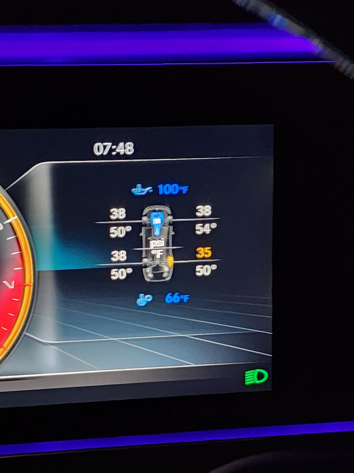

Old Jan 7, 2024 | 11:24 PM
BlueTecChaser's Avatar
Joined: Jan 2024
2020 E63S
Potential cause of race start not working
Hello guys, I was searching another topic but came across this and hope I can help.
In order for the launch control to activate youll need to make sure both the engine temp and transmission temp is up.
Both Temps are displayed in the TPMS manu. When it's cold both temperature will be blue, once they turn white you're good to go. This should solve your problem.
The trans temp always need more time to warm up.
