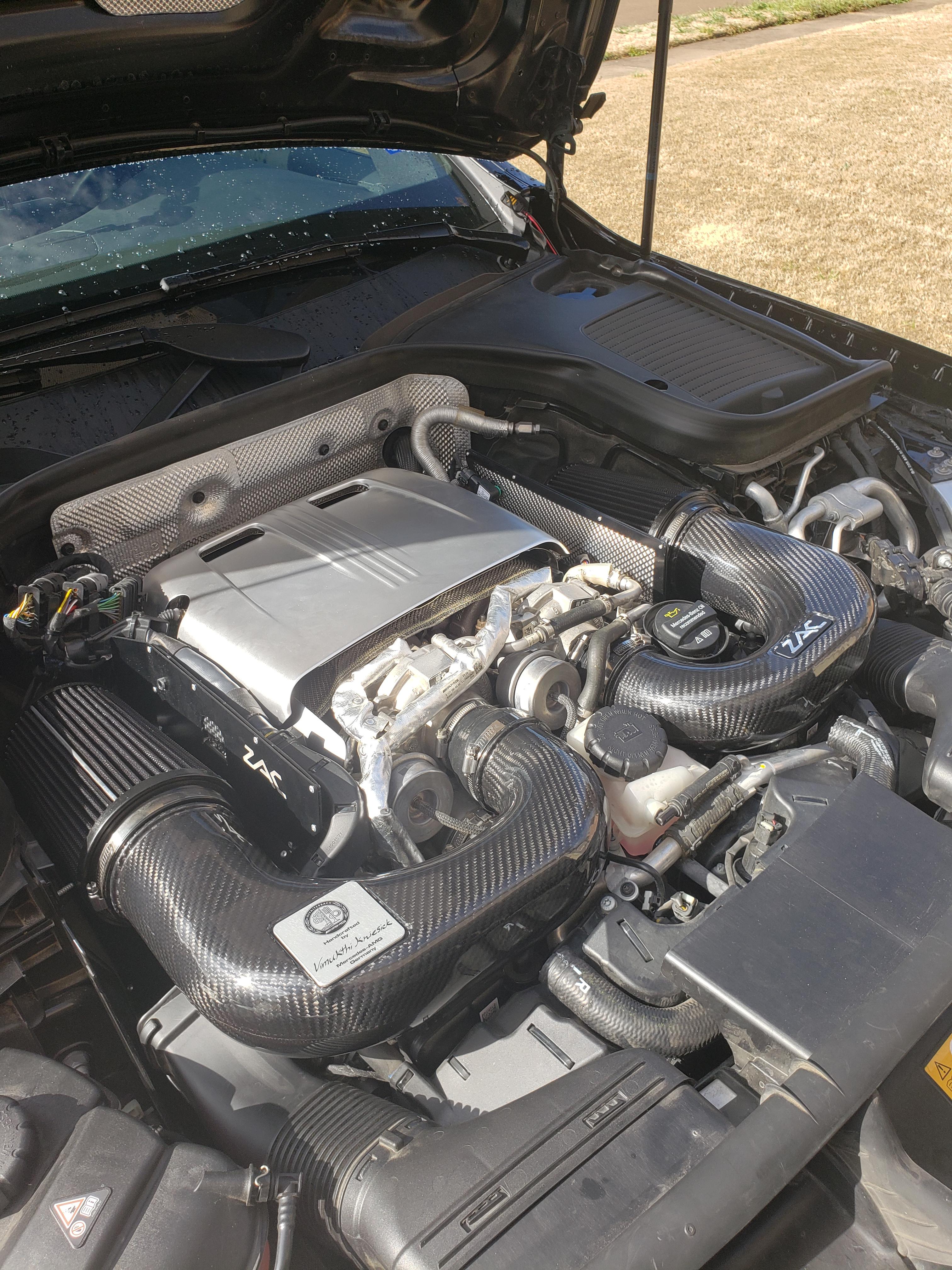

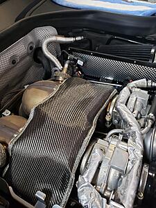

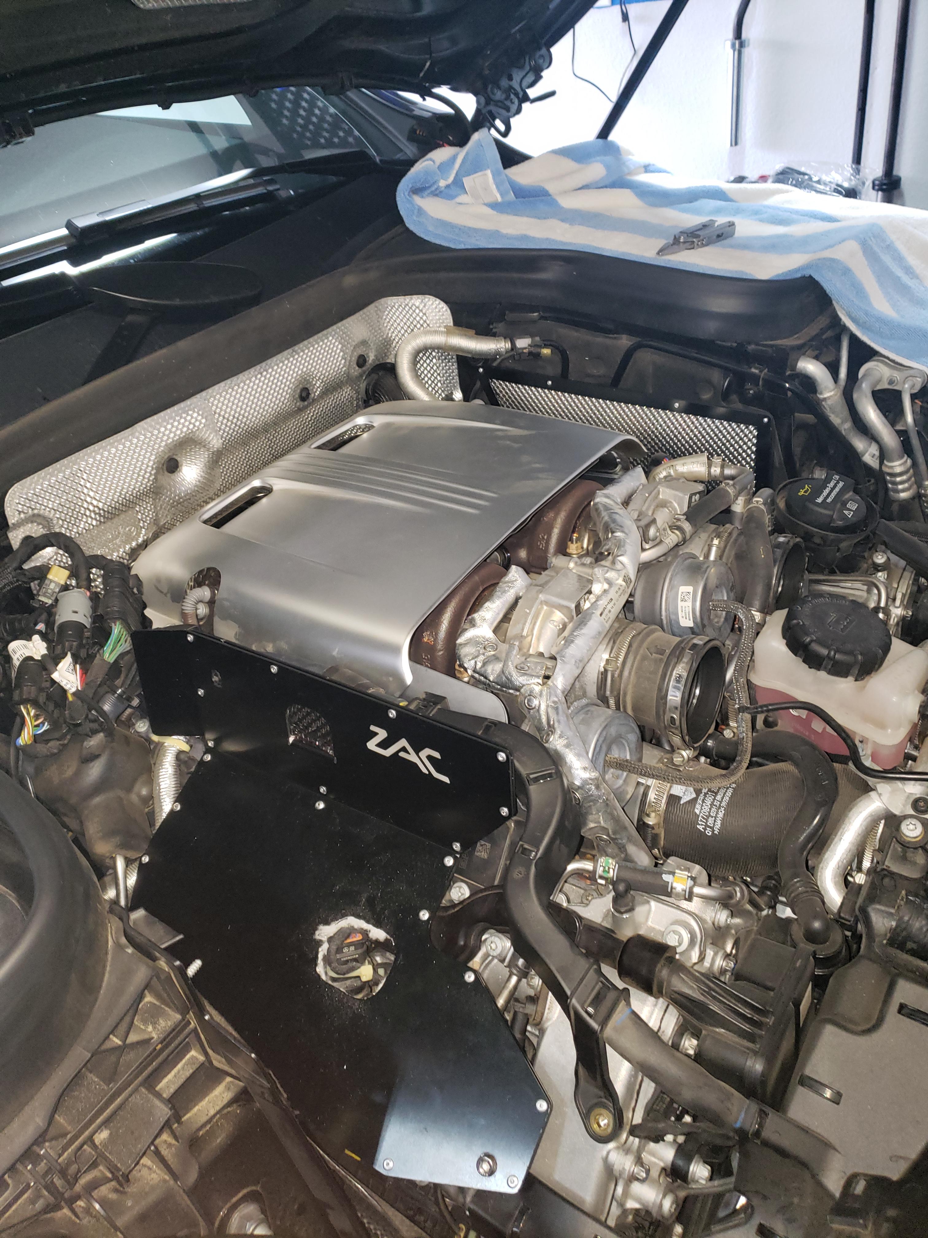

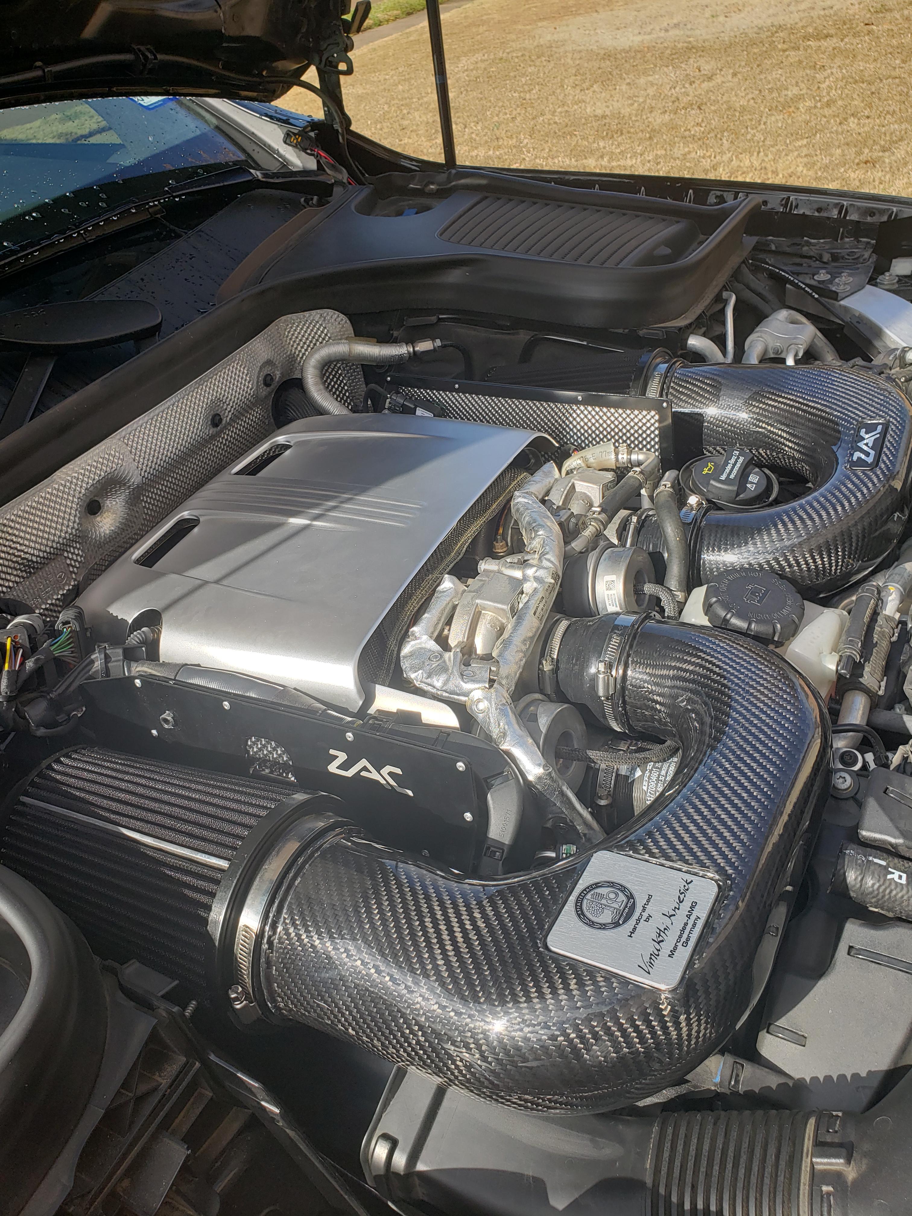

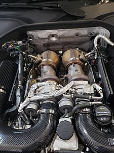

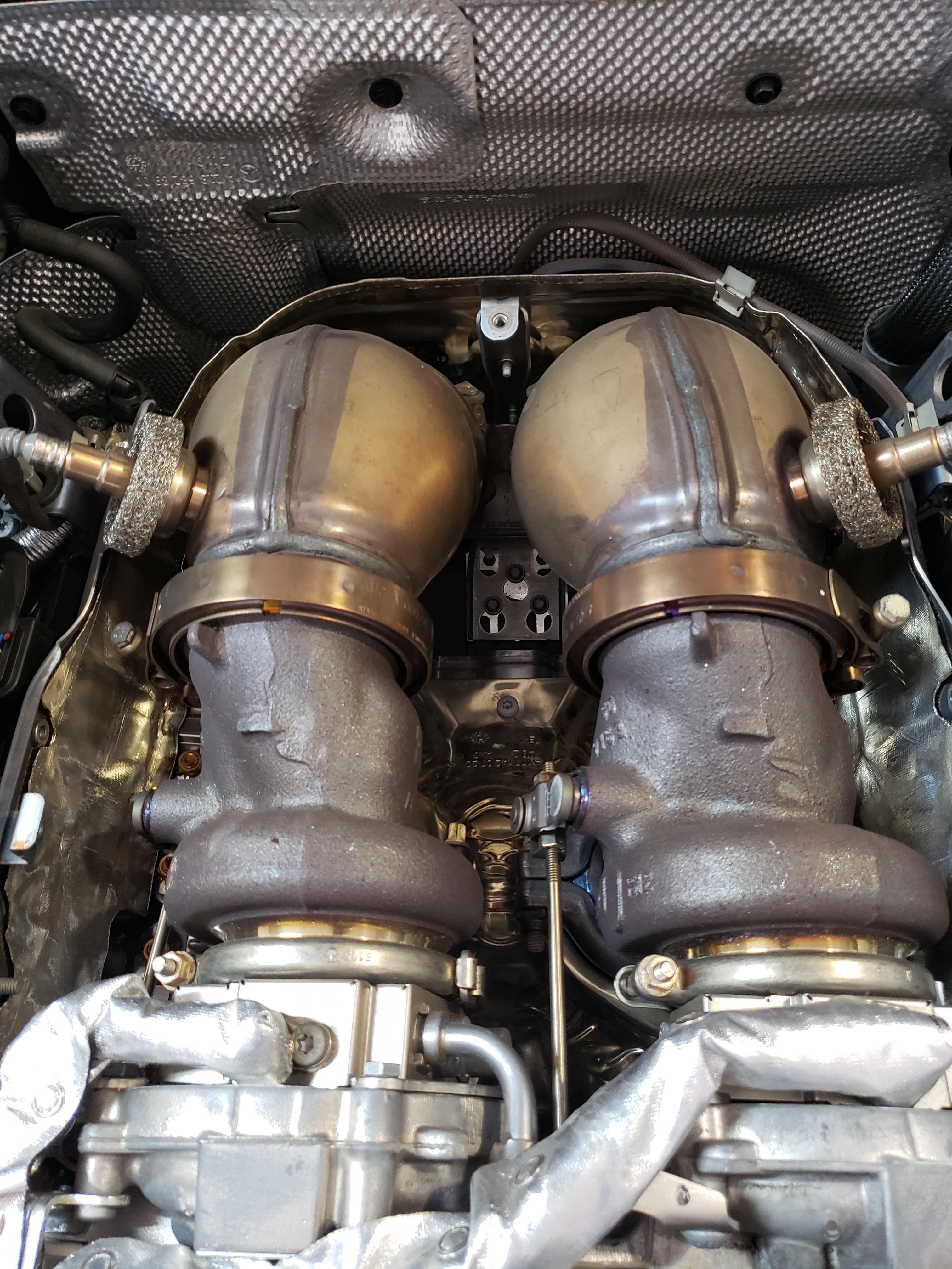

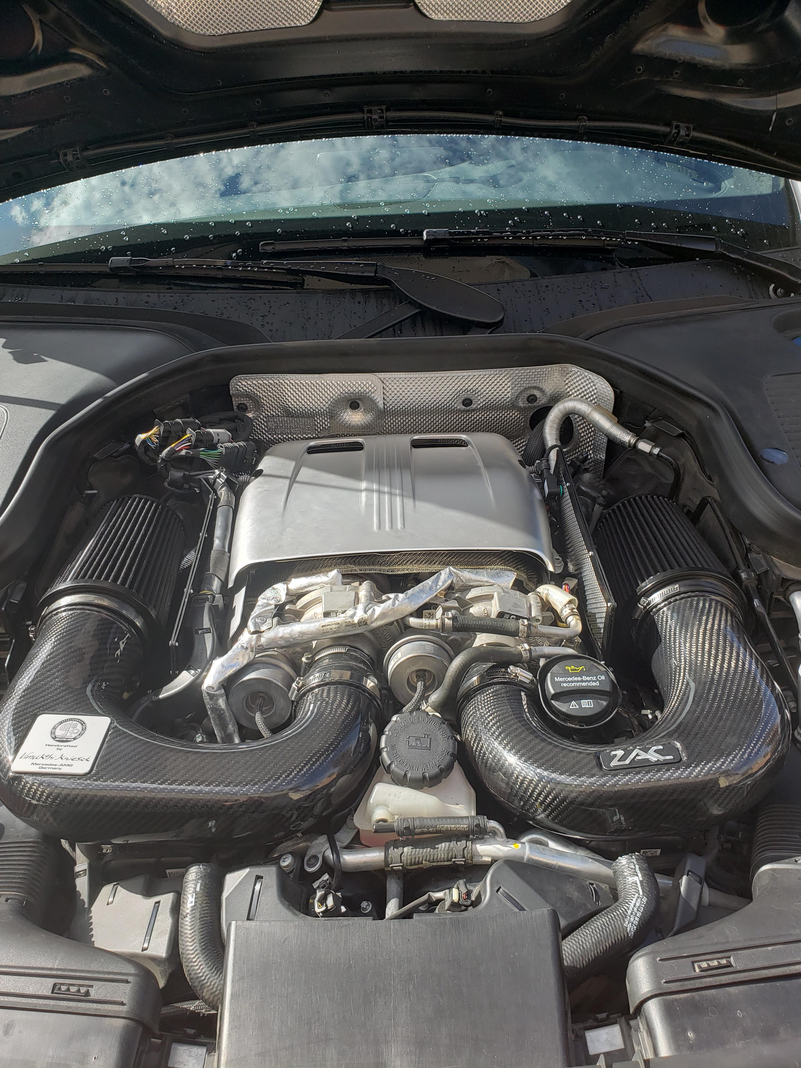

Finally received my intake from ZAC to go along with my Eurocharged Stage 2 tune.
I am kind of "on the fence" in relationship to whether an open system is any better than a closed system as you definitely are drawing in more heat in an open system. Maybe the increased airflow offsets this? Some studies show they do.
All that aside...I wanted the sound and looks of an aftermarket intake. I really like the looks of the ZAC intake and heatshields. I also figured the turbo blanket would be a good idea.
I am a far cry from a mechanic but this was a pretty straight forward install. The heatshields were the most difficult part. It took me about 4 hours to install but an hour of that was cutting out the aluminum mesh, in the heatshield, for fuel rail clearance and the air filter sensors, without the proper tool. It is actually a weird design as it could have just come from ZAC already cut out.
Me being weird, I uninstalled everything yesterday just to see how long it should really take and I even took off both of the heatshields, that cover the turbos, so I could properly install the turbo blanket and it took about an hour to install everything on my second go around.

It was simple to get the engine builder plaque off. I hit it for 3 minutes with a blow-dryer and it popped right off and was still hot and sticky enough to transfer it directly over the the ZAC.
I don't think the air filter quality sensors are a big deal. ZAC said you can tie them up or put them in the heatshield slots which are built to inset and 1/4 twist like the factory box. I installed them just because it is cleaner looking.
