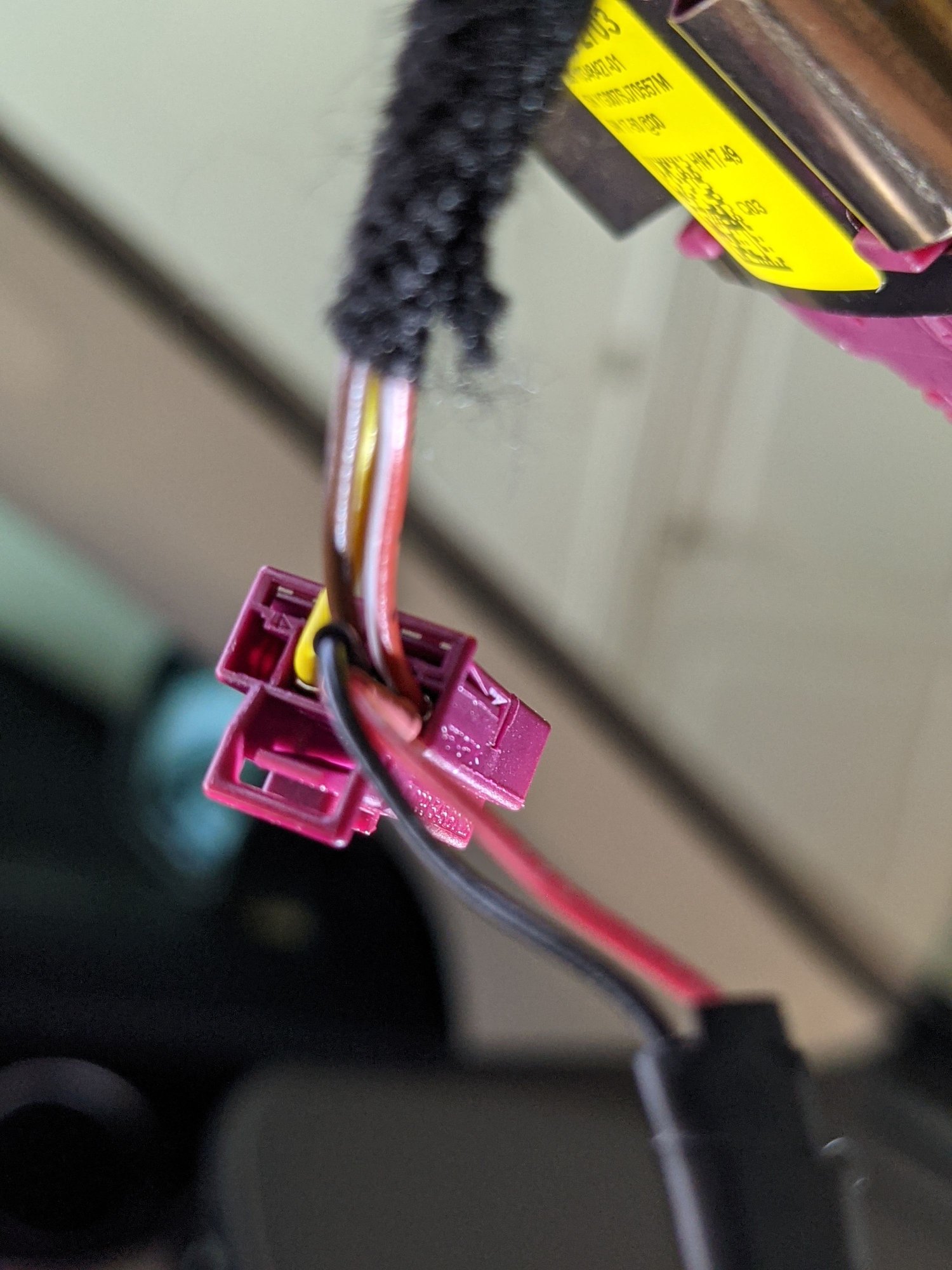

mine would not shut off after 30 minutes. I even locked the doors and checked back later and Uniden R3 would be still on. Do you happen to remember what wires you had under the mirror?
I only had one socket there with 4 slots. One slot was not used, one ground (brown wire), and one yellow (i think wipers/rain sensor) and one red/white for mirror.
here is a pic of mine
That does not look familiar. I recall 6 or 8 wire socket; brown and green were my taps for switched 12 volts.
