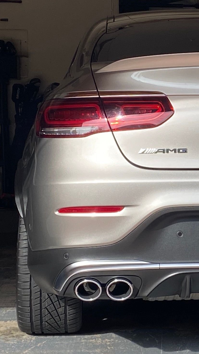

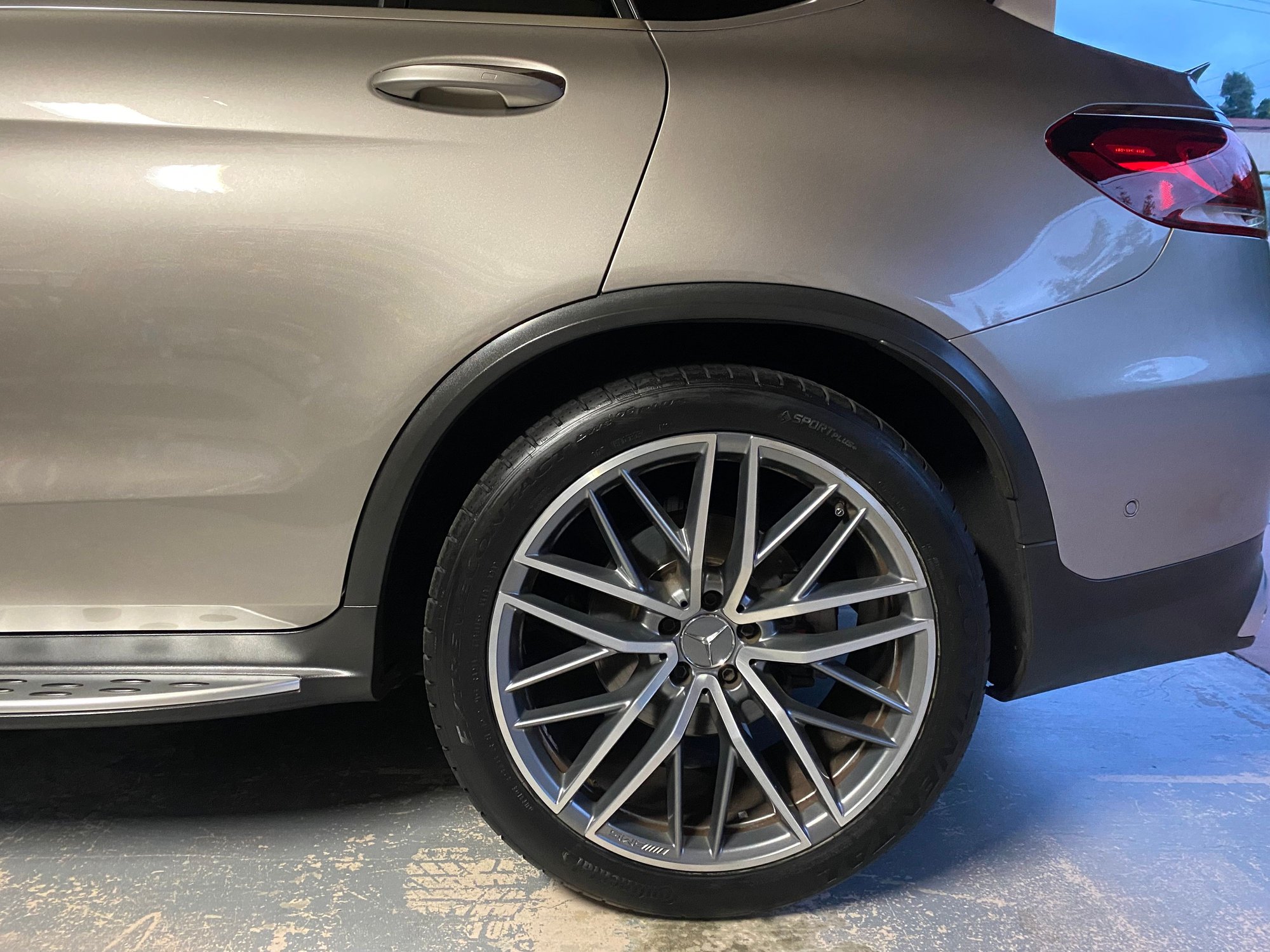

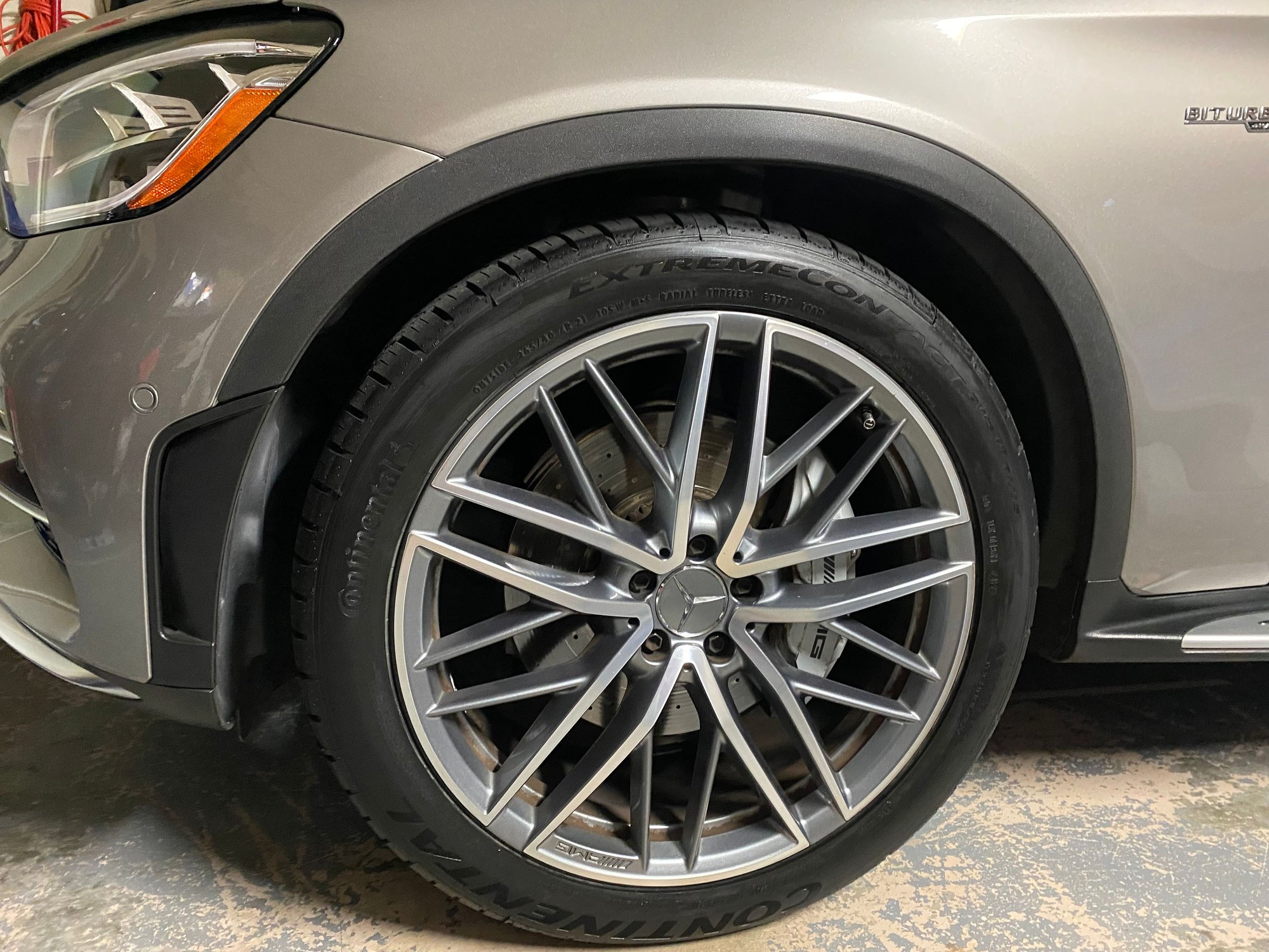

Apr 29, 2026 | 11:08 PM

Apr 30, 2026 | 02:43 AM
Photos
Photos attached.
Photos attached.
Reply 1
Apr 30, 2026 | 05:32 PM
Beautiful, thank you.

Apr 30, 2026 | 07:40 PM
You’re Very Welcome
Nice! You’ll be happy with the 265 front and 295 rear sizes. I’ve experienced no rubbing on mine even in the lowered Sport+mode.
