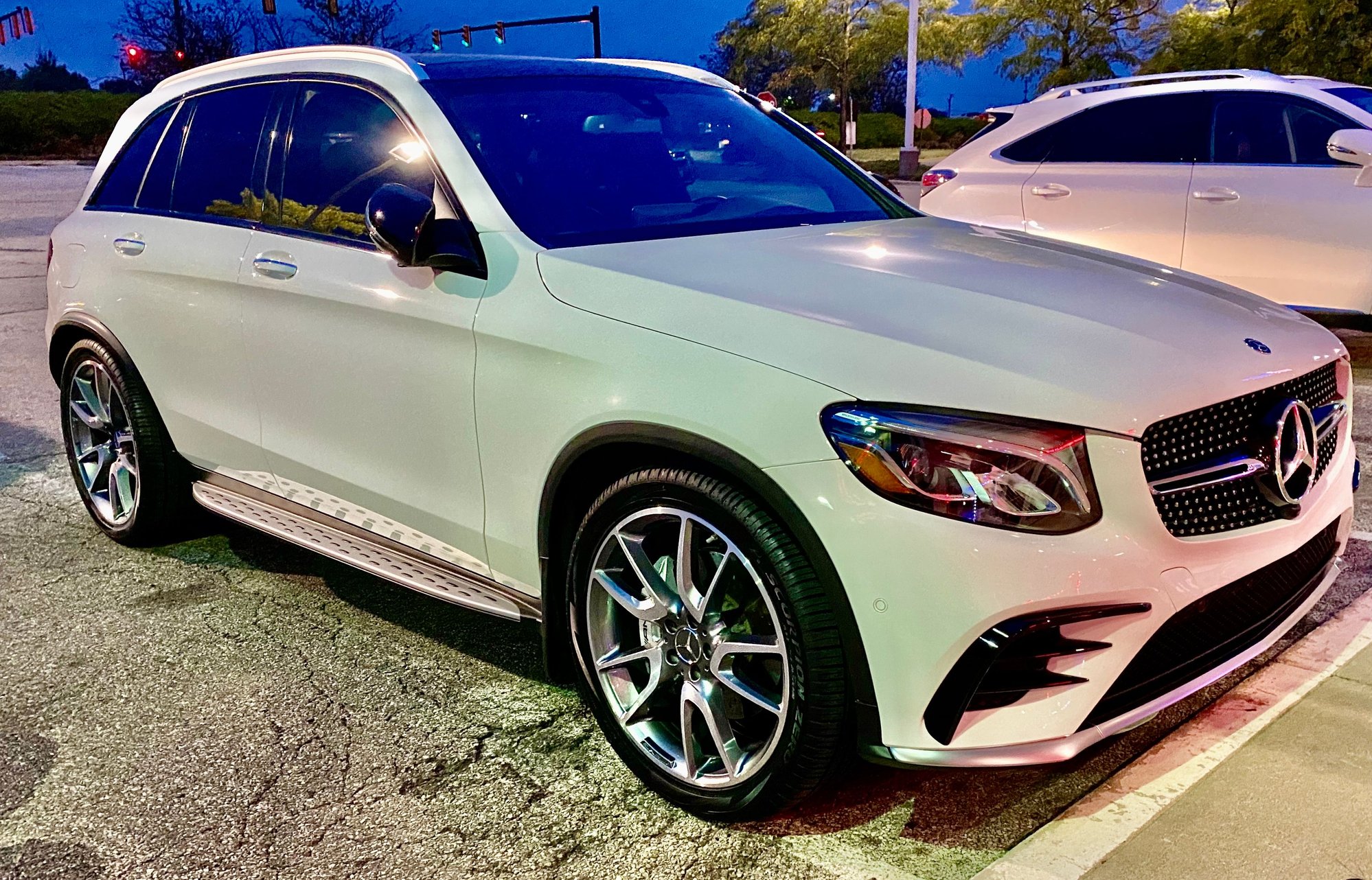

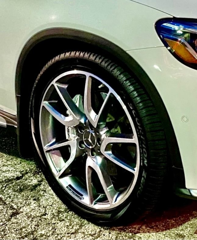

~ I actually had to bump up to the GLC63 tire sizes to find an all-season tire.
I see you have the 20” rims (not sure what’s available in that rim size)?
I went with the Pirelli Scorpion Zero (265/40/21 & 295/35/21). The look great and ride smooth as glass. I’ve had them on the my 43 for 7,000 miles. Love them.
See a few photos below.
