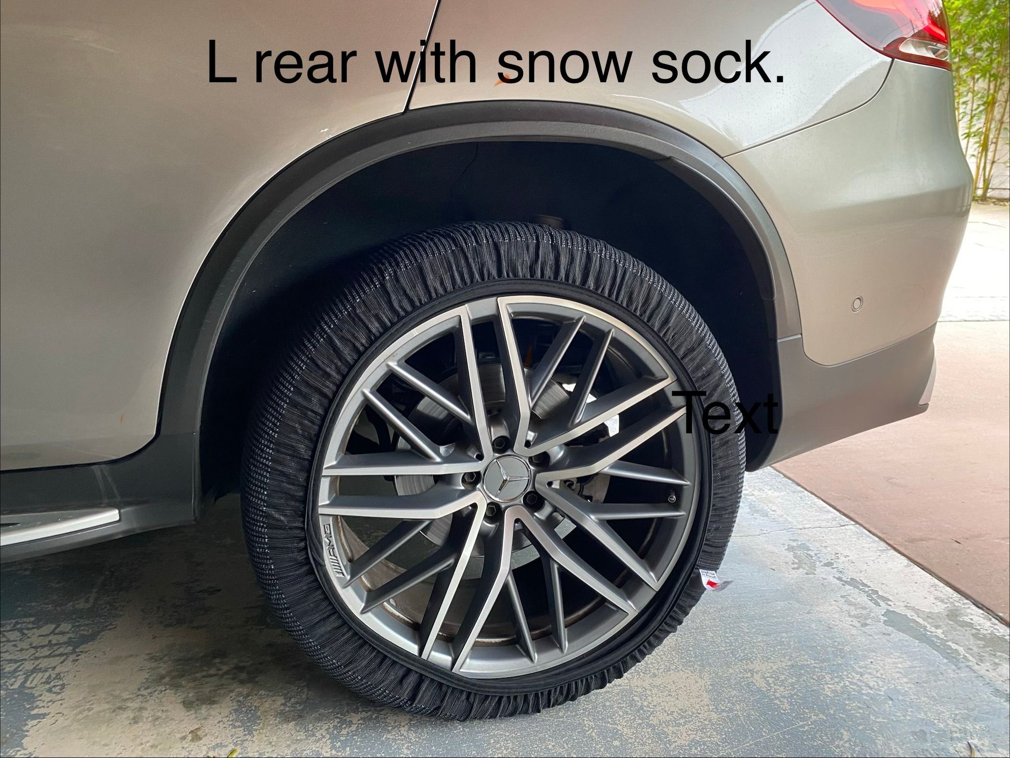

Snow Socks Fitment - Front or Rear?
I have a question for snow drivers. When chains / snow traction devices are required in ski resort areas like Mammoth Mountain this winter (even with All Season or snow tires), I would welcome feedback on which axle they should be installed. Searching online, I see folks saying to install them on the rear tires. The MBZ service tech said to put them on the front tires if there is sufficient clearance around the tire.

Photos of 2020 GLC 43 Coupe with Snow Socks
I have two pairs of Matte Auto Extra-Pro snow socks. There is clearance on both front & rear DWS06 Plus AS tires when the snow socks are installed.

For the AMG, I would think that the rear wheels would work best with traction devices given that AMGs have a different power split front to rear than the regular vehicles. I know on my 2018 GLC43, it's a 40/60 split for power front to rear...so for my vehicle, I would have the traction device on the rear wheels. YMMV depending on your power split ratio.

Thanks. My 2020 has a 69% rear, 31% front torque ratio.
