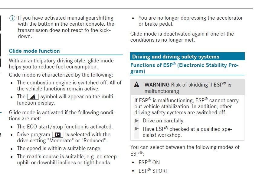

Not that I care for auto start/stop. I always turn it off in my C63, but this doesn't sound right. Auto start/stop is controlled via the button and the Drive setting. It's active if the Drive setting is set to Moderate or Reduced. In fact you have to use Individual mode with Moderate or Reduced in order for the Glide mode to be active as described in the AMG supplemental owner's manual.

On second thought, I just read the ECO start/stop section in the AMG Supplemental owner's manual and it appears ECO start/stop only works in drive program C on AMGs and I was right about the transmission being in M. At least that's what it says for my C63. I just checked the 2020 GLC AMG owner's manual and it doesn't say anything about that it only works in C, but maybe that's just an accidental omission.
