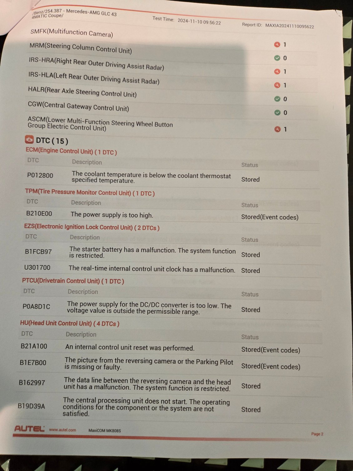

I just drove my 2024 GLC 43 AMG out of the lot with 60 miles on it which was strange for a new car to have that much mileage and today we go the check engine light. I am so upset for not researching all the problems before the purchase. I have never owned MB, had 5 BMWs and I figured try MB. I never imagined they are building lemon cars, and now I want to return the car after all the problems I read all over internet. Hoping the dealer will make a trade but based on my reviews the MB reliability is very low according to Top speed the 2024 GLC reliability is 17/100 ouch 74k for junk AMG or not.
Wished I would have done my research, what an expensive lesson to learn.

Check engine light is usually emission related, even a loose gas cap can trigger it, it could also be a bad oxygen sensor. If it is flashing then it is immediate attention, if it is just solid then it is usually not a big concern. Do keep us posted what was the cause of the check engine light after the dealership scanned the codes. Hopefully it is just a minor thing so you can enjoy the vehicle again. There are so many computers in modern MBs and so many variables.
So the sales manager and sales rep both reached out with apologies for my experience and assured me they will make this right, cause I told them that they sold me a 🍋, I bought a Autel MK808S (great scanner) and I can up with 25 faults below, suppose to have the car picked-up at my house tomorrow and bring a loaner, this way I can compare with what they repaired if any when I got the car back. 🤞🤞🤞🤞

https://cimg2.ibsrv.net/gimg/www.mbw...ec5485827f.jpg
https://cimg3.ibsrv.net/gimg/www.mbw...12a067fdb5.jpg
https://cimg4.ibsrv.net/gimg/www.mbw...478f2848d8.jpg
When there are multiple electrical faults on a Mercedes. It usually indicates it is a power/voltage issue. This happens when the battery is aging but in your case given the age of the vehicle, it could be a faulty battery. Mercedes' electronics are very sensitive and the voltage has to be very stable. That is usually from what I see, I am not saying that is exactly the issue you have but certainly a possibility.
Thank you, I shall find out soon, I really like the SUV, never owned a MB so I hope this was a good purchase. Will update with final results
